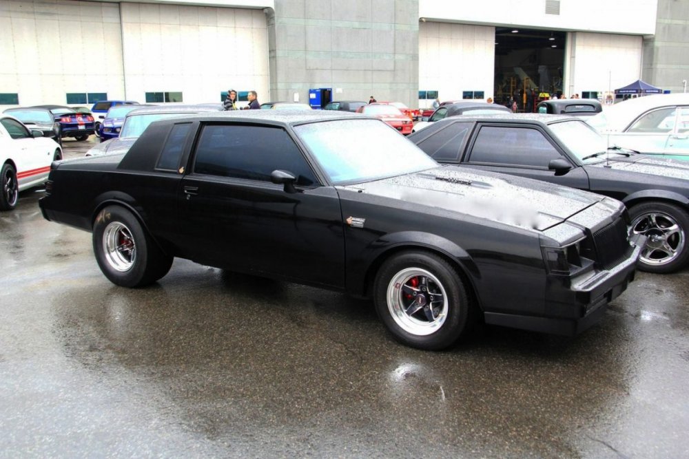

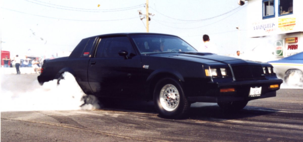

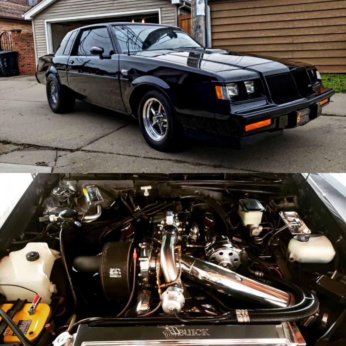

23 hours ago, 2FAST4U said:
I have the original 20" wheels /tire combo on my car for the winter time but I've upgraded to 22" for the summertime but all are 4 tires are the same size. I guess you can mix tire sizes but in the end what matters is that they all have the same outside diameter.
Claude.
Exactly. On a side note you Buick runs almost a identical time to my 87 GN lol
