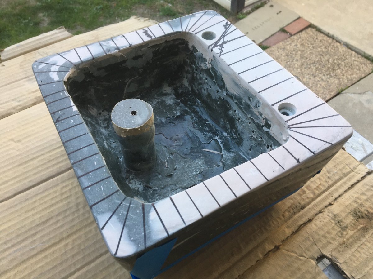

Xtra Report post Posted February 9, 2022 (edited) The underside, The reason it is hollow on the bottom is to create a manifold or plenum chamber. All the vacuum holes I drilled on top pass through the mold and go into this open area where the vacuum is applied. I was able to locate the original mounting T-nuts that were covered by the rebuild. This saved a bunch of time, but now I need to buy some longer mounting bolts as the threads are cast deep into the mold. Edited February 9, 2022 by Xtra 1 1 Share this post Link to post Share on other sites

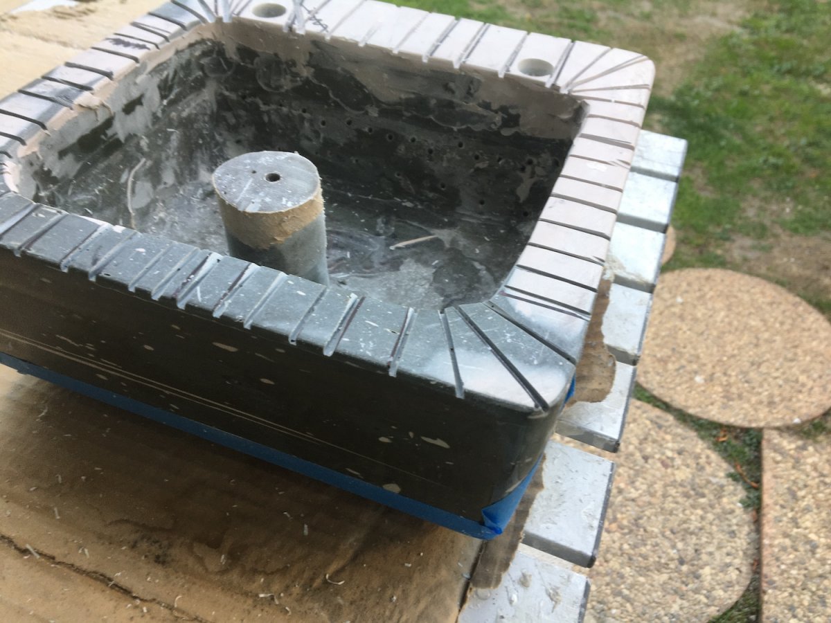

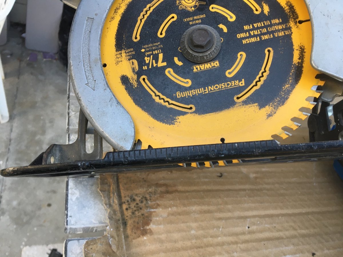

Xtra Report post Posted February 10, 2022 (edited) Finished ready to mount... I still need longer bolts, but the fabrication is done. First I laid out the cut lines with a felt tip marker. Then adjusted the saw cut depth. I needs to be a shallow cut so the ABS will not pull into the slots. All the slots are cut and it is ready to mount to the wood base. These vacuum slots pull the ABS into the bottom edge and hopefully create nice flat sides on the Adaptor. Edited February 10, 2022 by Xtra Share this post Link to post Share on other sites

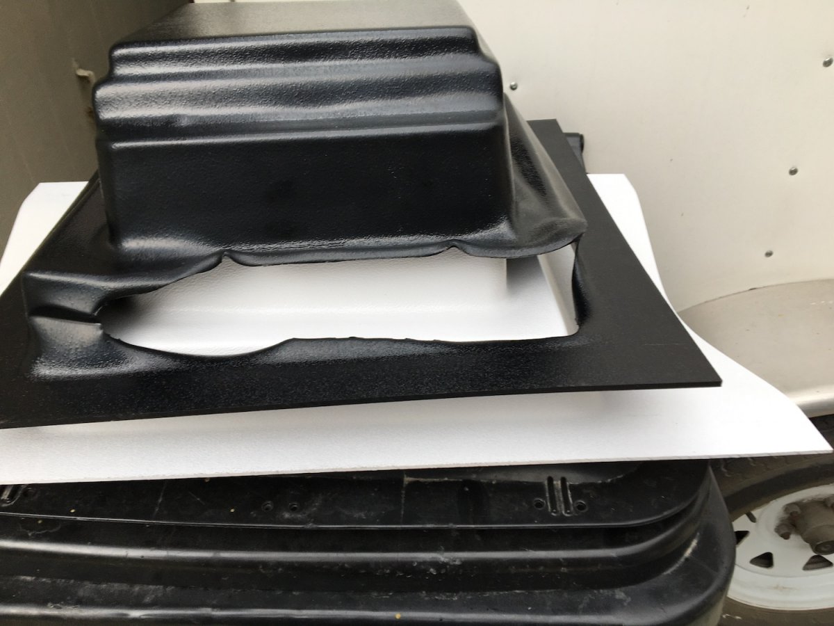

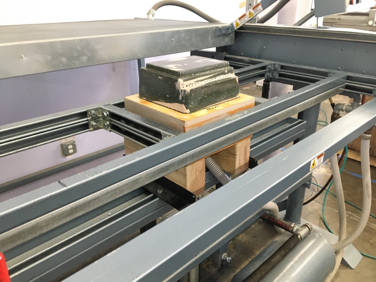

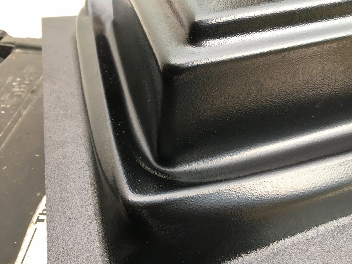

Xtra Report post Posted February 23, 2022 (edited) The shop made me a couple of prototypes and now I have to cut them out to see if the clearance problems are fixed. This is the mold ready to go mounted in the vacuum form machine. There is very little of the wood box that a extends past the mold, and it caused a problem with the thicker material. Here you can see how the thicker ABS was damaged when puled over the mold. The wood box will have to be made larger to have more material to draw from. I made the wood box small trying to get the maximum amount of units from a 4X8 foot sheet of ABS. The size it is now will make 10 units per sheet, after I make the box larger it will make 8 units from a sheet. When we tried to pull the thick ABS off of the mold this happened. Making the box larger should fix this problem as well. We found some scrap of the thinner ABS at the shop, because it is a prototype we decided to use it even if it is white. The thinner ABS molded great and no mods to the mold are needed to make it work. Now if the shape is good all I will have to do is fix the box, then I can expect results like this with the thicker material. . Edited February 25, 2022 by Xtra 2 1 Share this post Link to post Share on other sites

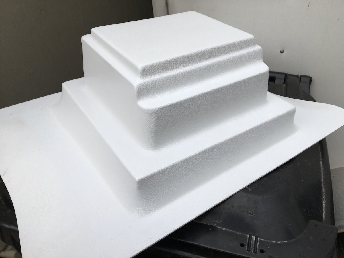

Xtra Report post Posted February 24, 2022 When I saw how well the white ABS worked I thought about how the V2 and the V3 Adaptor could be made in custom colors. 2 Share this post Link to post Share on other sites
Duece McCracken Report post Posted February 24, 2022 3 hours ago, Xtra said: When I saw how well the white ABS worked I thought about how the V2 and the V3 Adaptor could be made in custom colors. OMG!!!!! THE COLORS!!!!!!!!!! 1 2 Share this post Link to post Share on other sites

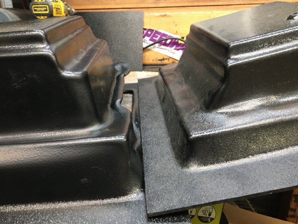

Xtra Report post Posted February 25, 2022 (edited) Both of these are reject prototypes but, the one the right is the original version, on the left is the new improved version. It is much taller now allowing it to be trimmed to the correct height, and the steps make room for the filter. The mold works better as well with more holes drilled in it. Now the ABS is pulling in nicely giving better definition.. These are both prototypes it is slowly getting there. The one on the right is the earlier version, neither are there yet. Edited August 14, 2022 by Xtra 1 Share this post Link to post Share on other sites

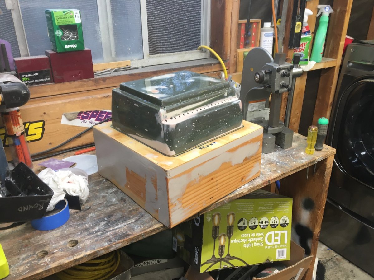

Xtra Report post Posted March 6, 2022 (edited) This is the new lid for the Adaptor mold wood box. It is larger to allow more ABS to draw from as it is pulled over the mold. This should allow the use of thicker ABS that will produce a stronger part. I will keep rebuilding it until it works properly and makes quality parts. Edited March 6, 2022 by Xtra 2 Share this post Link to post Share on other sites
Xtra Report post Posted March 6, 2022 (edited) Have finished putting the wood box together. Have filled all the counter sunk screw heads with Bondo and sealed the edges and corners to prevent vacuum leaks. As soon as it drys I will sand it for the finish coat. Edited March 7, 2022 by Xtra 2 Share this post Link to post Share on other sites
