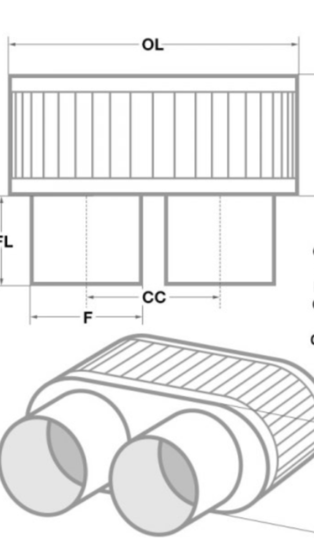

Xtra Report post Posted April 25, 2021 (edited) It is happening. I have been doing a lot of research and design into an air box that will fit both the Edge ST and the Sport. The design may change but as of now it is all about adaptors. Adaptors for the filter that have to be fabricated and welded. Adaptors for the filter that has to be molded . I am working on the mold now and it is much easier than the V2 intake mold. I learned so much with the V2 that this time I know what to expect and the daily surprises should be less. ***** Update 5-8 -21 The design has changed and fitment into the ST has not been re - established . I really want it to fit , but I have no access to a ST at this time to check for fit. Now is the time as once the molds are made I am locked in . It would take about 20 min to check and make notes. Anyone in the Los Angeles area that has a ST and would like to help please PM me. Some of the parameters for the air box: 1. It must be easy to install and something anyone can do. 2. It must require a minimum of tools to install. Right now the tools needed are a 7mm and 8mm nut driver, wrench or socket, and a big hammer...LOL. Just kidding about the big hammer. 3. It must move more air than stock with less restriction,. 4. t must look good ! As I don't want my ideas copied by a big company this thread will help establish my “ intellectual property “ Here is some info about the air filter: It can move over twice the air as the stock filter and will be available in a wet or dry configuration. Edited May 8, 2021 by Xtra 9 Share this post Link to post Share on other sites

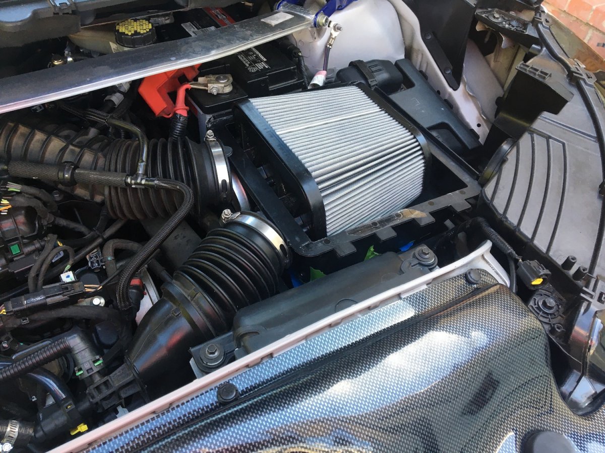

Xtra Report post Posted April 26, 2021 (edited) Here is the dry filter that will be used. It is huge! It will also be available as a washable reusable oiled filter. Edited April 26, 2021 by Xtra 9 Share this post Link to post Share on other sites
WWWPerfA_ZN0W Report post Posted April 27, 2021 This is awesome! 2 Share this post Link to post Share on other sites

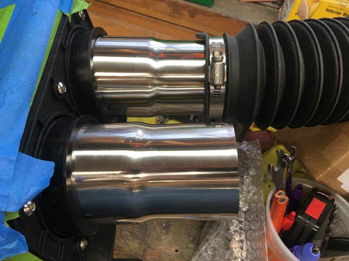

Xtra Report post Posted April 28, 2021 (edited) 2.75 to 3 inch SS adaptor that will be used in the mach up adapting the filter to the car. They may or may not be used in the final form, I am still figuring things out. . I may end up using mandrel bent aluminum tube to align the filter to the car if I can’t get these straight reducers to line up. These cost three times less than the mandrel bent tube and there is no welding. needed. keeping the cost down is important Edited April 28, 2021 by Xtra 3 Share this post Link to post Share on other sites

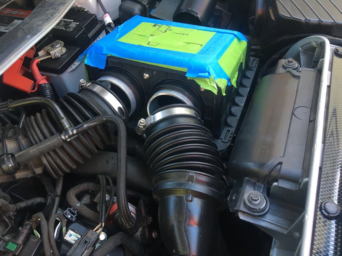

Xtra Report post Posted April 29, 2021 (edited) I have made substantial progress, though in the photos it looks way more complete than it is . I still need to add the sensor and gaskets and latches and adaptors and much, much more than you see in the photos. What you do see is a mockup and fitting of a 10 pound filter in a giant air box stuffed into in a 5 pound bag. And it fits I have been working on this all week there is a long way to go but today was a major breakthrough and it is going to look like a factory setup when complete. You may notice that I am still using the snorkel. I am doing this because it feeds air into the large cavity at the bottom of the air box allowing for the air to distribute evenly and it acts like a plenum or manifold. Though some have bypassed the snorkel all the air still has to get through that little slot in the bulkhead that the snorkel attaches too and that is the great equalizer, no matter what direction the air comes in. And that is what the V2 intake helps with, feeding the snorkel. The V2 Intake and V3 Air Box work hand in hand to make a complete system. That is one big filter. It can flow over twice the air as OEM Sneak peek of the V3 Air Box in place. Here I am checking the alignment of the filter to the car. It is looking like It is going to be mandrel bent 6061 aluminum tube with a home made reducer welded on. It is expensive to do it that way but right now it is looking like that is the only choice. You can see that the snorkel is in place and it is not modified to allow putting the car back to stock when on the street or at smog checks. This system is not street legal and is for off road use only. Edited July 9, 2021 by Xtra 4 Share this post Link to post Share on other sites
Xtra Report post Posted April 30, 2021 (edited) I won't know for sure if it will fit the ST but i am hopeful . My first design I was sure that it would fit the ST and all the 2.7EB Edges, but this new design is cleaner and we won't know until we try . I will have to find someone with a ST to try it out when I get the air box into production. I am fairly sure that someone will want to test fit it for me...Anyone out there with an ST in the Los Angeles area? Oh, and now that I have had this breakthrough with the air box I can get back to trimming and shipping the V2 intakes.. Edited April 30, 2021 by Xtra 2 Share this post Link to post Share on other sites
Perblue Report post Posted April 30, 2021 Almost positive this one will work on a ST. You're going to make me wish I didn't buy my steeda one last year. If I lived closer I'd be all for testing. 😞 1 Share this post Link to post Share on other sites
Xtra Report post Posted April 30, 2021 Sometimes I wonder , I guess I was so excited that the air box fit that I forgot to measure the angel of the adaptor tubes. That is something that can only be done when the V3 air box is installed. Now I will have to reinstall it to know how much to bend the tubes, then take it out and reinstall the OEM air box just so I can drive the car. Once I have those angles the elbow reducers can be fabricated, and it will be one step closer. 2 Share this post Link to post Share on other sites

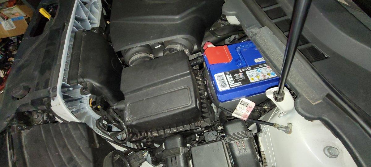

MSCOSC Report post Posted May 2, 2021 Is the new box much wider than the factory one? I have a 94r battery in there which is the largest you can fit in the tray, there is a hole for the bracket and everything. 1 Share this post Link to post Share on other sites
Xtra Report post Posted May 2, 2021 1 hour ago, MSCOSC said: Is the new box much wider than the factory one? I have a 94r battery in there which is the largest you can fit in the tray, there is a hole for the bracket and everything. No worries the air box is much bigger in every direction , but it does not interfere with the battery tray. If the battery fits into the stock tray the air box should still fit. I am running a oversize battery as well, I think it is an H6 the 94R is an H7 a bit larger than mine. I will look next time I test fit the air box to see what's up and report back. 1 Share this post Link to post Share on other sites
Xtra Report post Posted May 2, 2021 (edited) The 2.75 OD to 3inch OD stainless steel straight reducers arrived and they fit perfectly. They can be cut and welded to make the angle. The 2.75 mandrel bent aluminum elbows I ordered are tight radius, but may take up too much room, and only testing will tell what direction to go. I am awaiting the arrival of the elbows. \ Edited May 2, 2021 by Xtra 6 Share this post Link to post Share on other sites
Duece McCracken Report post Posted May 2, 2021 19 minutes ago, Xtra said: The 2.75 OD to 3inch OD stainless steel straight reducers arrived and they fit perfectly. They can be cut and welded to make the angle. The 2.75 mandrel bent aluminum elbows I ordered are tight radius, but may take up too much room, and only testing will tell what direction to go. I am awaiting the arrival of the elbows. \ Awww yeah. Now thats what Im talking about. Minus the accordians that is. Lol 1 Share this post Link to post Share on other sites
Xtra Report post Posted May 2, 2021 (edited) 2 hours ago, Duece McCracken said: Awww yeah. Now thats what Im talking about. Minus the accordians that is. Lol Silicon hoses are compatible with this system, but I am not doing that as part of this project. They can always be added later . Edited May 2, 2021 by Xtra 2 Share this post Link to post Share on other sites
