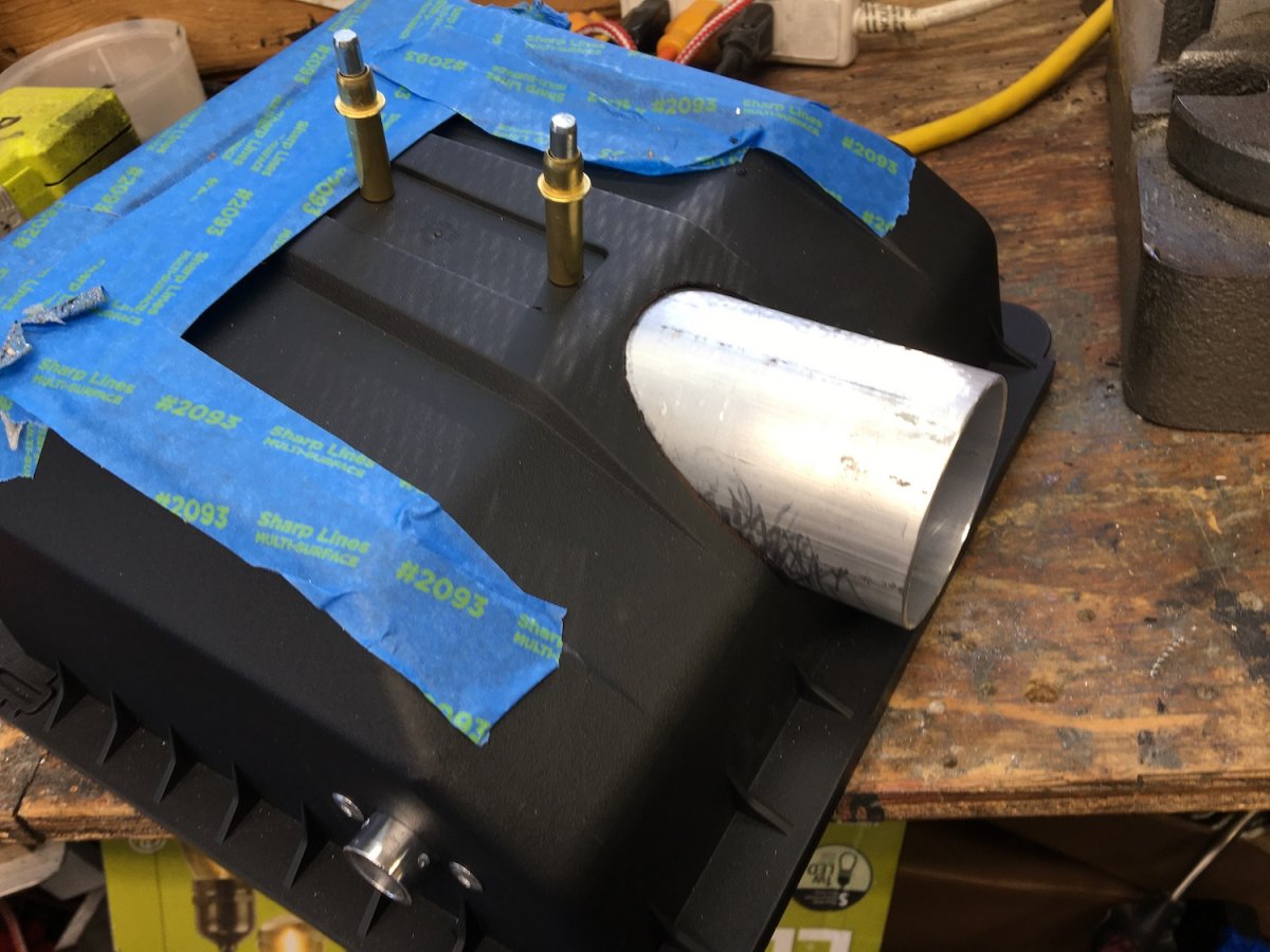

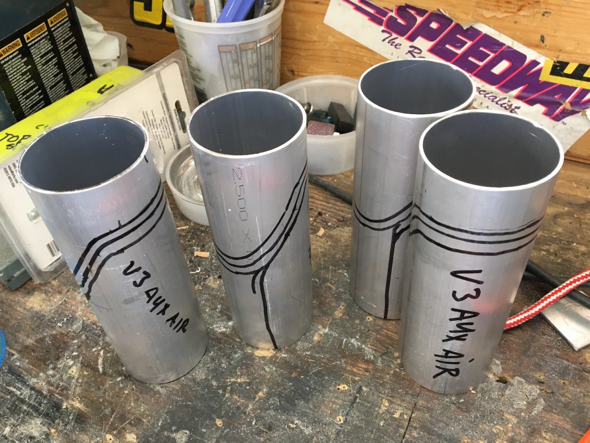

Xtra Report post Posted June 11, 2022 (edited) The tubing for the Aux Air came in today, so I got busy on that. First a test fit with the hole that was just drilled. Then off to the saw. Managed to get 4 Aux Air blanks out of it. The Aux Air blanks with layout lines ready to cut to shape. Edited June 11, 2022 by Xtra 1 Share this post Link to post Share on other sites
Xtra Report post Posted June 11, 2022 (edited) After shaping the V3 Aux Air hose adaptor it is held in place with Cleco fasteners. It gets glued in place with RTV to make an air tight gasket. Rivets hold the finished polished Aux Air Hose Adaptor in place and provide a strong mechanical connection. Edited June 11, 2022 by Xtra 3 Share this post Link to post Share on other sites

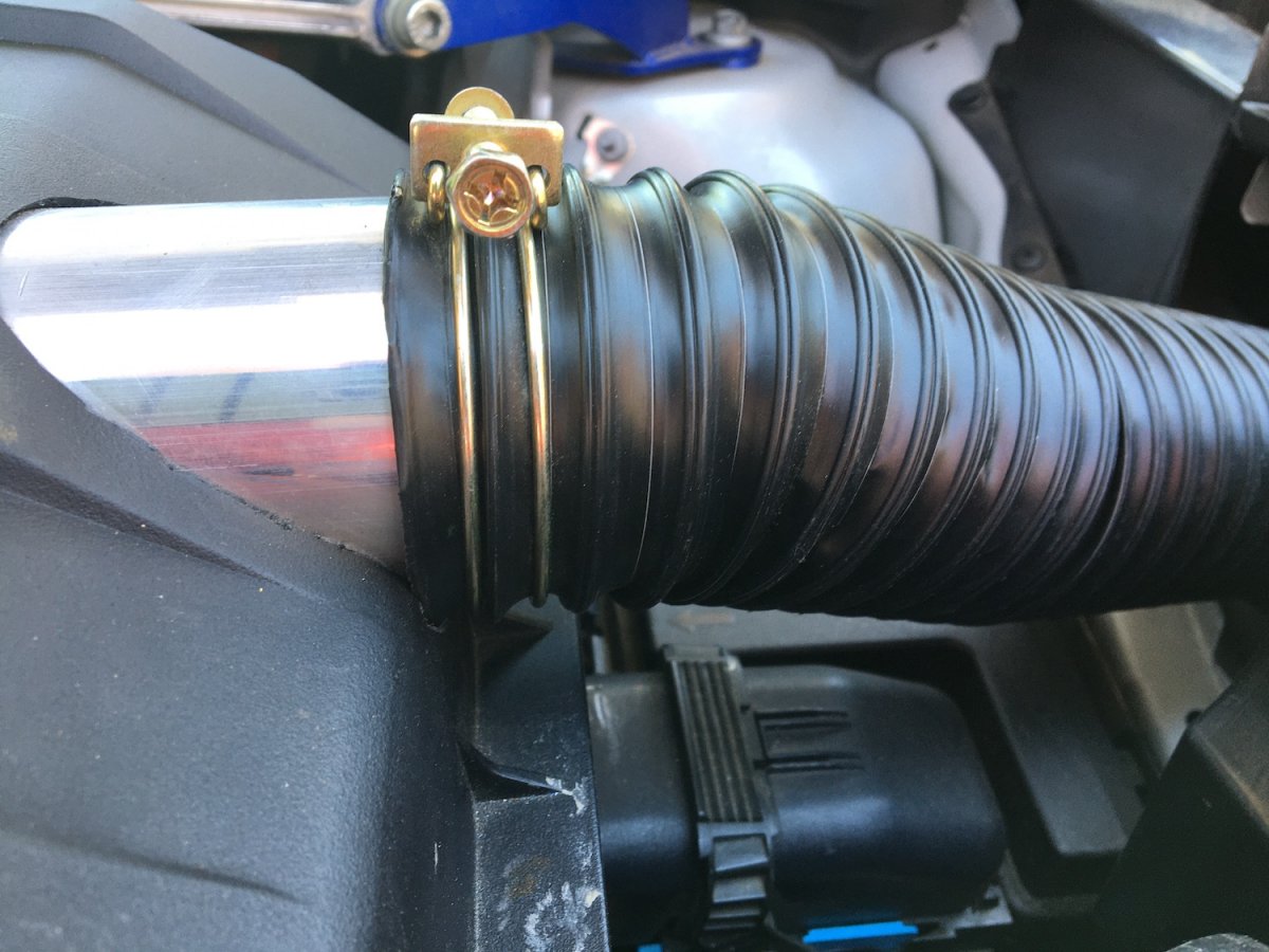

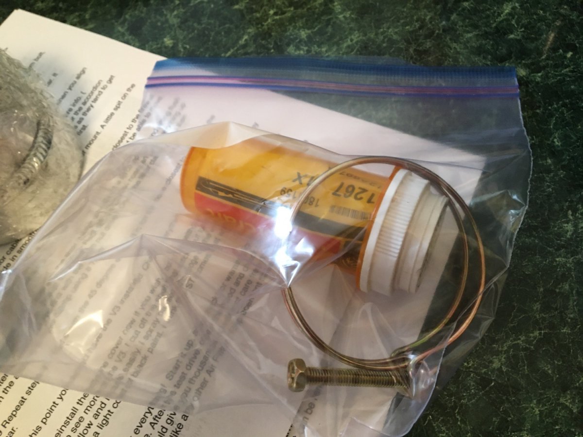

Xtra Report post Posted June 11, 2022 (edited) Here is a tip on how to use the double wire clamp included with the V3 AuxAIr. Flex Hose. The wires on the clamp go into the valleys between the spiral wire in the hose. This gives a clamping force in two places. It is going to be even hotter today. This is the temp at 11AM. It looks like it is going to be around 105 in the shade today. . Edited June 11, 2022 by Xtra 1 Share this post Link to post Share on other sites

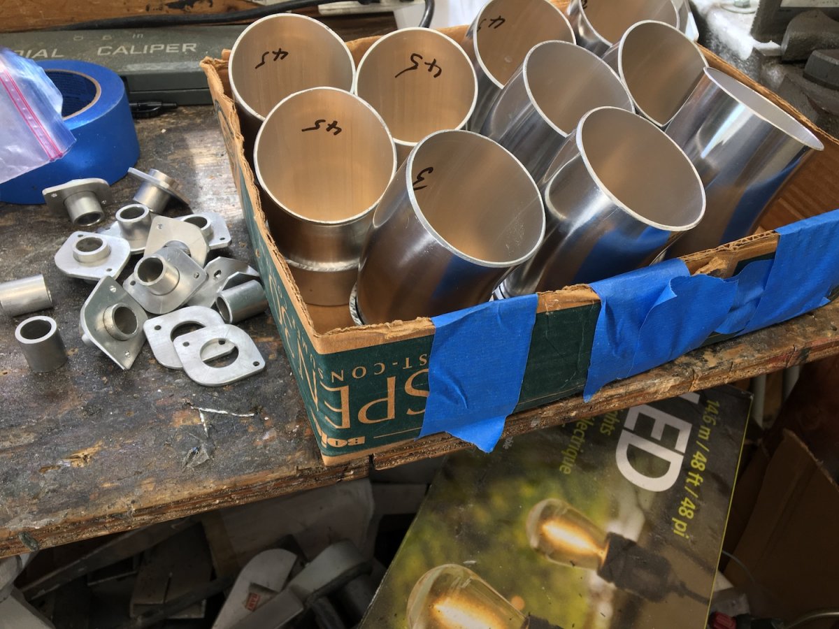

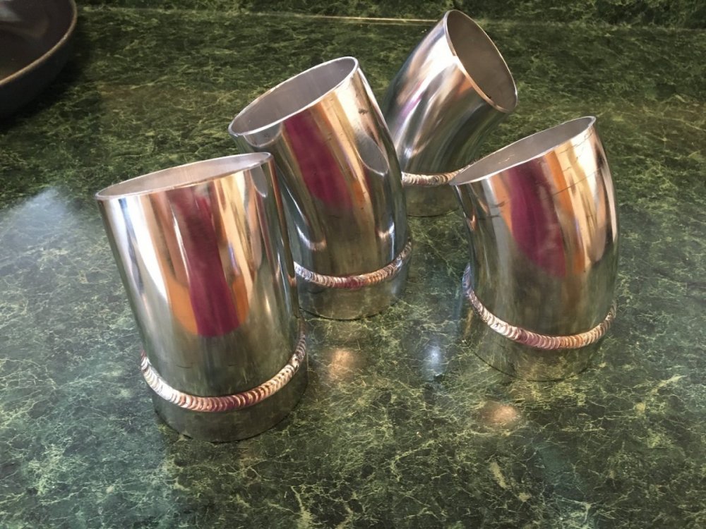

Xtra Report post Posted June 14, 2022 (edited) The welder is hard to get ahold of because he is busy with welding for NASA and the International Space Station. Because he does such excellent work, it was worth making the 3 trips to catch him at the shop. I bring him pieces, he gives me parts. Reducer Elbows. fabricated, welded and polished, ready to go. Edited July 9, 2022 by Xtra 1 Share this post Link to post Share on other sites

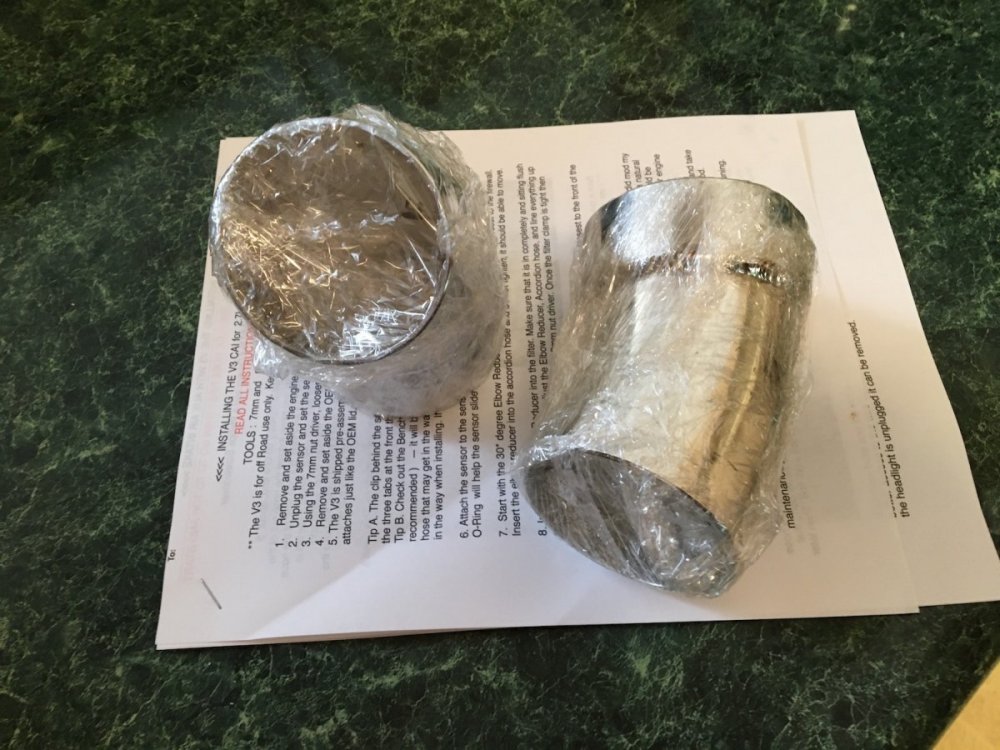

Xtra Report post Posted June 14, 2022 (edited) When the V3 arrives it at your door it will look something like this. This is a V3 unboxing and gives an idea of what to expect. . Open the box and remove packing. This is a V3 with the Auxiliary Air Intake Ii the box you will find the sensor and if you have the Aux Air, then there is a clamp for the Flex Hose The 30* and 45* Elbow Reducer and instructions The expandable Flax Hose Assembled V3 with choice of Oiled or Dry media Air filter The Aux Air intake on the lid. Edited June 14, 2022 by Xtra 1 Share this post Link to post Share on other sites
Xtra Report post Posted June 14, 2022 (edited) Every day more parts keep coming in . Another set of elbows awaiting fabrication into Elbow Reducers. Edited June 14, 2022 by Xtra 1 Share this post Link to post Share on other sites

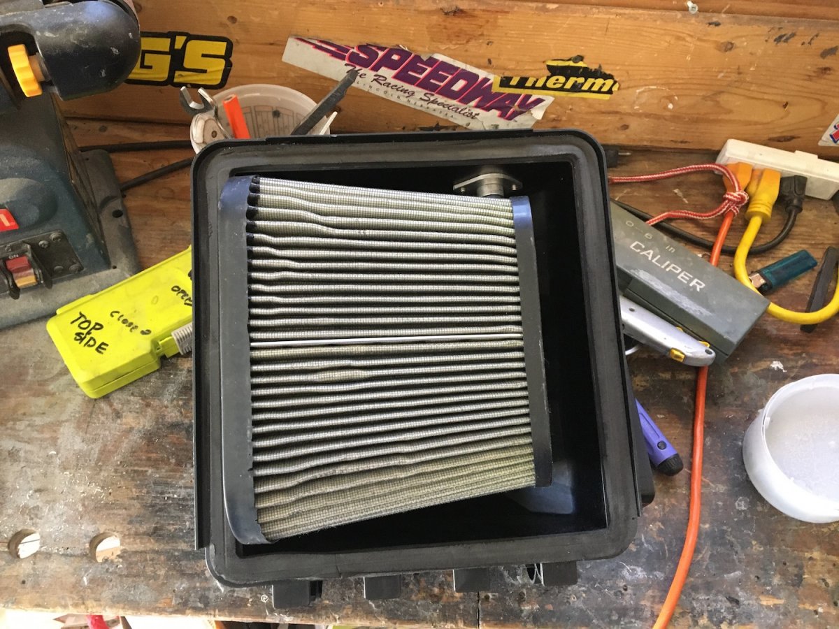

Xtra Report post Posted June 15, 2022 (edited) The V3 filter was originally designed to increase performance on an engine that makes 450HP and 510TQ stock. It is more than enough filter for a 325hp ST or even a modded Edge making over 500 HP. **This is the filter and lid I use for design and set up. Thats why it is dinged up. Edited July 9, 2022 by Xtra 1 Share this post Link to post Share on other sites

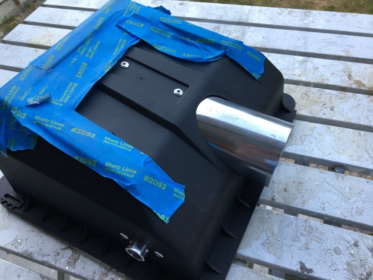

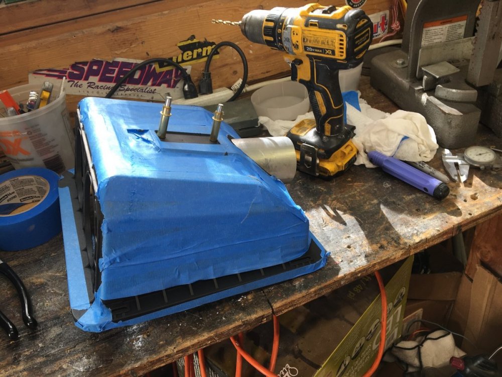

Xtra Report post Posted July 12, 2022 (edited) Now that the 4th of July is over, I can get back to the V3 project. It was another hot day 100*F, yet was still able to work on an Aux Air lid some. Managed to drill the hole and fabricate the aluminum flex hose bib. Attached with Clecos and ready to polish before riveting in place. This lid also needs a Sensor Port and Gasket before it is done. I now wrap everything in blue painters tape for protection as it worked on. Edited July 14, 2022 by Xtra H 1 Share this post Link to post Share on other sites

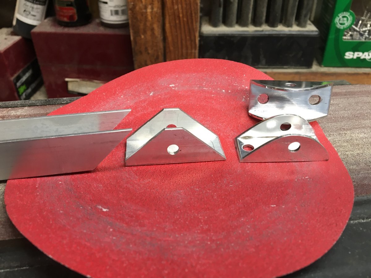

Xtra Report post Posted July 22, 2022 (edited) This little aluminum part takes several steps to make. Cutting, drilling, shaping, de-burring, sanding, and polishing. Final assembly ready for mounting. Worth the effort 😀 Edited July 26, 2022 by Xtra 1 Share this post Link to post Share on other sites

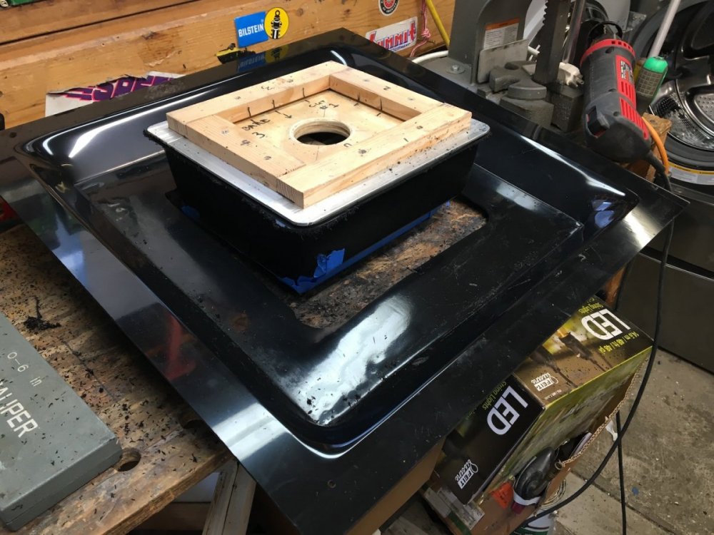

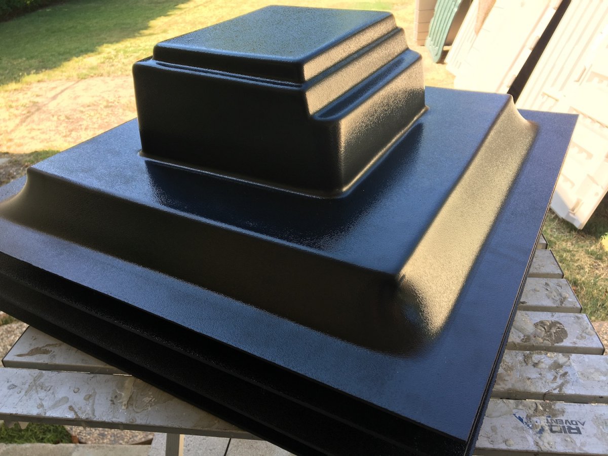

Xtra Report post Posted July 29, 2022 (edited) Just got back from the plastic shop. Molded V3 Adaptors formed and ready to cutout. The "C-Clips" are made with the help of a CNC knee mill. Edited July 29, 2022 by Xtra 1 Share this post Link to post Share on other sites
Xtra Report post Posted July 31, 2022 (edited) Started the next step. In order to make it more manageable excess is removed. This is the first step . After set up, the RotoZip makes the cut. Edited July 31, 2022 by Xtra Share this post Link to post Share on other sites
