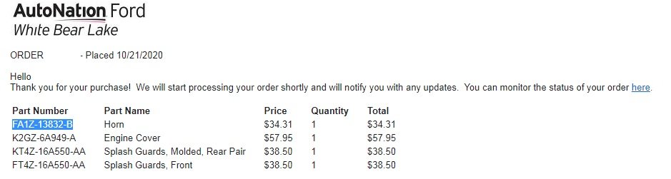

Maybe it's wrong but I didn't want to post this in the old single horn thread. I've watched the video several times in that old thread and I'm pretty sure I could do it. Does anyone know if the procedure is the same on the 2020 Edge? Also, I tried to order the horn from my dealer and his parts list shows nothing but a single horn with bracket not a dual horn and I suspect it the same wimpy horn the factory installed.. When I go to several online Ford parts sites they show the FA1Z-13832-A as the correct horn and not the -B. One even said the -B horn would not fit my vehicle but they both look the same to me.

Look for a 2015 - 2018 factory horn. Dealer will say that it won't fit, but it does. Don't have the part number available, but the swap takes less than 20 minutes. Much improved from the wimpy single horn.
I've found a couple and it looks like there's two, a level 2 and a level 3 that are identical in size, maybe one's supposedly louder than the other. I'm going to have to do this though. What initially scared me off initially was an article I saw that said you had to remove the bumper then I discovered that was for a UK model. LOL, I at least have a good 10mm socket and I'm convinced that size socket will dismantle 75% of any recent model car.
