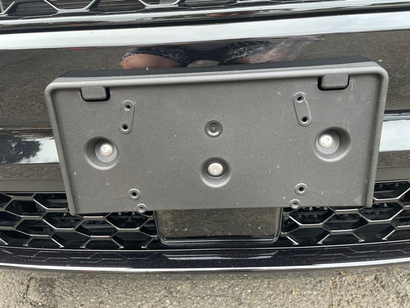

Nick Loschiavo Posted October 16, 2021 Report Share Posted October 16, 2021 (edited) Hello All! Can someone tell me how i go about removal the front license plate frame from the bumper of the vehicle without damaging the vehicle. There are these 3 "pin bolts" (not sure what they're called) that hold the frame to the bumper and im not sure how to remove them or the frame in general. Please Help! Here is a pic of the frame and 3 bolts to help show what I'm referring too.... 4BA27ED0-C8AF-4686-91FB-16B927F1D9B6.heic Edited October 16, 2021 by Nick Loschiavo Quote Link to comment Share on other sites More sharing options...
enigma-2 Posted October 17, 2021 Report Share Posted October 17, 2021 You gave to drill out the rivets. Here's a thread where it was discussed: Quote Link to comment Share on other sites More sharing options...
Nick Loschiavo Posted October 18, 2021 Author Report Share Posted October 18, 2021 Thank you. This is actually my fiances SUV not mine so i am not as knowledgable with this vehicle as i am with my own. Will this work on a 2021 as well? I am sure it will but want to make sure before i start drilling and ruin something. Quote Link to comment Share on other sites More sharing options...
Haz Posted October 20, 2021 Report Share Posted October 20, 2021 Nick: The rivet-drilling works, regardless of the vehicle's model year. Link to another prior discussion with Forum members describing their removal experiences. Good luck! (Your original image converted for posting) Quote Link to comment Share on other sites More sharing options...
