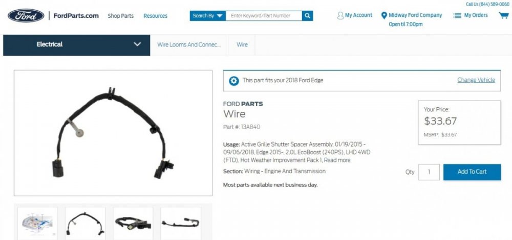

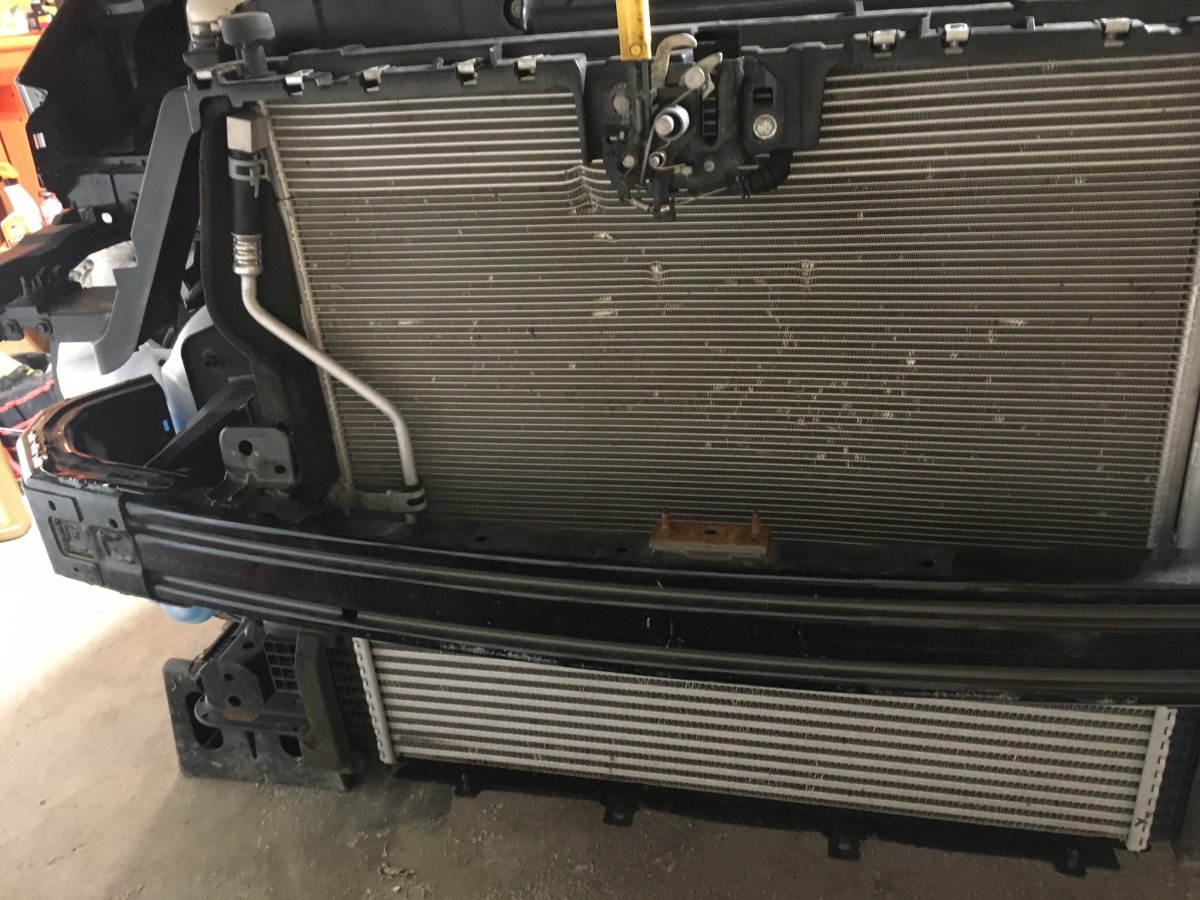

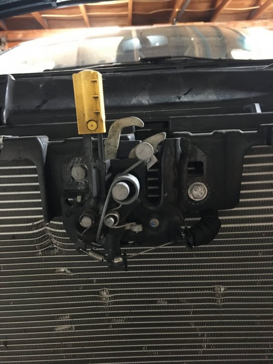

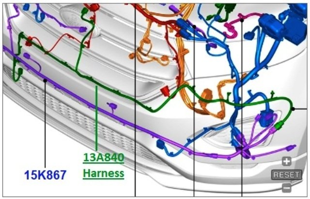

I don't have that connector on my hood latch... must have broken off during the accident I guess??
Thank you for the info! Looks like I'm missing a wiring harness... now to figure out where it connects back into!

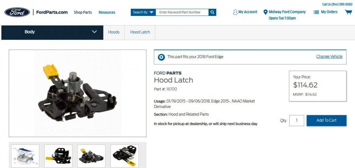

It may still be there, look down from the yellow handle on the backside of the latch.
Here's a link to an ebay listing of a compatible latch. Pictures clearly show the backside. The connector is molded into the latch.
https://www.ebay.com/itm/143091160232?mkcid=16&mkevt=1&mkrid=711-127632-2357-0&ssspo=FeI-rj_XR0m&sssrc=2349624&ssuid=Snv36mbbRk2&var=&widget_ver=artemis&media=COPY
  • Like 2
I think I can see where it connected to the latch, but it's definitely no longer there :( Thanks for the part information! I'll pick up a new latch and wiring harness and hopefully I can stop getting that hood ajar message!!
