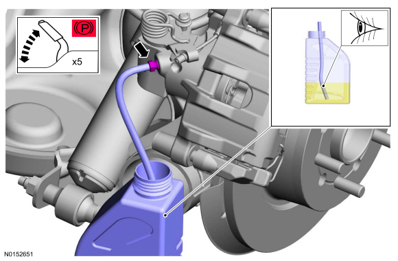

I’m looking for help with my brake issue on a 2013 Edge. This might be lengthy bit I want to put out everything I know. My initial problem was a soft pedal. It would go down smoothly and easily almost to the floor. I didn’t have much braking until I almost went full stroke. Seemed like a master cylinder. I had no external leaks. Talked to a few friends and got a consensus so I replaced the master cylinder with a Motorcraft part from rock auto. I bench bled the cylinder and installed. I vacuumed bled the brakes. Now I have a pedal that gives me slight deceleration as soon as I press the pedal and as I increase the pressure it becomes pretty firm without much more deceleration. It then takes a good bit of pressure to break through that firmness and I get more breaking. With the car off, a pump or 2 and the pedal is rock hard about half way down. I looked around online and read something about needing to actuate through emergency brake during rear brake bleeding. Is that a thing? Could that be my current problem? Any other ideas? TIA.

Beginning with your question on parking brake involvement during brake system bleeding, from the 2013 Edge Workshop Manual's...
Brake System Bleeding - General Procedures - 2013 Edge Workshop Manual.pdf (download link)
Vehicles with rear integral parking brake calipers
  1. NOTE: Due to the complexity of the fluid path within the rear integral parking brake calipers, it is necessary to press and release the parking brake during the bleed procedure.
    Apply and release the parking brake 5 times. Loosen the rear bleeder screw. Leave open until clear, bubble-free brake fluid flows, then tighten the rear bleeder screw.
    • Repeat until clear, bubble-free fluid comes out.

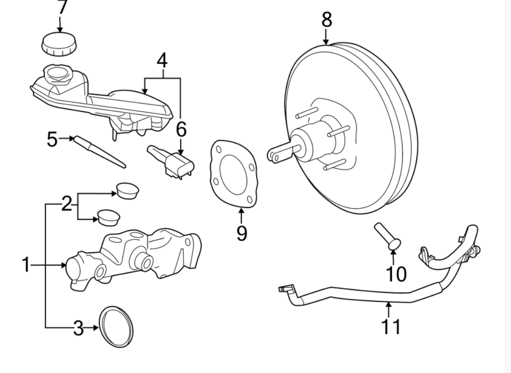

It seems like the pedal is easier to push while in park vs in drive. Does that sound normal, I guess I never noticed. I am wondering about the booster line check calve. This is also buried but I'll take the battery out for more access. I am wondering if that line goes somewhere else other than the booster. I got this image from Ford. I was able to remove one end and blow in it, it sounded like air was coming out somewhere. Should the check valve prevent this? I'd appreciate any ideas and I'll post my results. Thanks

There will  be a little more manifold vacuum available to the brake booster when selected to Park, so that might be the reason why the pedal feels easier to push.
Most often the line from the manifold with its check-valve are exclusively used for the brake booster.
I would test the brake booster to see if it holds vacuum - it should hold vacuum for days if there no leaks - also check the vacuum hose and its check-valve.
I was able to get the booster vacuum line off. Item 11 on the pic above is accurate. From the plenum it goes to the booster. I wasn't able to get the valve off the booster but plugged open end. When blowing on the end of the tube, I didn't detect any leakage so I think the line and check valve are good.
