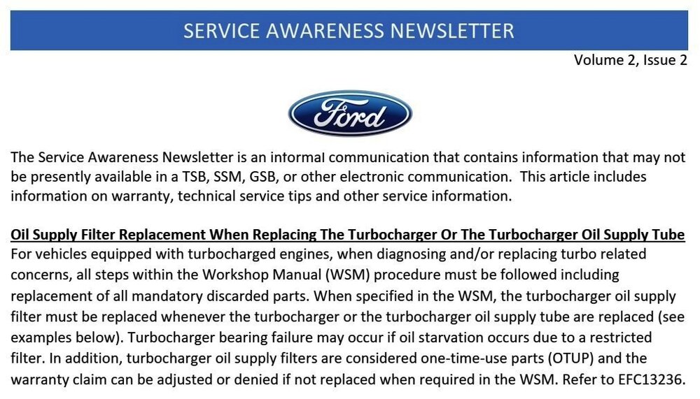

Service Awareness Newsletter - Oil Supply Filter Replacement When Replacing The Turbocharger Or The Turbocharger Oil Supply Tube

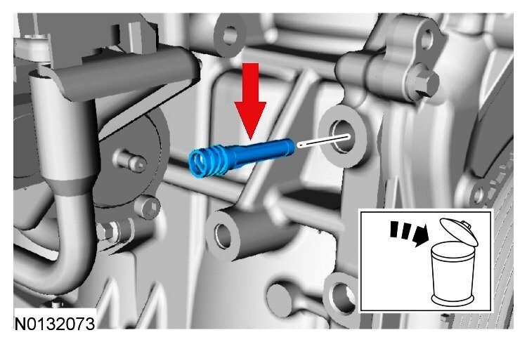

EcoBoost 2.0L illustration - The filter is located on the Engine oil supply-side of the Tube.
Turbochargeroilsupplytubefilter-2.0LEcoBoost-Engineoiloutletillustration-2013EdgeWorkshopManual.jpg.9331d20ef85530d2d7b15448c4a4ac64.jpg

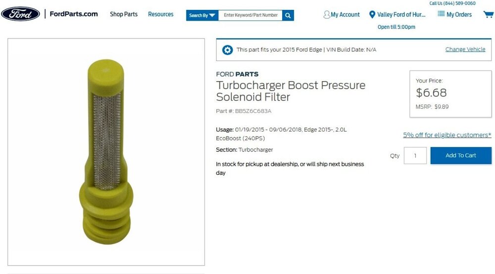

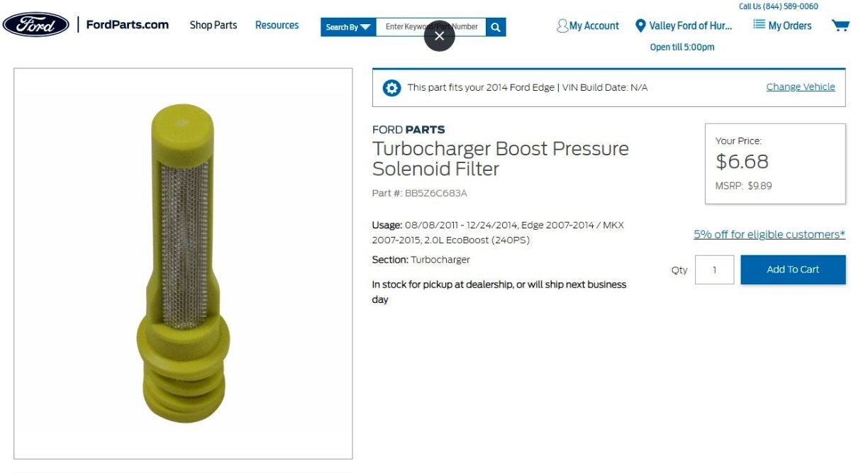

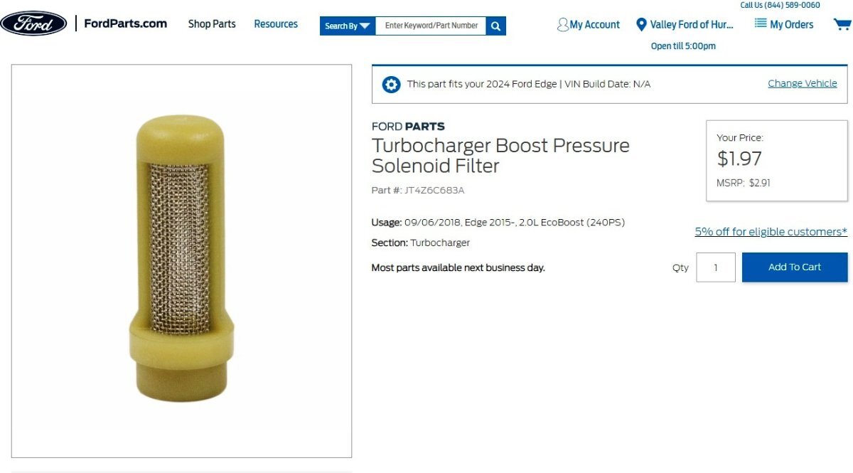

Example-listings of filters found on Ford's online parts-selling website...
2.0L EcoBoost - Two different part numbers and three listings are shown for various manufacturing dates, so searching by vehicle VIN would be advisable to ensure proper filter fitment.
Turbochargeroilsupplytubefilter-08-08-2011to12-24-20142.0LEcoBoost-FordParts_com.thumb.jpg.cf7655a6cca0457a0b8b503713b25382.jpg
Turbochargeroilsupplytubefilter-2015andlaterEdge2.0LEcoBoost-FordParts_com.thumb.jpg.255e73b33e8b9f4b6de7827856c15e4e.jpg
Turbochargeroilsupplytubefilter-09-06-2018andon2015andlaterEdge2.0LEcoBoost-FordParts_com.thumb.jpg.5e0754d6a2c2c65fb01a013a5dad61e8.jpg

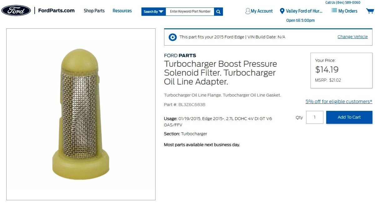

2.7L EcoBoost - One listing found, though searching by vehicle VIN is always a good idea.
Turbochargeroilsupplytubefilter-01-19-2015andlater2.7LEcoBoost-FordParts_com.thumb.jpg.125428b565555ba04235ab8dfe50aa9e.jpg

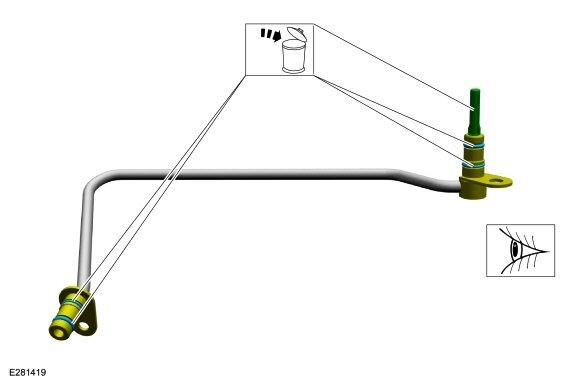

Great question!
Essentially, this is Ford's reminder to Service technicians to install new filter/O-rings whenever the tube is removed and reinstalled, or when a new tube is installed if the original tube is damaged.
Notable for me was the mention: "the warranty claim can be adjusted or denied if not replaced when required in the WSM " (Workshop Manual).
Procedure from the Edge Workshop Manual (with emphasis added)...
Upon removal
  1. NOTICE: Do not use a metal brush, damage to sealing area will result in leaks.
    • Inspect the turbocharger tube and the sealing surfaces. Ensure that the retaining bracket is not bent, check for square-ness of the retaining bracket to the O-ring area. Use brake cleaner and a nylon brush to clean. Install new components as needed.
      Material: Motorcraft® Metal Brake Parts Cleaner / PM-4-A, PM-4-B
    1. Remove and discard the turbocharger oil supply tube O-ring seals and the turbocharger oil supply tube oil filter.

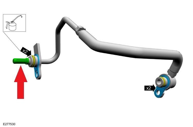

TurbochargerOilSupplyTube-MandatoryReplacementItemsonTube.jpg.73a5353c6b5724b022c0a6c4aa248239.jpg
Upon installation
  1. Install the new turbocharger oil supply tube O-ring seals and the new turbocharger oil supply tube oil filter. Lubricate the new O-ring seals with clean engine oil.
    Refer to: Specifications (303-01B Engine - 2.7L EcoBoost (238kW/324PS), Specifications).

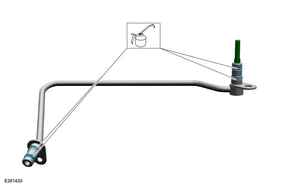

TurbochargerOilSupplyTube-LubricationofitemsonTubebeforeinstallation.jpg.b9c48addb330aff027a7dde713ec2f2a.jpg
    NOTICE: When installing the turbocharger oil supply tube into the engine block, use care not to damage the new turbocharger oil supply tube oil filter.
    • Carefully use a nylon brush to remove the old O-ring residue and use brake cleaner to rinse the O-ring residue out of the turbocharger tube to turbocharger O-ring bore and the turbocharger tube to engine O-ring bore. Inspect the area for deep scratches and gouges. Install new components as needed.
    1. Install the turbocharger oil supply tube, then install and tighten the turbocharger oil supply tube bolts.
      Torque: 89 lb.in (10 Nm)
