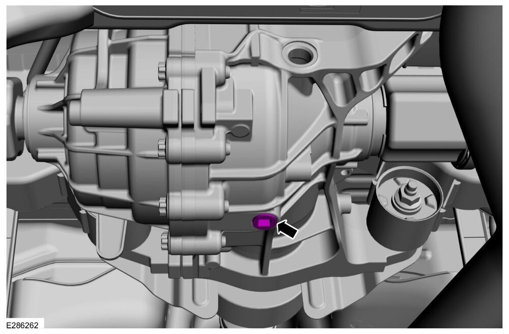

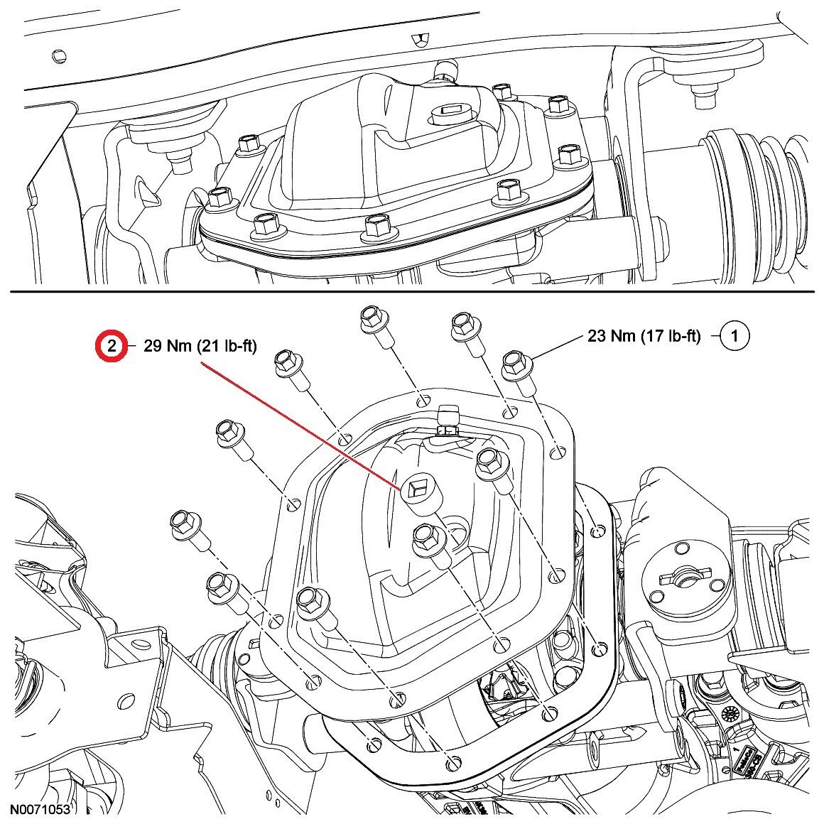

Haz Posted March 7 Report Share Posted March 7 (edited) 2015-2018 Edge Workshop Manual - Rear Differential Unit (RDU) - Filler Plug ONLY 2019-2024 Edge Workshop Manual - Rear Drive Unit (RDU) - Filler Plug 2019-2024 Edge Workshop Manual - Rear Drive Unit (RDU) - Drain Plug 2007-2014 Edge Workshop Manual - Rear Differential Unit (RDU) - Filler Plug ONLY Good luck! Edited March 10 by Haz 2 1 Quote Link to comment Share on other sites More sharing options...

flymore Posted March 8 Author Report Share Posted March 8 Ok, that's what I was looking for. Hoping the fluid change will prevent a RDU failure. Thanks Quote Link to comment Share on other sites More sharing options...

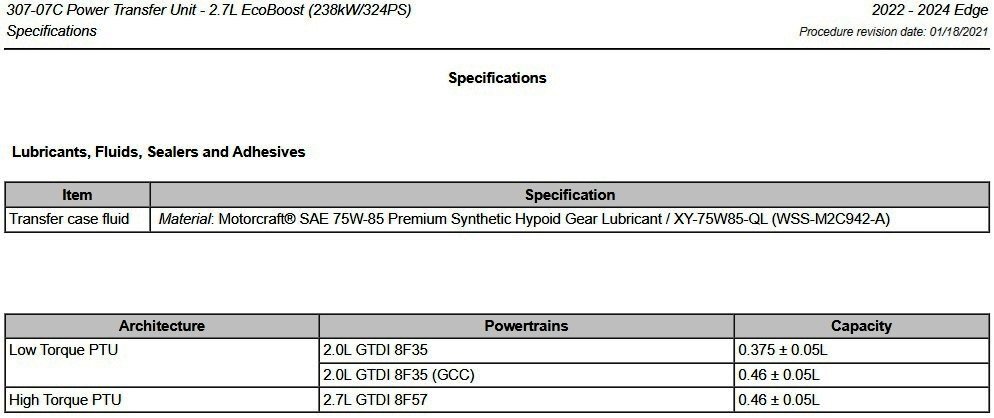

Haz Posted March 11 Report Share Posted March 11 (edited) @STBEAST: From the 2022-2024 Edge Workshop Manual, including Power Transfer Unit (PTU) drain & fill procedure attached below as a PDF document... Good luck! Power Transfer Unit Draining and Filling - 2.7L EcoBoost - General Procedures - 2022-2024 Edge Workshop Manual.pdf Edited March 11 by Haz 1 Quote Link to comment Share on other sites More sharing options...

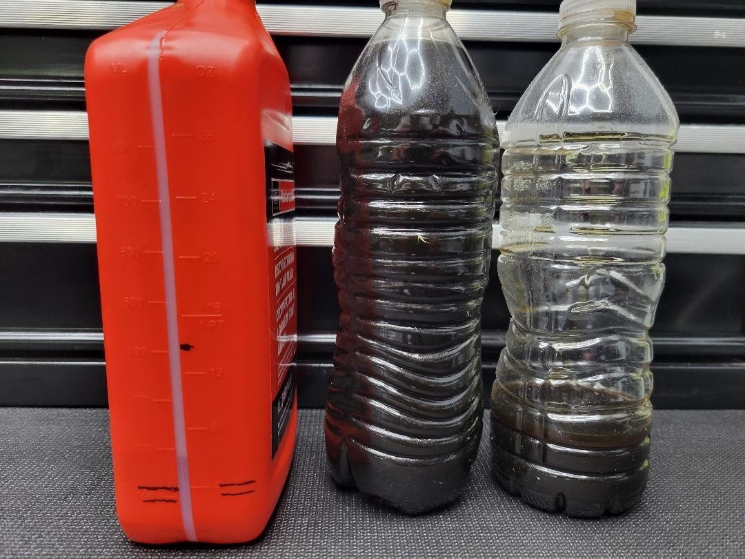

drm1harley Posted 22 hours ago Report Share Posted 22 hours ago (edited) My 2020 Edge ST with 68,xxx miles began to make an inconsistent vibration sound, not feel, from the rear of the vehicle when I made a slow turn to the right from a stop. I researched potential causes and ruled out everything except the RDU. Like others who experienced similar, I went with an RDU fluid change to see if that made a difference. When I changed the fluid, the amount drained was lower than I expected, and when I filled it, I used less than the manual specs. I had the vehicle raised on four jack stands and ensured it was level, which it was from three different locations. It’s a super easy process, draining and filling. Approximately 20 oz of fluid was drained over 15 minutes, as shown in the water bottles. Not much sludge on the drain magnet, and no metal fragments were present. When I went to refill, I could only get 25 – 26 oz before the fill hole started running out. I guess it's no big deal because once it spills out, it's full. Has anyone else experienced lower-than-expected fluid when you drained the RDU? As for the vibration sound….not hearing it now. Maybe once the fluid level gets too low the vibration sound starts. Edited 1 hour ago by drm1harley Attachment failed Quote Link to comment Share on other sites More sharing options...
