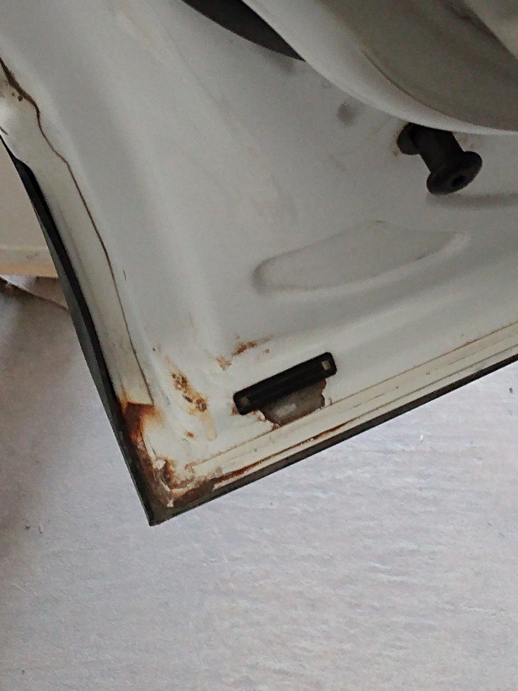

oskar27 Posted March 20 Report Share Posted March 20 I have a 2016 Edge Titanium, FWD, 2L ECOBoost, 62K Kilometers no problems so far at all. Leased the car new and bought the lease at the end. I'm aware of the coolant intrusion issue. The interior of both rear doors by the bottom started rusting. That's a bad doors design because the way the doors are made it creates a place for dirt to accumulate in that area and start rusting. Plan to go to a body shop soon. The two front doors in the same area are clean but depending on how they will fix the rear doors I may ask to do the same on the front doors. Any idea how they can fix the problem? Thanks Quote Link to comment Share on other sites More sharing options...

Samurai Edge Posted March 24 Report Share Posted March 24 The only problem with the video above is that you are now spraying over the rust that is already there. The best time to do that is when you first buy your brand new car. Quote Link to comment Share on other sites More sharing options...
oskar27 Posted March 24 Author Report Share Posted March 24 Good point mate but I thought he sprays the inside of the cavity at both ends? Anyway tomorrow I go for an oil change and will see what the dealer has to offer Thanks Quote Link to comment Share on other sites More sharing options...
Samurai Edge Posted March 24 Report Share Posted March 24 Doesn't matter which end he sprays in. If you see rust, then you have rust, plain and simple. You will not know how much rust you have in that door unless you take the door apart. Covering the rust with any type of lubricant / sealer / anti-rust compound does not make the rust go away. It masks it. The only real way to eliminate the rust is to cut it out and you will have to take a good section of the rusted area and the surrounding non-rusted area out to ensure you get it all, or as much as possible. Rust is a cancer. What you don't see is what can kill your car. 1 Quote Link to comment Share on other sites More sharing options...
oskar27 Posted March 24 Author Report Share Posted March 24 11 minutes ago, Samurai Edge said: Doesn't matter which end he sprays in. If you see rust, then you have rust, plain and simple. You will not know how much rust you have in that door unless you take the door apart. Covering the rust with any type of lubricant / sealer / anti-rust compound does not make the rust go away. It masks it. The only real way to eliminate the rust is to cut it out and you will have to take a good section of the rusted area and the surrounding non-rusted area out to ensure you get it all, or as much as possible. Rust is a cancer. What you don't see is what can kill your car. I understand all this and what rust can do and I do not want to cover the rust. That area at the bottom of the door is very difficult to cut and re build and that's the reason I posted here to get info from other members. Hopefully the dealer tomorrow will tell me how it can be fixed. Thanks Quote Link to comment Share on other sites More sharing options...
enigma-2 Posted March 25 Report Share Posted March 25 The spray converts the rust into a stable compound and stops future rust. Been out for years. "Fluid film" can also stop rust in its tracks. Quote Link to comment Share on other sites More sharing options...
Samurai Edge Posted March 25 Report Share Posted March 25 Years ago, back in the 80s, I used a product ( name forgotten ), that made that same claim and actually worked. Within the last 10 years somewhere, no longer, I used the same product again and it did nothing. The company obviously changed the formula, as is so common anymore, to save money. The product was definitely not " Fluid Film ". If " Fluid Film " really works, that would be great. 1 Quote Link to comment Share on other sites More sharing options...
enigma-2 Posted March 25 Report Share Posted March 25 (edited) Probably POR-15. It's messy, but it works. Other products include Corroseal, Rust-Oleum Rust Reformer and Mar-Hyde One-Step. They are advertised to convert iron oxide (rust) into iron tannate (a paintable black layer. Fluid Film is lanolin-based. It blocks the air from reaching the existing rust and prevents it from growing. Don't know what your dealer would use, if I would do myself, id use Rust-Oleum Rust Reformer, mainly because it's easier to spray inside th÷ door drain holes. . Edited March 25 by enigma-2 Quote Link to comment Share on other sites More sharing options...

Samurai Edge Posted March 27 Report Share Posted March 27 On 3/25/2026 at 3:31 PM, enigma-2 said: Don't know what your dealer would use, if I would do myself, id use Rust-Oleum Rust Reformer, mainly because it's easier to spray inside the door drain holes. I'm fairly certain that Rust-Oleum Rust Reformer is the product I used years ago. I would not use it now as the product became ineffective. I've never used POR-15 nor Fluid Film. Everything I have read about the two products has shown that: 1. Fluid Film works, but washes off and needs to be re-done once a year, at a minimum. All depends on your operating environment. 2. POR-15 works very well, but as stated, it's messy and, IIRC, professional equipment is needed to apply properly. You don't just spray it on. Quote Link to comment Share on other sites More sharing options...
enigma-2 Posted March 28 Report Share Posted March 28 I've used POR-15. You brush it on. Two coats. Messy, whatever it touches is permanent. As an expirement I coated the underside on my Simplicity garden tractor's mowing deck. (Lasted one year in the heavy wear areas. Still present in the edges.) Fluid film is usually sprayed on by professionals. Touched up once a year. But, inside a door interior, would probably last a lifetime. Quote Link to comment Share on other sites More sharing options...
enigma-2 Posted March 28 Report Share Posted March 28 I believe thereake be some confusion about Rust-Oleum Rust Reformer. There are two different types (Stops Rust Rust Reformer and Rust-Oleum Automotive Rust Reformer) and have different chemical formulations, depending on the application method. Method #1 is an aerosol spray (consists of an oil-based, alkyd formula), and Methoid #2, a brush-on liquid, which consists of a water-based copolymer (sort if a milky white liquid.) The brush-on takes rust and turns it into a flat black, inert primer. The only type I've used is the brush on and have had good success with it. It stopped rust for years (until I sold the car.( Quote Link to comment Share on other sites More sharing options...
Samurai Edge Posted March 29 Report Share Posted March 29 15 hours ago, enigma-2 said: I believe thereake be some confusion about Rust-Oleum Rust Reformer. There are two different types (Stops Rust Rust Reformer and Rust-Oleum Automotive Rust Reformer) and have different chemical formulations, depending on the application method. Method #1 is an aerosol spray (consists of an oil-based, alkyd formula), and Methoid #2, a brush-on liquid, which consists of a water-based copolymer (sort if a milky white liquid.) The brush-on takes rust and turns it into a flat black, inert primer. The only type I've used is the brush on and have had good success with it. It stopped rust for years (until I sold the car.( I used the brush-on type as you described in the past. Maybe I got a bad batch or maybe they changed formulas and then changed back again. I have no idea. If it has worked for you more recently than 10 years ago, maybe they improved it again. More power to you if they had. Quote Link to comment Share on other sites More sharing options...

oskar27 Posted April 27 Author Report Share Posted April 27 I used Rust-Oleum Rust Reformer to fix the inside of the 2 rear doors (the 2 front doors are ok). Took more time to tape/hide the surround areas and it's done. Question now is what are these 2 plastic covers at the bottom of each door? I remove them before spray but I think not to put them back. To my opinion they must be covers for the drain holes but why to cover the holes? Any ideas? Quote Link to comment Share on other sites More sharing options...
enigma-2 Posted Saturday at 03:02 AM Report Share Posted Saturday at 03:02 AM (edited) As i understand it, the rubber plugs found on the bottom of car doors can serve different functions. One is to prevent road salt, dust, and water from entering the inner door cavity from the outside. They also act as one-way valves, allowing water that entered through the window seals to drain out. They also act as cleaning access. You to remove them to spray out dirt inside to door. They also alliow mechanics to spray rust prevention coatings into the door's interior without needing to drill new holes. And lastly for sound proofing. They help reduce wind noise from entering the interior. . Edited Saturday at 03:03 AM by enigma-2 Quote Link to comment Share on other sites More sharing options...
oskar27 Posted Saturday at 04:49 PM Author Report Share Posted Saturday at 04:49 PM I understand them plugs may serve something but I decided to take them out from all doors and keep an eye in there. I kept the plugs just in case. Quote Link to comment Share on other sites More sharing options...
enigma-2 Posted Sunday at 03:47 AM Report Share Posted Sunday at 03:47 AM Probably violates Ford's OEM warranty....... Quote Link to comment Share on other sites More sharing options...
