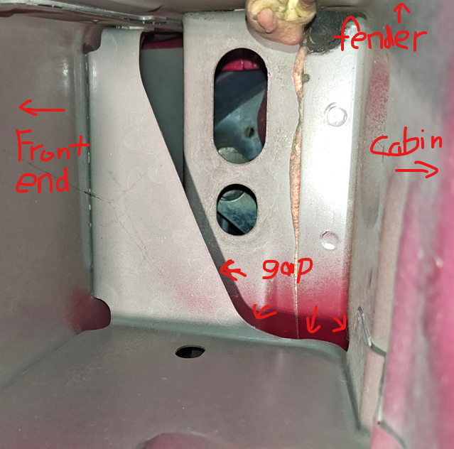

I took the driver side wheel well liner off to get access to the crowl drain.
Does anyone know if this is what it is supposed to look like? There isn't anything that is channeling the water to anywhere specific. The water just falls onto the liner. Which means that the water can enter the gap shown in the pic.

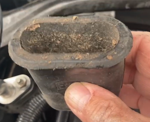

Posted (edited)
This is a pic of a Ford Flex crowl drain rubber piece. Maybe my edge is missing it. It looks like it would help channel the water past the gap. I tried looking for one for my edge on the autoparts stores but not luck.
Edited by Cascadia

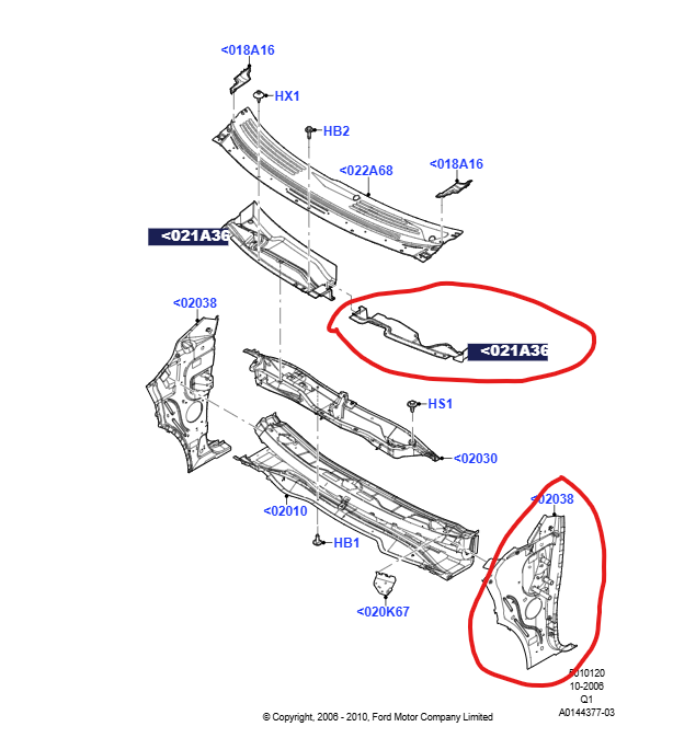

After taking out the wheelwell, yesterday, I am starting to think that this car was in an accident prior to us owning it.
Hint of an accident #1. I noticed that there wasn't any sound deadening foam in the fender. That is usually standard from the factory. The passenger side has it.
Hint #2: After referring to ford's crowl parts, it seems like it is missing a couple of parts. However, it doesn't list a hose in the schematic. Perhaps, it is part of the fender piece, which is the one on the bottom right in the pic below.
It is likely that the person that fixed it didn't bother to replace the hose or the other 2 missing parts.
Going to go up to a local ford dealership to talk to them about ordering these parts for me. They might share some insight on the hose.
