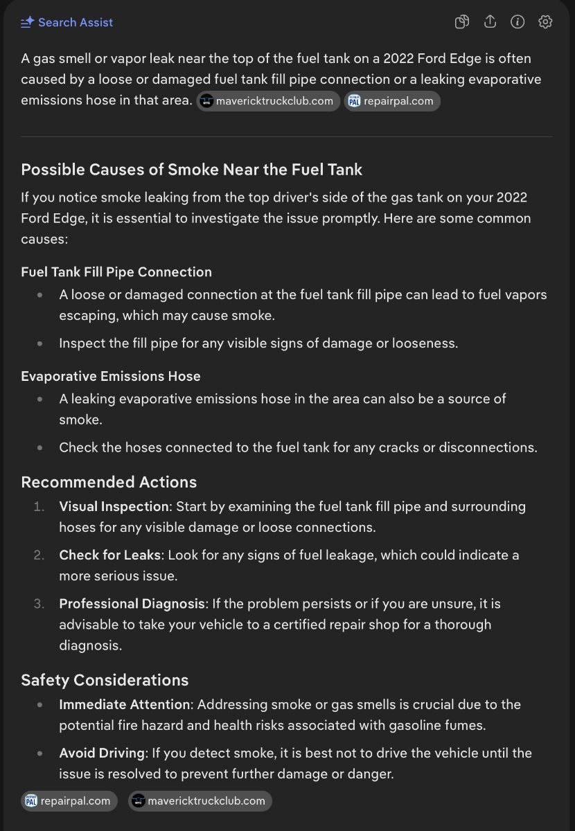

Mid-April the check engine light came back, same code, so I bought just the Purge Valve and replaced it, even though it didn't seem like the old (new) one was bad, then cleared the code and everything was fine, for a couple of weeks anyway, then the check engine light was back. A bunch of research later and I went to the next possible part and replaced the Vapor Canister Vent Solenoid in May. Unfortunately, that still didn't fix anything so I broke down and bought a smoke machine. I ran a test through the gas cap and found the smoke leaking from only one place, the top drivers side of the gas tank.
I have not dropped the tank yet as I don't have a lift and I'm not sure how to go about it in my driveway. The question is, could this possibly be something simple like the seal on the drivers side fuel pump is bad or could it be something more nefarious?
I've also noticed that the code doesn't show up when the gas tank is between 3/4 - full, only once it's below 3/4 does the code appear and pretty much every time I start the car.
Any ideas? I'm getting pretty tired of having to clear code anytime I get in the car.
