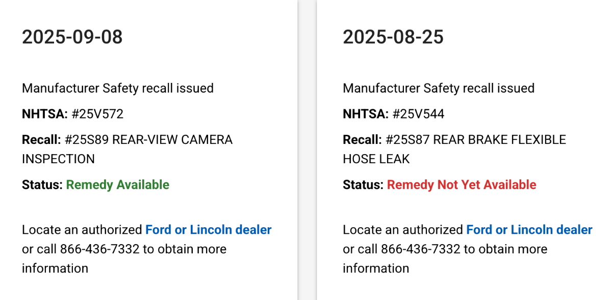

1004ron Posted September 6 Report Share Posted September 6 Carfax shows "Status: Remedy Not Yet Available". Could it be that the local Ford parts department has stock of the old hoses? Quote Link to comment Share on other sites More sharing options...
