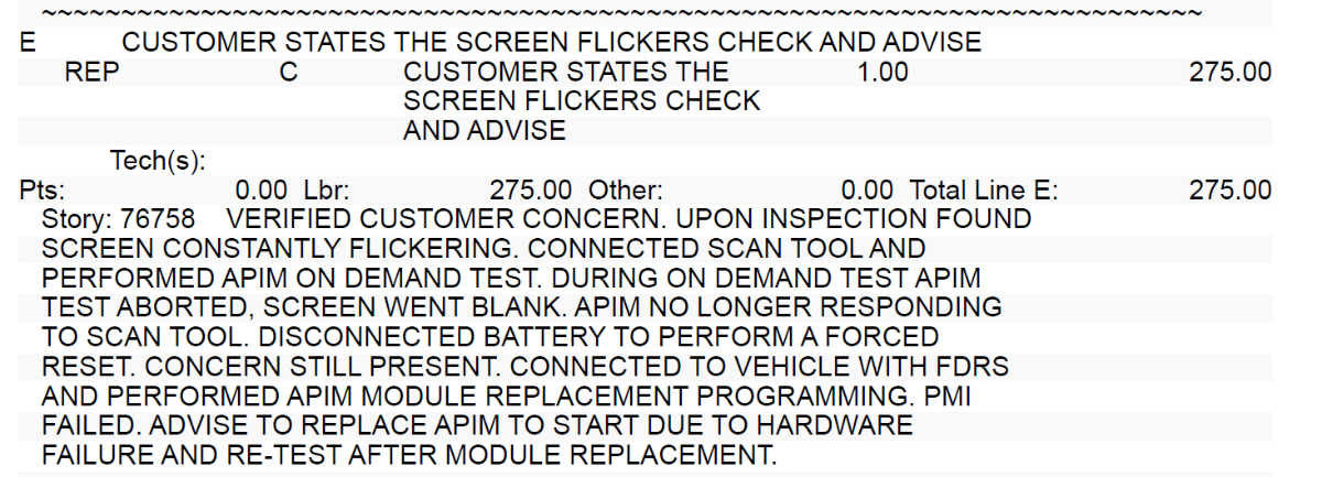

I brought in my 16 edge for 2 recalls and asked them to take a look at my flickering screen without realizing they don't even repair the screen, only the full apim with screen so I'm on the hook for 275 no matter what like a dummy for inspection.
Every vehicle function works including all screen functions, the only issue is the screen it self. Touch also works flawlessly. I thought it could have been a corroded cable to the apim as well as it seems it was cold based sometimes but now is just flickering all the time.
They want 700 for the apim and 1690 in labor.
Attached is what they sent me in an email after I asked for an email. Can I not use forscan to do this test and verify this my self? I don't have like Bluetooth dropouts or anything like that only screen flicker and I don't have the greatest vision so have the screen brightness even at night basically cranked so I assume I just wore out the screen from use.

So update, when the dealer did the self check on the apim it died completely apparently and never came back to life which wasn't mentioned in the report I attached but the manager called me after some back and forth emails on the price and time to fix etc and tldr they waived the diagnostic fee, I have the car back and it still needs one more recall (camera swap) but needs the apim functional to do it.
They have said if I can source my own apim they will put it in for $690. I want to verify I need this one?

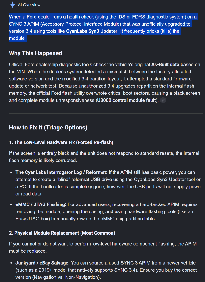

EDIT: so I thought about what you said above and it made more sense to be to dive deeper and uh yeah I think I have a bad screen and this is what actually killed the apim. fords software did not like what it saw and reformatted it in a way it was no longer able to.
