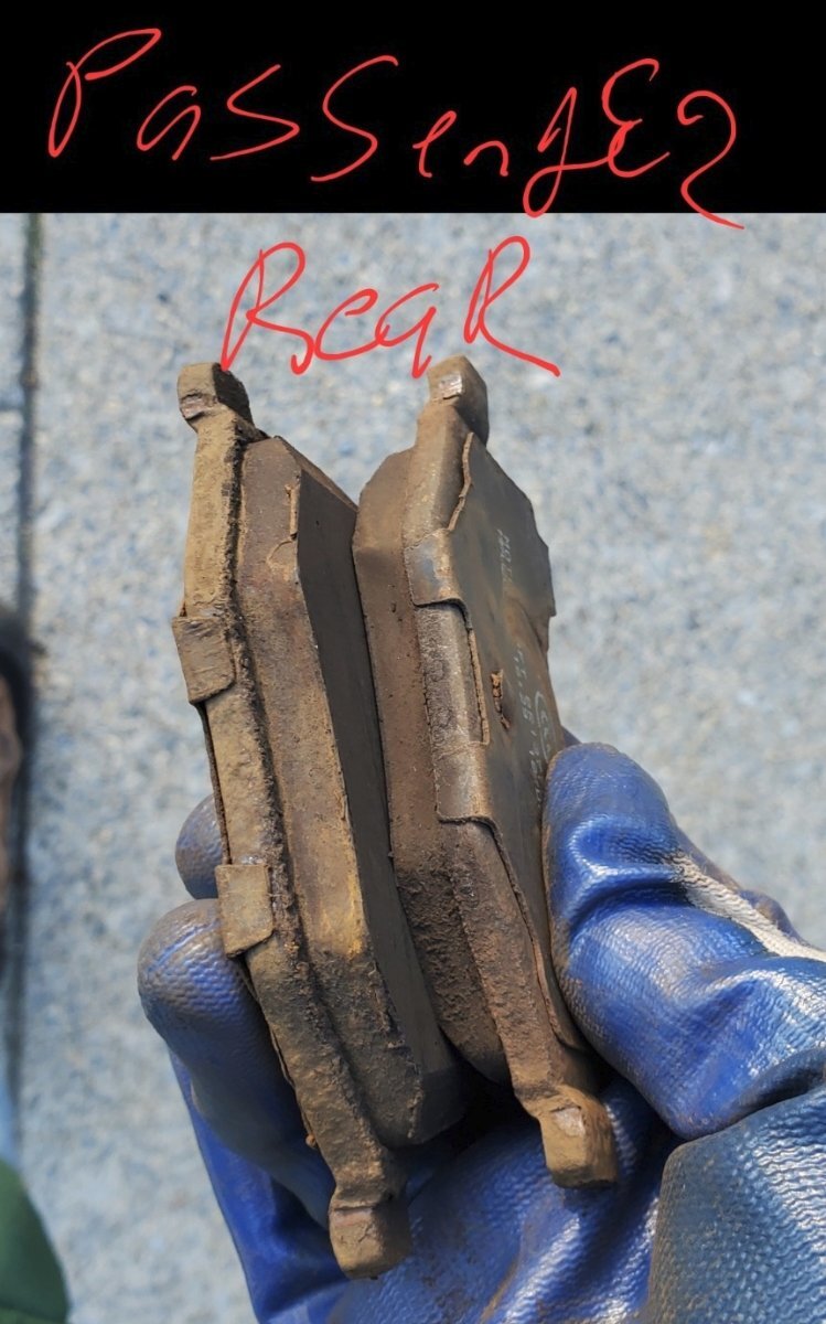

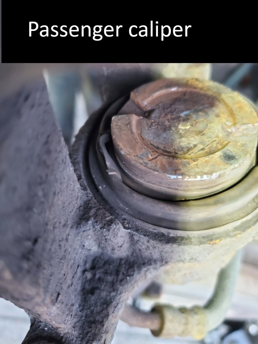

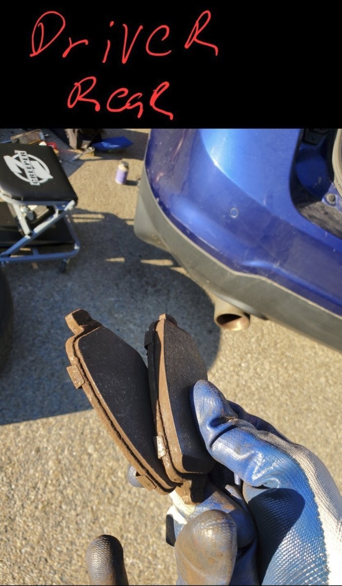

thesavo Posted October 10 Report Share Posted October 10 (edited) This is a 2014 Edge 3.5L SEL AWD with 161,000 miles. For the past few weeks we now there has been a "thump" noise that is in sync with vehicle speed. I can upload a video of the noise, but is is the sound of "thump","thump"-"thump"-"thump and gets faster with an increase in vehicle speeds up to highway speeds. We were late in to a road-trip when it started. We had a tire-shop rebalance the tires, no change in noise and frequency. The inward pad on the driver side was worn almost down to backing of the pad. The passenger side seemed to have even wear, however the piston was equally difficult to react as the driver and boot was torn up. I changed the rear calipers. The calipers were targeted as they needed an extreme amount of torque to spin the piston back into the caliper. I tried to bleeder trick to determine if it was a bad caliper or brake hose, by pumping up the peddle 4 times and cracking open the bleeder screws. They only dribbled out and I still needed way too much torque to spin the pistons back in. Now, having replaced the calipers, the brakes work fine, however the parking brake doesn't seem to hold as well. I'll work on that in another thread. The passenger side holds better than the driver side. The "thump" noise is still present while driving as slow as 2-3 miles per hour. There is no left-to-right or up-to-down movement when shaking the tires on either side. Before I reload the parts cannon with rear-wheel bearings, what further troubleshooting should I try next? Edited October 10 by thesavo grammar 1 Quote Link to comment Share on other sites More sharing options...

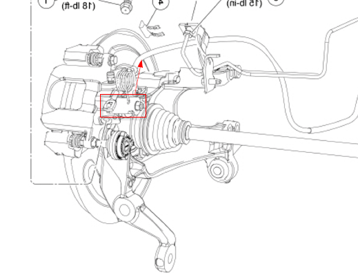

thesavo Posted October 24 Author Report Share Posted October 24 (edited) I have installed new wheel bearings and even with both wheels off the ground, they move much smoother than before. I also replaced the sway bar links, and the passenger-side wheel-speed sensor. (Buy an inductive heater if you don't have one. /Chef's_Kiss) I am still not sure if I have a defective replacement driver caliper or a cable issue as that side does not hold as well as the passenger side. The service procedure Pinpoint test says to 1. check for broken cable. (driver side cable shows no damage) 2. check for pad thickness (Brand new). 3. Brake pedal and control cable move when disconnected from the equalizer 4. Disconnect cable from caliper and move the cable in and out of the conduit. - yes - replace the caliper - no - replace the cable on the affected side. Also, I am able to move the parking-lever on the back of the driver caliper manually (no cable attached) to actuate the parking brake. The lever moves more freely and farther on the Driver side than the passenger. Again, no cable attached. The service manual shows no adjustment to be made here, only at the "equalizer" I did try to remove the nut holding the parking lever to the caliper, and tighten the inner bolt as shown on some performance calipers, but the lever stays on the pivot bolt. The Driver side cable seems to expose more of the center of the cable at "equalizer" when setting the parking brake. I seem to have conflicting symptoms Edited October 24 by thesavo 1 Quote Link to comment Share on other sites More sharing options...
