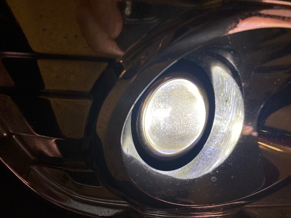

jasoneg Posted October 30 Report Share Posted October 30 My actual fog lights seem very pitted. I added LED bulbs, but they are still very dim, or maybe I should say they don't throw light very well. If I just turn the fog lights on at night in the driveway you cant even tell they are on. I tried polishing the lenses, but it didn't help. Is this just normal or should I just buy some new fog lights? The actual fog light itself, not the bulbs. Its an 08 Edge. Quote Link to comment Share on other sites More sharing options...

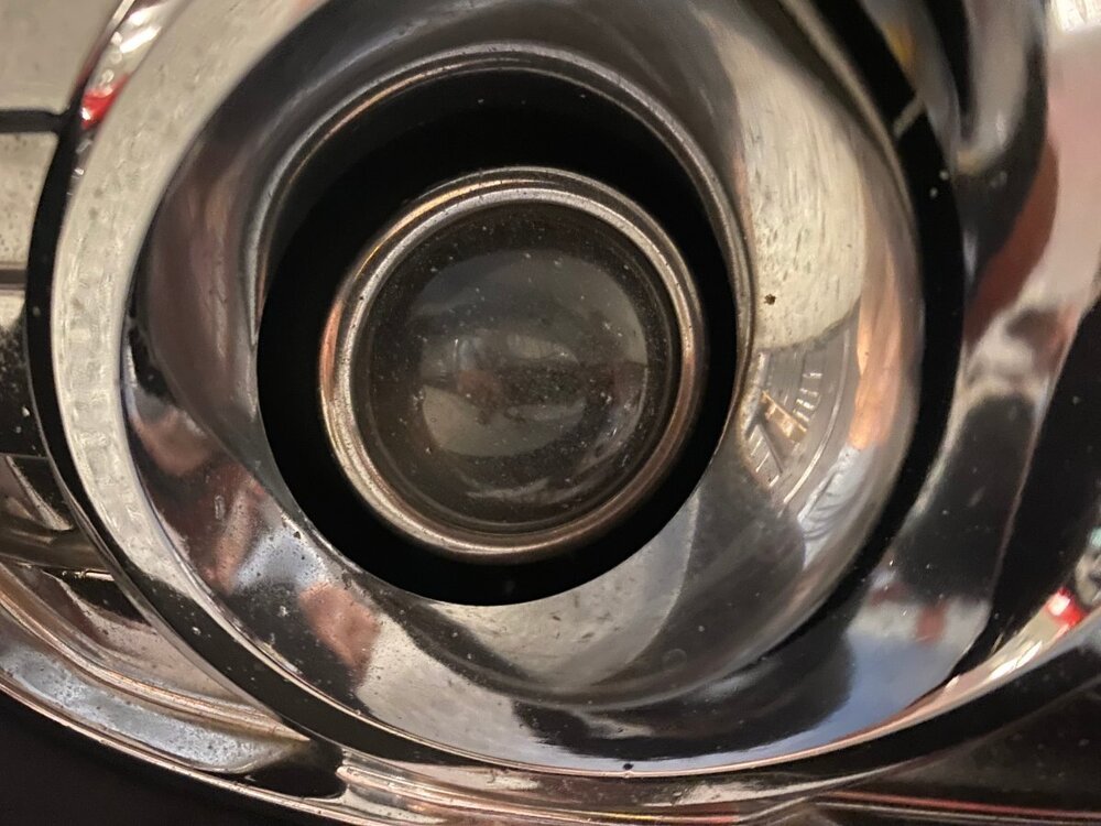

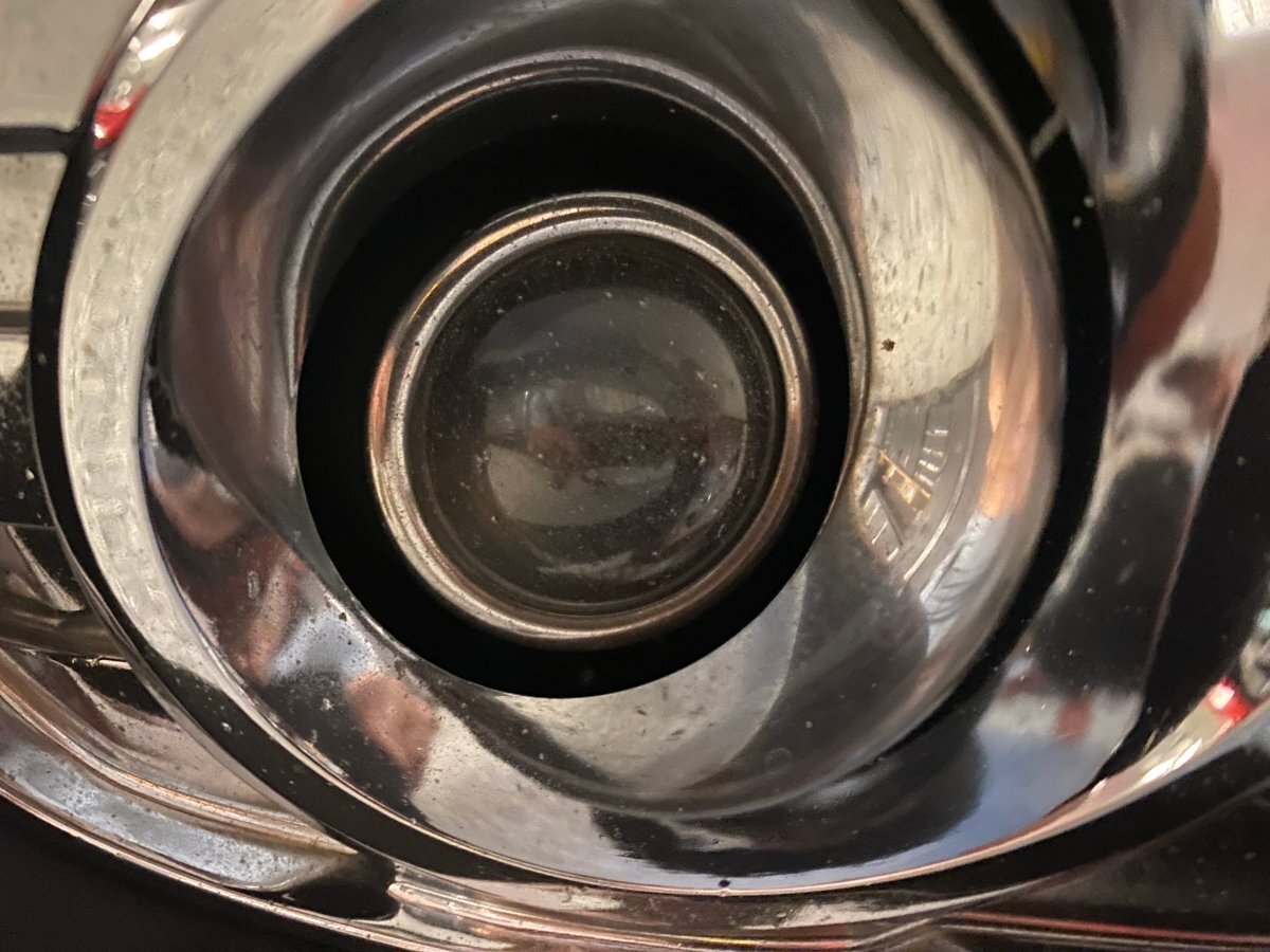

dabangsta Posted October 30 Report Share Posted October 30 (edited) They add a slice of light way down low that doesn't illuminate up high, they are effective fog lights. If you are going to keep the LEDs, you need to clock them correctly (turn them if they have that adjustment) to get the best light out of them. It helps to know how the projector fog light works. There is a slot the light goes across between the bulb and the lens: The projector lens actually flips the light (so any changes made to the slot or gate will affect it opposite, add a hot spot on bottom will add it to the top of the projected beam). Most of these I saw in the junk yard (when working on a project, that I abandoned as it was counter productive) were pitted (with them being low to the ground and not protected behind a lens like the headlight). The pitting on mine (mocking up some LED rings, which were actually brighter than the fogs, so I didn't finish it) is not quite as bad: Just the LED ring in, this is why I didn't go forward with it (you can see the halo in an artifact way up high): With fog light on, compare no halo with halo. This is what a non focused non projected light would look like, not a good fog light at all: What that non shaped (by fluted lens, projector beam, capped and reflector, etc) low power LED looks like: Edited October 30 by dabangsta 1 Quote Link to comment Share on other sites More sharing options...
