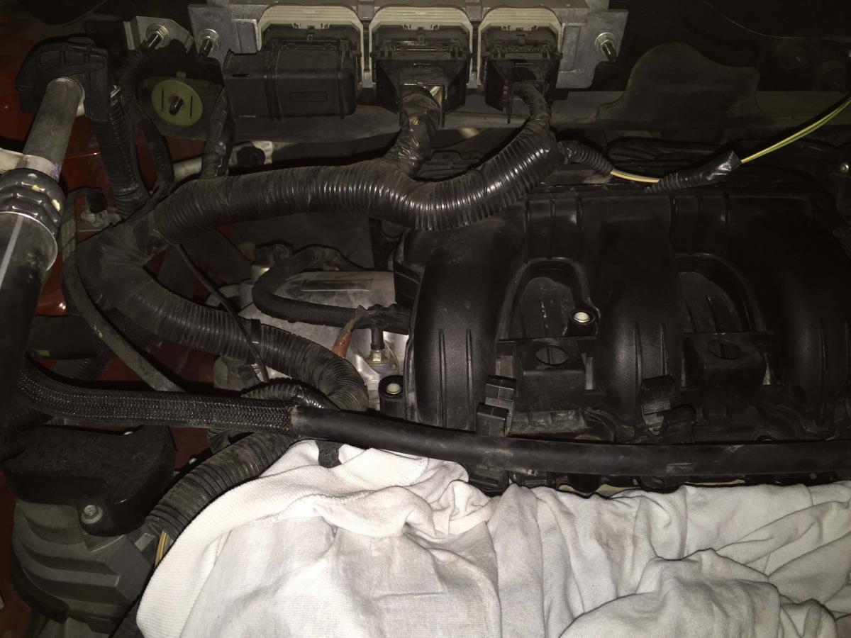

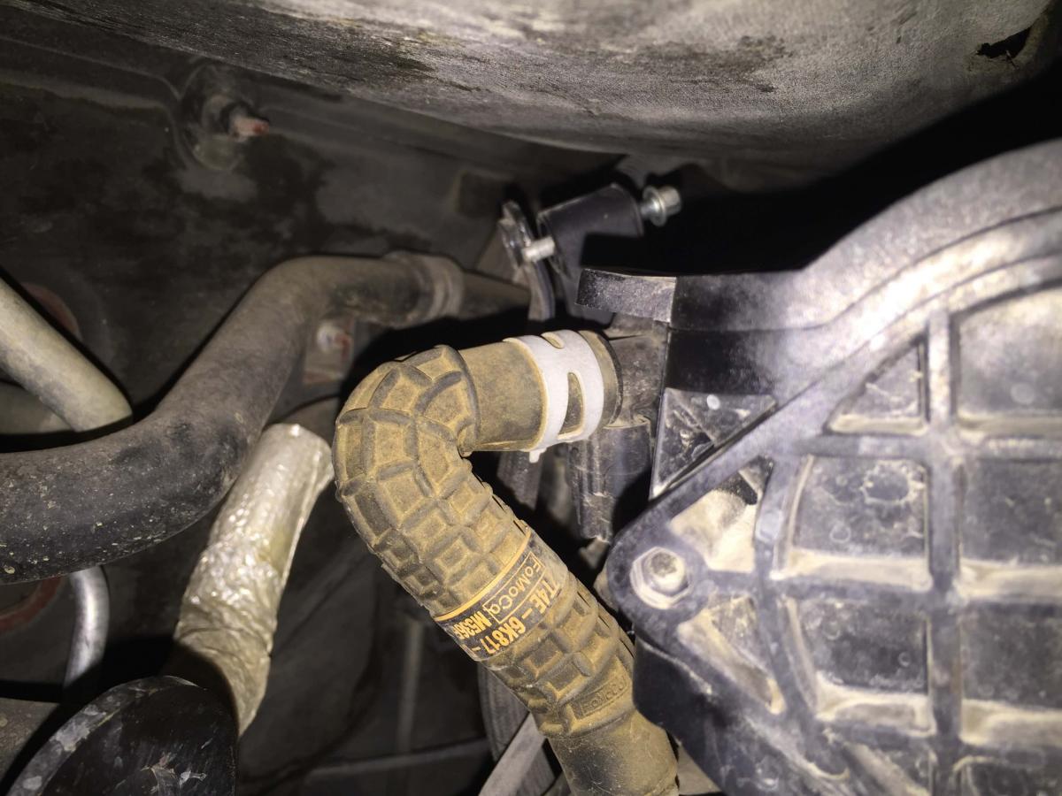

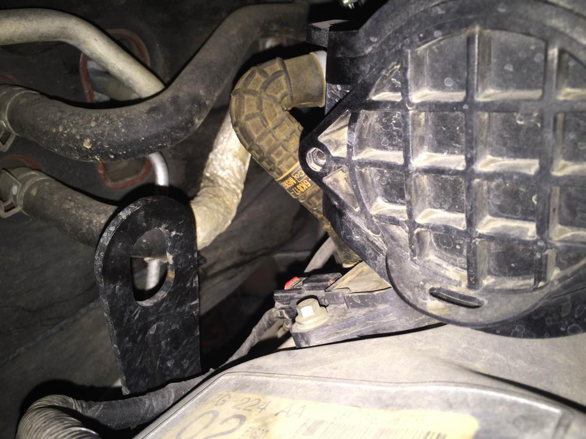

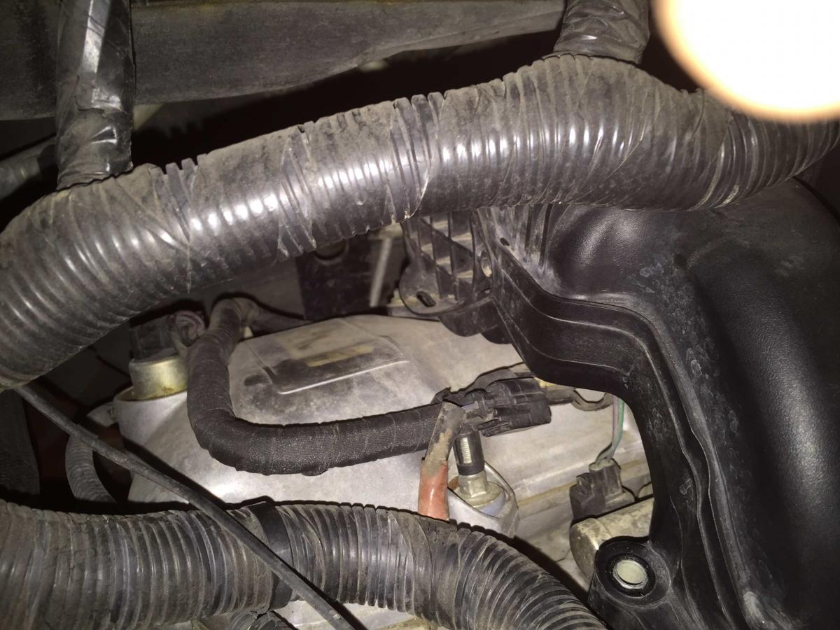

mrtm2016 posted a topic in 2007 Edge & MKX
I watched this video to guide me along the process of DIY spark plugs changes... I get all the way to removing the cover off the engine itself and it seems that he assumed maybe somewhere along the way I would figure out something on my own. At the back of the cover itself is a 90 degree bent house with what appears to be a metal casing around it. The top of the house is clamped to the the back of the cover unit and the bottom presumably goes into the engine. He didn't seem to detail it in the video (maybe I had a few too many beers and missed it?) or my Edge is just special. I doubt my car is special, other than the fact it seems to just be a piece of work. Attached is a series of pictures starting from the top, moving to the left side of the cover, and a closeup of the hose at the back, hopefully to show y'all the exact position of the hose. THANK YOU IN ADVANCE. Can anyone guide me with how to properly detach this house to get the top casing off so I can change the back three spark plugs? Much appreciated, thanks so much. -
