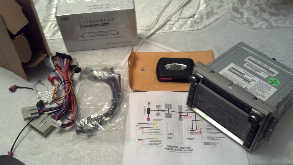

  2. Purchased from OEM Auto Parts Co. the OEM Navigation Unit $1600 http://www.oemautopartsco.com/factory-oem-navigation-radio-clarion-p-30239.html This also included the BRICK KIT (not shown in attached picture), which is a wiring harness that allows the unit to interface with the vehicle that was originally equipped with the standard radio. BRICK KIT also included new steering wheel buttons specific to NAV, and a required amplifier. We provided OEM our VIN and they programmed the unit for our vehicle (more on that later)
  3. Purchased from OEM Auto Parts Co. the LockPick kit (see picture). This may be of interest to someone who has the NAV unit originally. By default, certain features of the unit are Locked out when the car is being driven. Watching DVD's is one of them... entering a NAV destination address... this kit (another maze of wires and harness connections) overrides this lock out, so that all features of the unit are available all the time... so yes, we can watch DVD's while driving. $285

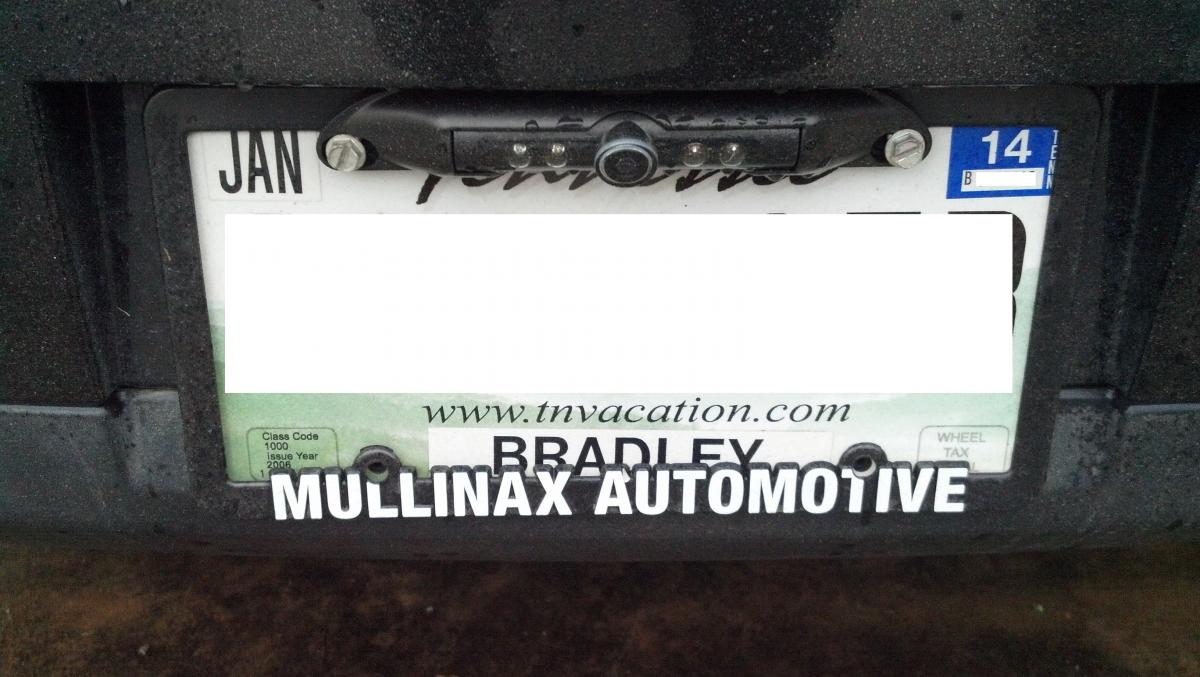

Here is a shot of the rear camera installation. No visible wires... I really don't know how they routed the wires, but all I know is I can't see them.
