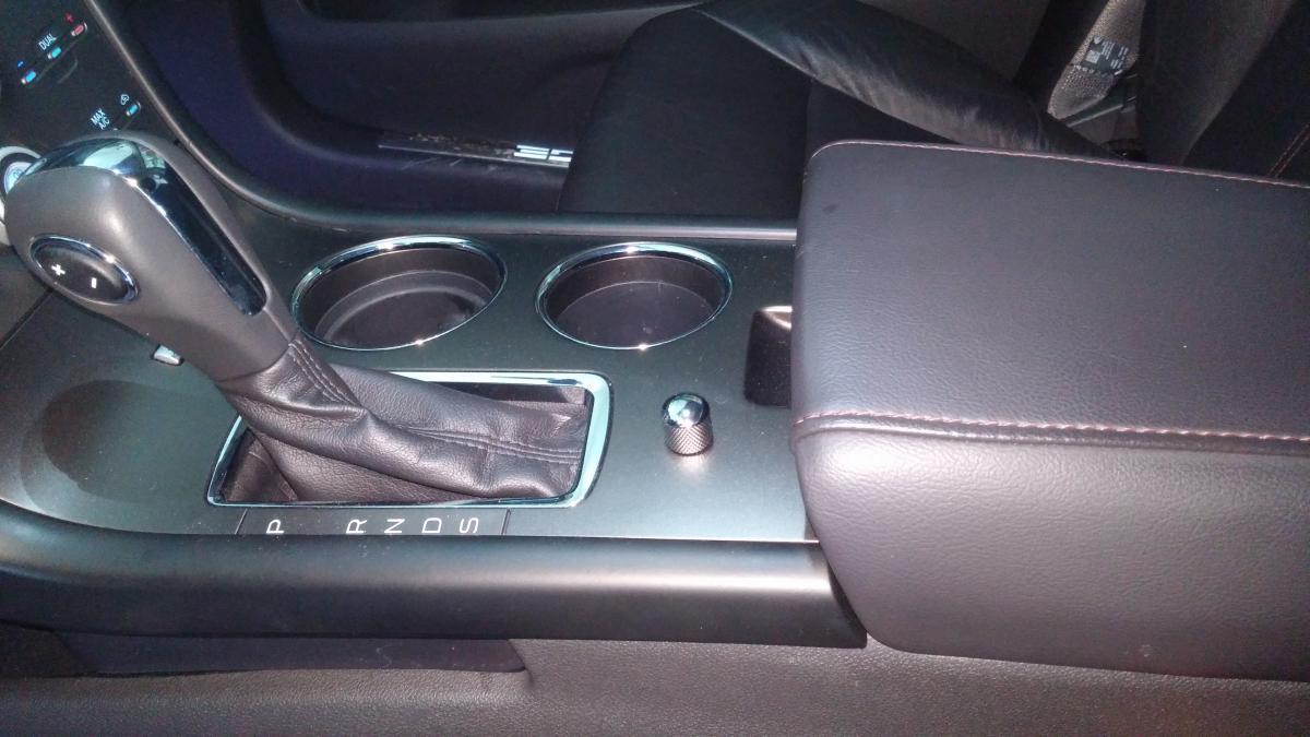

Been a while. Since I got my Edge, one of the things that bothered me the most was that the center console was so deep and dark. Last week I solved that problem. I tapped into the power of the 12V outlet on the back of the center console (continuous power) and using a reed magnetic switch along with a strip of 3 led lights I purchased at AutoZone, I now have a lighted center console. Hook up the switch as normally closed.
