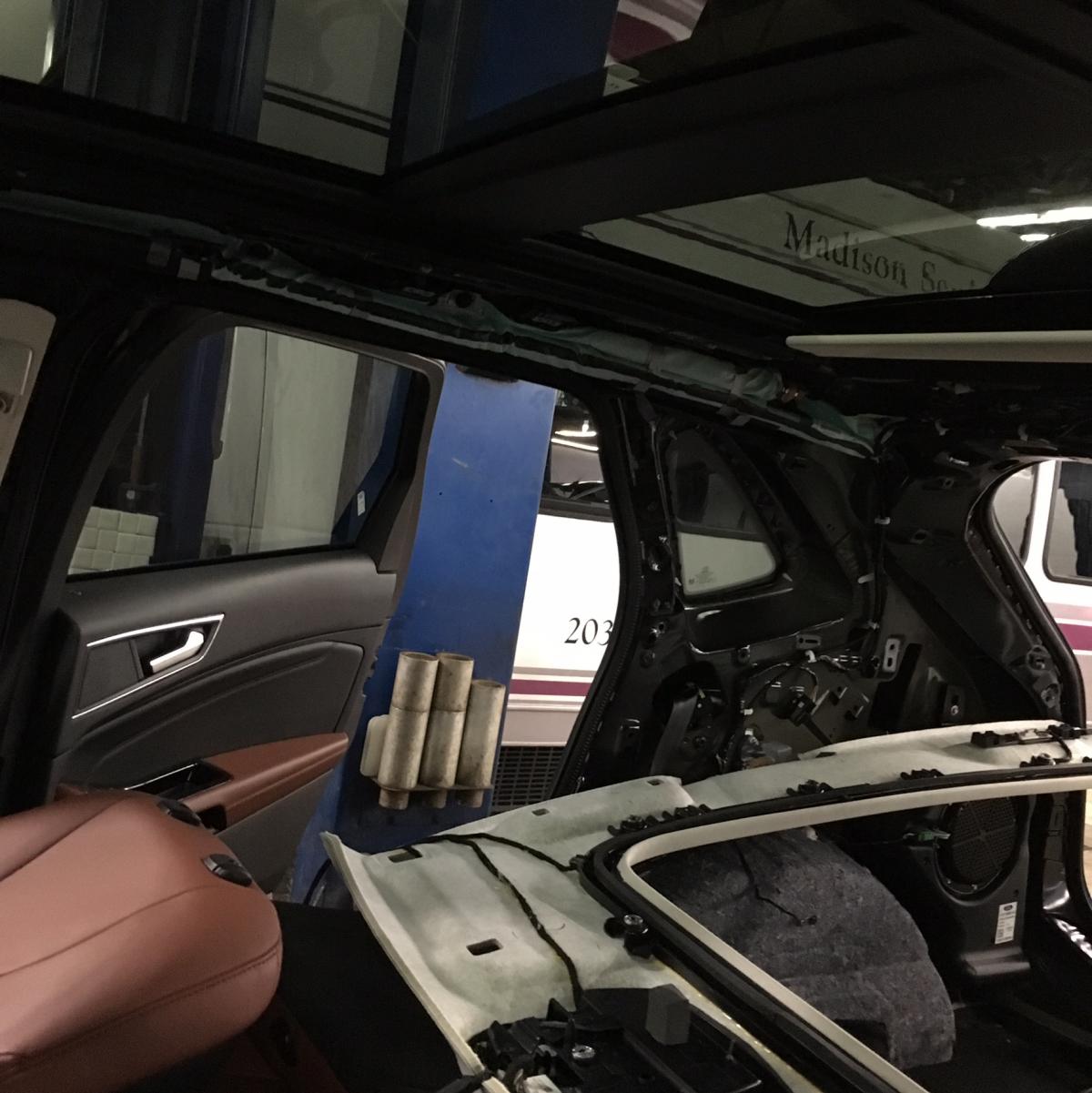

Pardo714 Report post Posted February 22, 2016 I have the rattle in the headliner as well. Took it into the dealer they ordered parts for the top plastic pieces they put them in but still hear the rattle. They called and said they wanted to drop the headliner. I'm supposed to get it back tomorrow. I went to get something out of it and took some pics I'll try to post them. Share this post Link to post Share on other sites

Pardo714 Report post Posted February 27, 2016 Got mine back the other day. While I will admit it's is better, it's not completely gone. They seem to have taken care of the rattle on the drivers side but the one near the rear hatch is still there and getting worse. I'm convinced it's the magnets in the headliner. When they had the headliner off I moved the magnets back and forth and it's the same sound. I tried to tell them but I guess it went unnoticed. My service provider did state to me that this was step one. So I guess it has to go back again. Share this post Link to post Share on other sites
