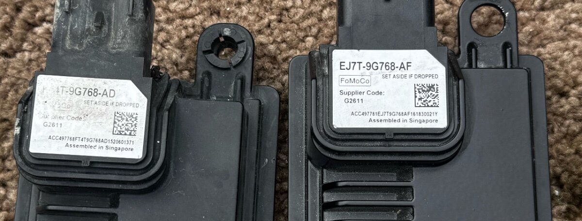

omar302 Posted August 22 Report Share Posted August 22 On 8/20/2026 at 6:07 AM, gjkrisa said: can any one help me figure out how to update the vin? top photo is new working c-cm from a mkx. second smaller photo is my oem c-cm module. my vin is 2FMTK4AP3FBC40639 5LMTJ3DH5HUL21198 this is the mkx vin I have re-read your post and noticed that the VIN you posted for the vehicle if the new CCM is actually a Lincoln MKC, not MKX. The MKC is totally different, maybe the CCM is not compatible regardless of loaded software and calibration. 1 Quote Link to comment Share on other sites More sharing options...
gjkrisa Posted August 22 Report Share Posted August 22 might be right as i can not find where it said the one i bought was the upgraded part. here is oem next to used mkc. they seem very close so i believe i had the right info. Quote Link to comment Share on other sites More sharing options...
gjkrisa Posted August 22 Report Share Posted August 22 ok searched EJ7T-9G768-AF on ford.com says only works for mkc i do think this is reason. Quote Link to comment Share on other sites More sharing options...
