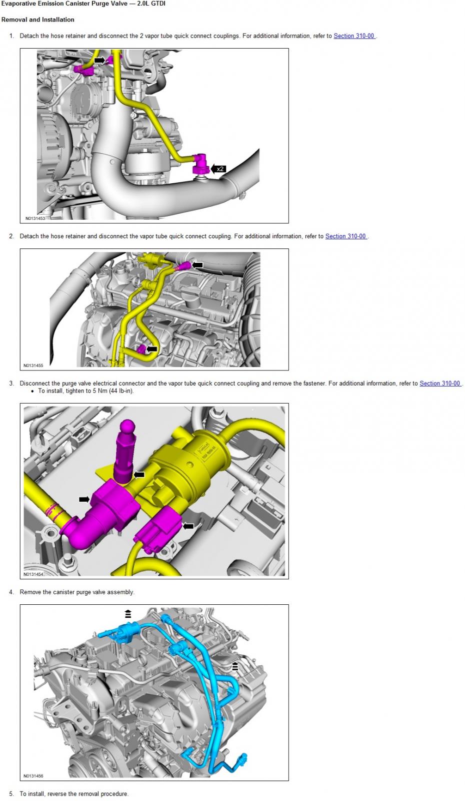

WWWPerfA_ZN0W Posted May 4, 2018 Report Share Posted May 4, 2018 (edited) There is a purge valve I think, but Ford probably lists it as a "hose assembly". Seen that a LOT lately. On the 3.5 EB, you can actually find the purge valve as a separate part. But on smaller engines, assemblies are much more common. Edited May 4, 2018 by WWWPerfA_ZN0W Quote Link to comment Share on other sites More sharing options...
Dave33 Posted May 4, 2018 Author Report Share Posted May 4, 2018 Thanks for the reply and diagram. I guess it's called a canister vent solenoid and not a purge valve and It's about $100. I'll have to have the system smoked to see if I can find a leak. I don't want to throw parts at it at that price. If it were a $25 purge valve I would take the chance. Quote Link to comment Share on other sites More sharing options...

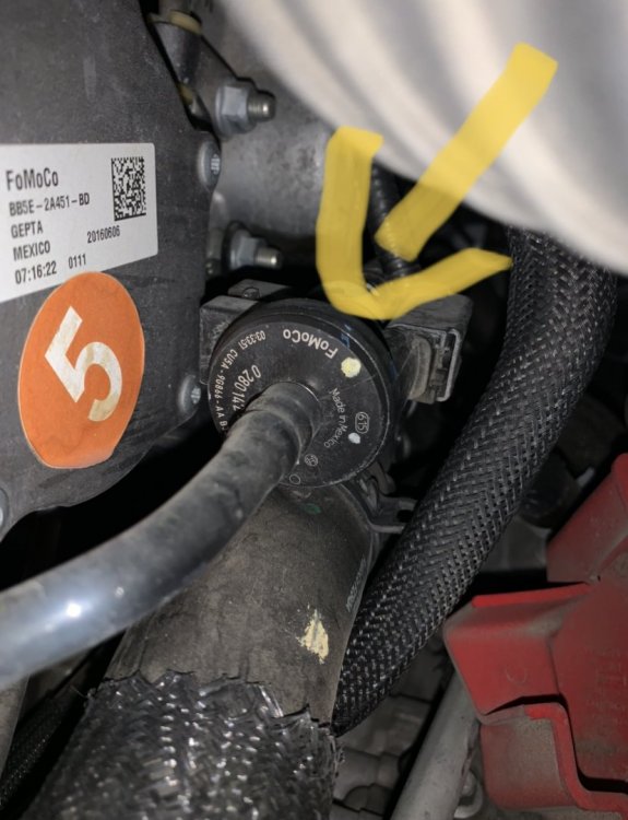

WWWPerfA_ZN0W Posted June 20, 2018 Report Share Posted June 20, 2018 the vent solenoid valve is underneath the vehicle, the purge valve is at the firewall. Which one did you replace? Quote Link to comment Share on other sites More sharing options...
Dave33 Posted June 20, 2018 Author Report Share Posted June 20, 2018 I replaced the assembly from your picture above which was the valve and all the hoses. It comes as a complete assembly. Quote Link to comment Share on other sites More sharing options...

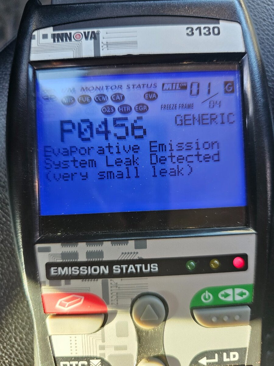

Lawry13 Posted March 24 Report Share Posted March 24 I have had a P0456 code problem since December. In January, it was smoke tested and determined that the issue was the fuel filler hose. Had that replaced and the code was gone for a month. Check engine light came back on. Repair shop couldn’t find any leaks. They had the software updated and it was good for three weeks. Check Engine Light came back on today. 1 Quote Link to comment Share on other sites More sharing options...
nathang86 Posted June 3 Report Share Posted June 3 My 2021 takes a few tries to start after fueling. ($10 in gas, 2 or 3 tries; full tank 5 or 6 tries) I am scheduled to take it to the dealer on Friday but if it's something simple I could do it myself. Any suggestions? There is a check engine light. Code P0456 1 Quote Link to comment Share on other sites More sharing options...
