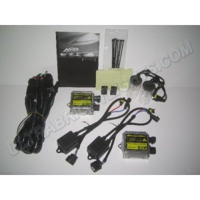

I just replaced my factory headlights with McCulloch Xenon 4300K HID Conversion Kit.
True HID light for my new Copper 07 Edge SEL.
Installed in less then 10min, and boy what a difference at night.
How about some more info. Where to buy, pictures of what they look like????
I am interested, too Da Edge!! More info
I was able to find them thru a local seller on Craiglist in Los Angeles. These are also available in most Car Accessories shops. They have many different brand, and one of the best are the ones I purchased.
You can also try ebay and search under McCulloch HID Xenon.
The Plug and Play kits come with all parts needed, and super easy to install. You do need to change the fuse that controls the headlights from 15 to 25 to handle the HID lights.
I will post pictures soon, as my camera sucks big time and I am purchasing a better one this week.
That doesnt look just plug and play. Looks a little more detailed than you made it sound? There are some wires there. Could you maybe give us a write up on what exactly you did.
It sounds like a bunch of us are interested.
Thanks.

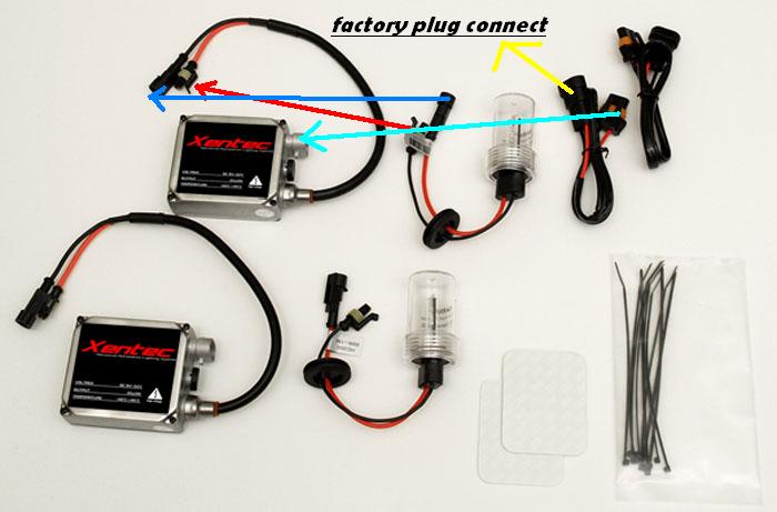

Ok here it how I installed them. I used a larger image from a different brand that consists of the same hardware type.
The Yellow arrow points to where the EDGE's headlight connector goes into.
One thing to keep in mind is these kits are not street legal. They are sold for off-road or show use only.
If you go above 6000k then yes, they are not street legal. The ones I purchased are the ones used for Audi and BMW which are rated at 4300K.
8000K and above are too blue and 10000K + are purple which are pretty much not legal.
