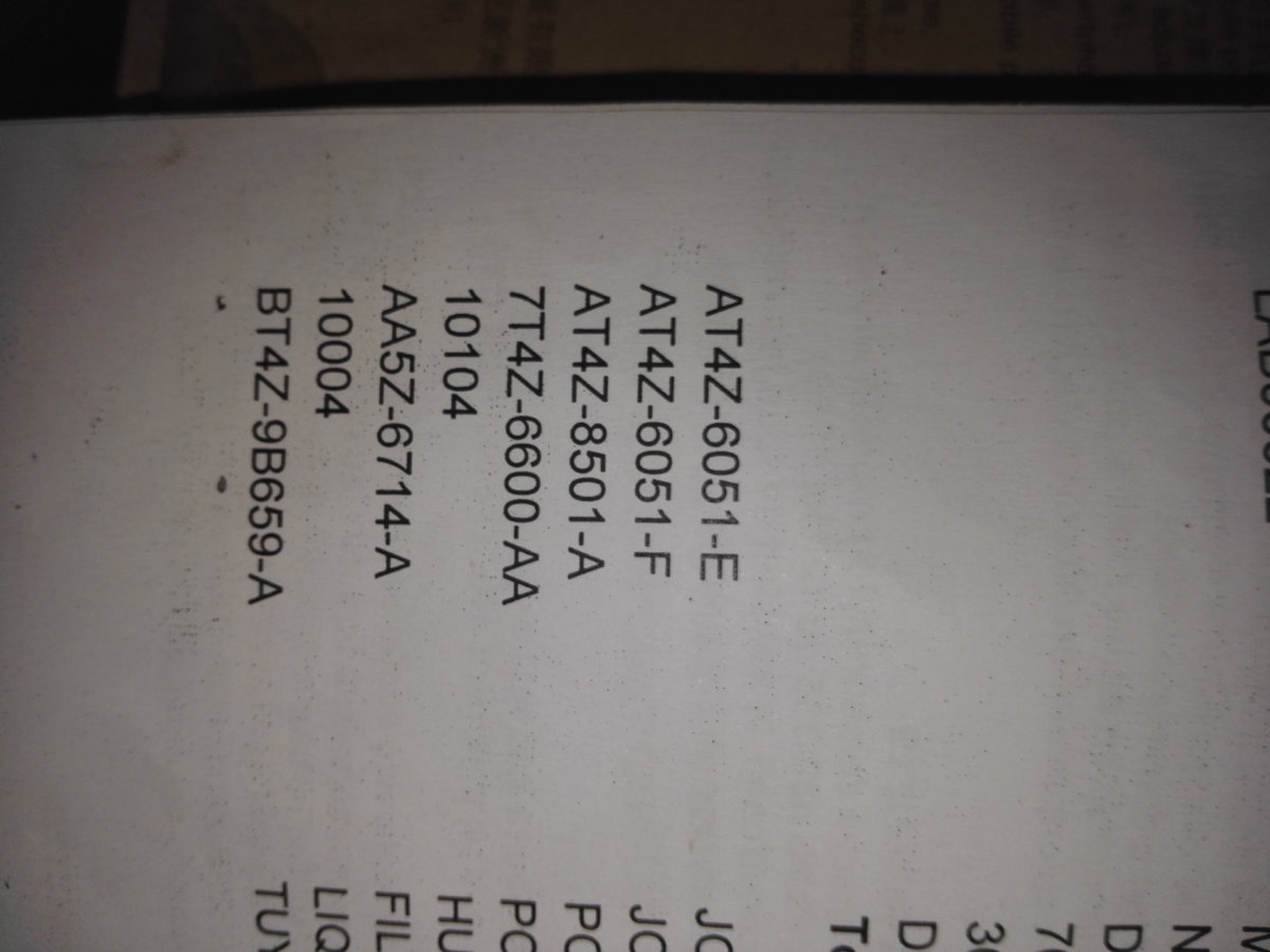

That's your air intake tube.  If it's broken then it likely means you've been getting dirty air into the engine (air is coming in after the air filter).  This could cause damage to your throttle body or air flow sensor which could confuse the engine enough to cause it to stall.
Rockauto.com probably ships to your area.  Some U.S. based Ford dealers do as well.  Benny at LevittownFordSuperCenter.com can certainly assist with that if you cannot order directly off their website.  Throttle bodies for Gen 1.5 are relatively cheap compared to those for Gen 1, so you are in "luck".  They are not exchangeable between the Gens.
