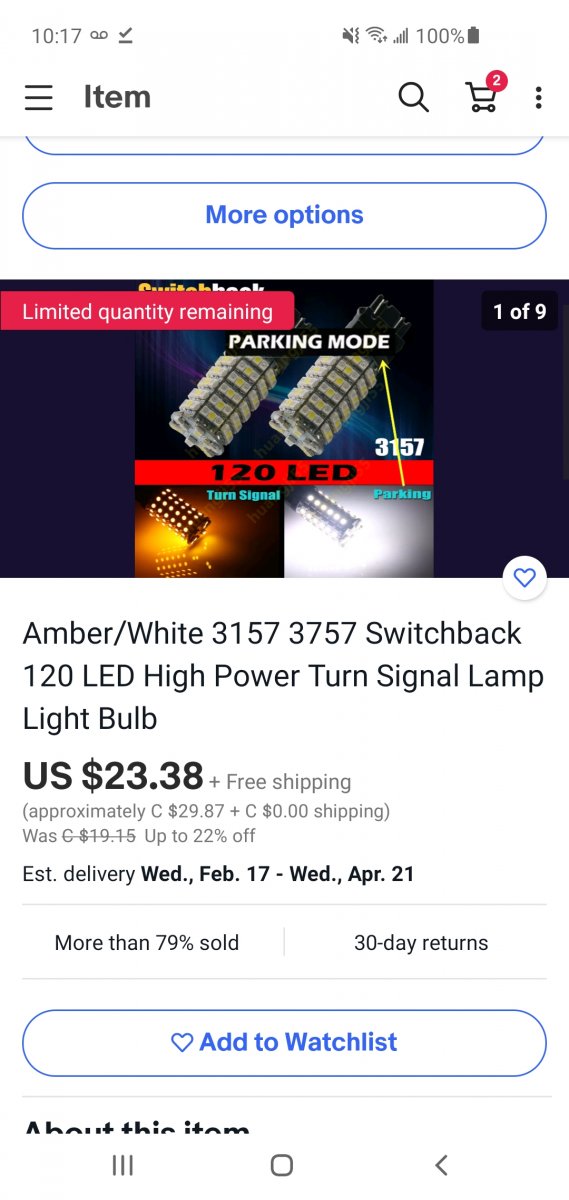

I've purchased these bulbs
https://www.amazon.ca/dp/B0756B3T1D/ref=cm_sw_r_cp_apa_i_1J757VJ1502PV6TWVCTM
And these resistors
https://www.amazon.ca/dp/B01N3OXYTN/ref=cm_sw_r_cp_apa_i_F55WJX1G3VDA970WYA6V
So these bulbs and resistors worked perfectly together! No issues at all with these new bulbs and resistors. I also upgraded all my cabin lights to LEDS as well as rear turn signals and reverse and brake lights! headlights I am upgrading to HID due to the factory halogen projectors, HID seems to work better in them instead of LED. If anyone would like links to all the lights I purchased for my 2013 ford edge limited let me know and I'll put them in here.
