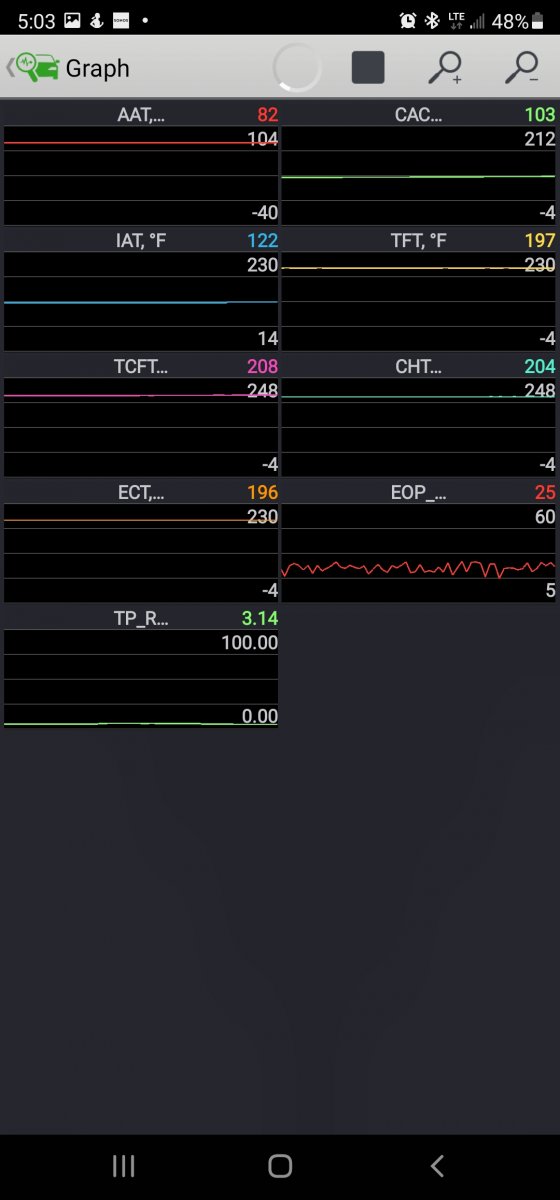

I have Forscan and like to pull data from sensors, that in some cases I didn't even know existed.. like the "transfer case temperature sensor".
Since the 2.7 has no oil cooler in the edge but it does in the F150, I started wondering about oil temperatures and oil pressure at normal operating temperature.
Specs say that minimum oil pressure is 30psi @ 1500 rpm at temperature.
Well the ambient temp hit 85 today so I checked my oil pressure when I got home from work and found it to below spec. Only about 25psi at 1500 rpm. Not horrible but not great. At idle, it dips into the lower teens. I've seen 12 or 13.
So, I really want to install a coolant to oil cooler but it is not practical at this time. I also want to put in the cooler thermostat but have no place to do work due to lease restrictions where I live..
So I'm considering fattening up my viscosity by doing 3x 5w-30 and 3x 5w/10w-40 at my next oil change which I will do early just for the viscosity and oil pressure concern.
Can anyone come up with any good reasons not to do this?
Also of note, the warmest sensor while idle cooling when I got home was the so called transfer case fluid temperature was around 208.. higher than I would have expected for sure.

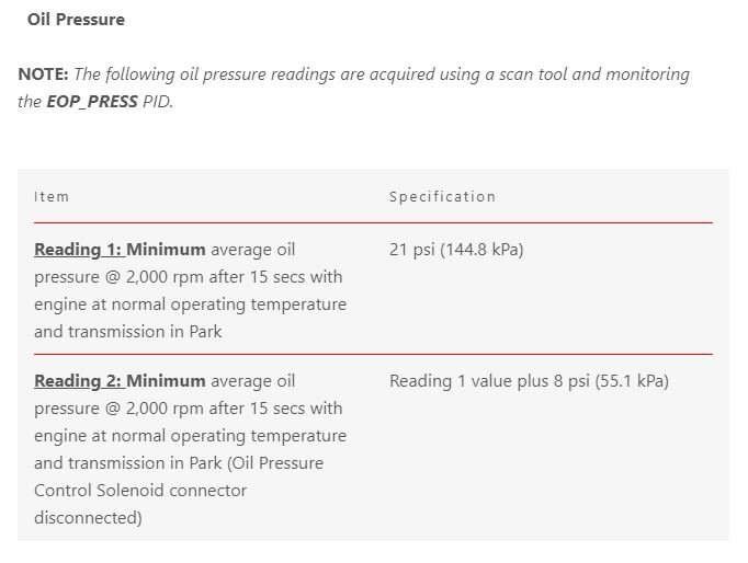

There seems to be some conflicting info out there - what's your source of that spec?
https://www.sparkyexpress.ca/blogs/auto-blog/fluid-types-and-capacities-2019-ford-truck-f-150-2wd-v6-2-7l-turbo

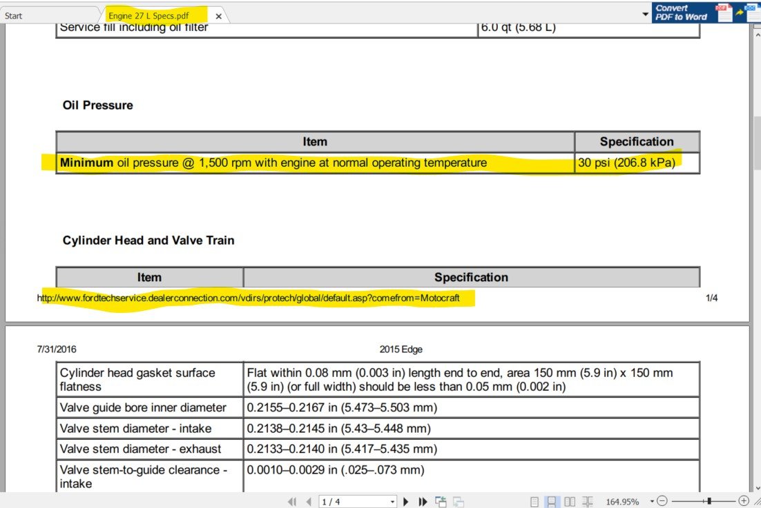

the source is a digital Ford Service Manual in PDF format.
you notice below it is specifying valve stem &  bore diameters
