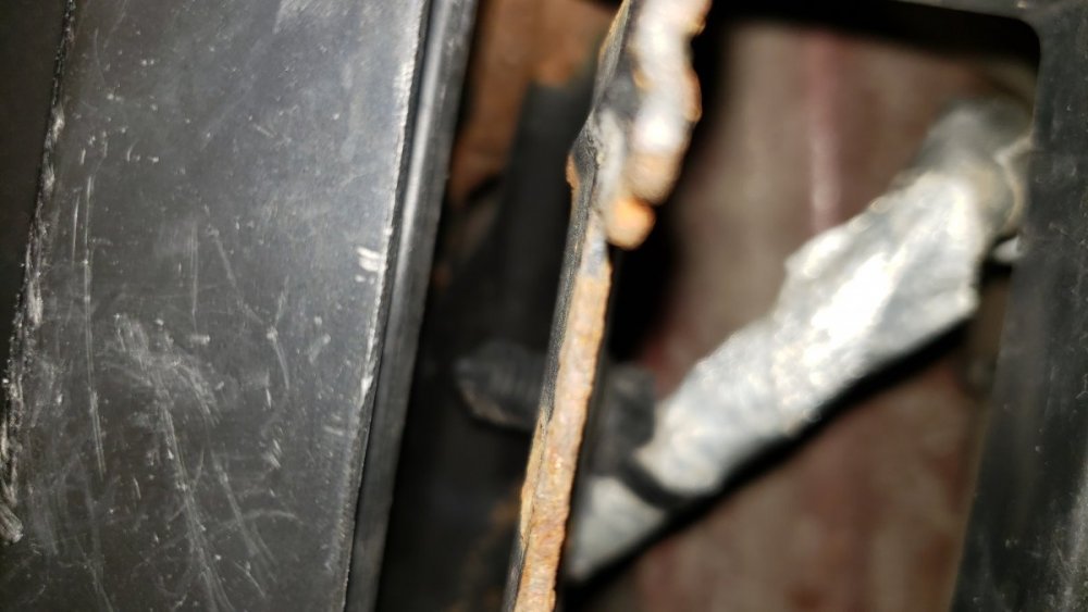

Recently bought a 2016 SEL AWD that included Ford's trailer towing package. But I looked under there and do not see a trailer wiring plug. I do see a wire up in the bumper, but it seems fixed and I'm guessing it has something to do with either the collision or parking sensors.
Did Ford include trailer wiring? I find it odd that they would include the hitch, but not the wiring harness.
The pic is what I see from below

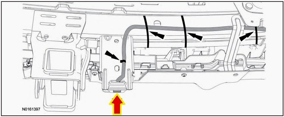

...which, in this illustration looking from underneath and toward the back, slides into a bracket attached to the factory-installed hitch (yellow-outlined red arrow)...
2016 Edge Factory Trailer Wiring Connector - View from beneath looking toward rear.jpg

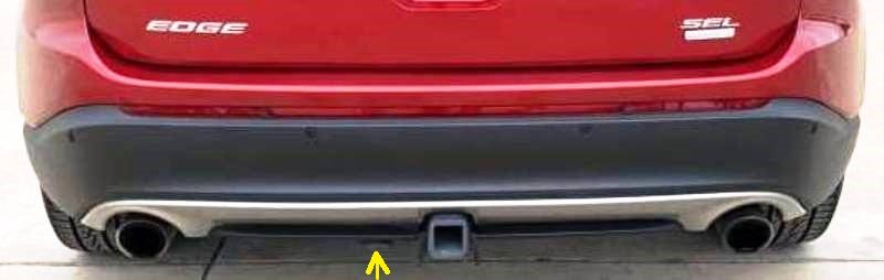

...with the connector visible just beneath the rear valance panel to the left of the of the 2 x 2 receiver box (yellow arrow) on these of 2016 Edge SELs...
