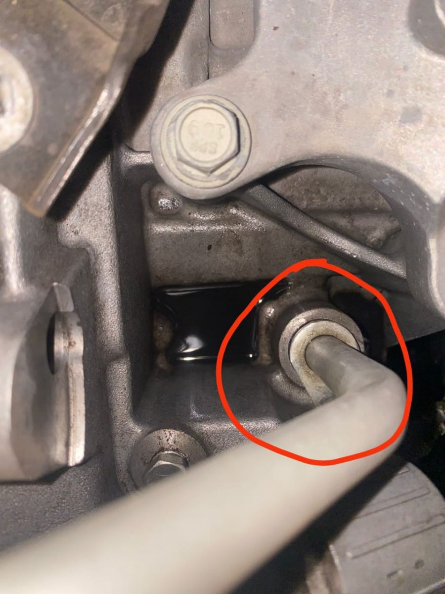

My 2017 Ford Esge SEL started to leak all the transmission
oil at 51,000 KM.
Has it happened to someone?

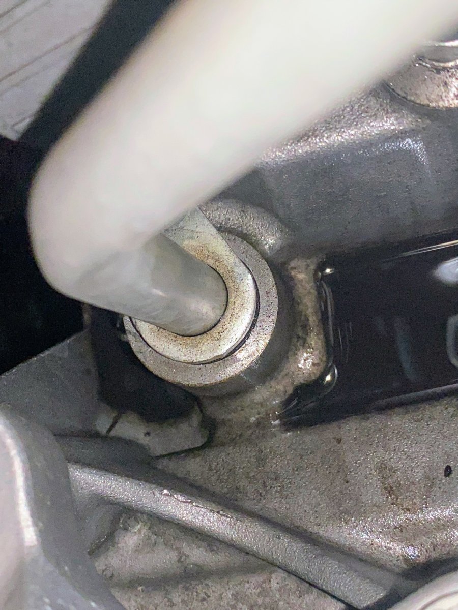

I assume the oil leaking is coming from the o-ring in the oil pipe.
im going to the dealer the next week (Monday) , and text here what they say me about this.
Edited by Wolfx771

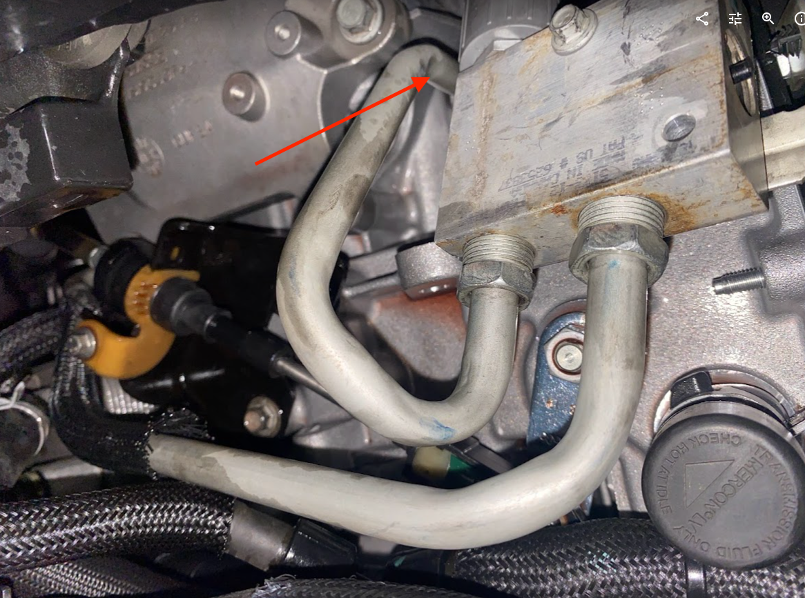

After the adjustment they gave me the vehicle again and now I have slippage problems in the box, through FORSCAN and an ODB2 reader I can see that the box operates between 100°C and 110°C
According to the official FORD manual, it indicates that the transmission fluid must operate between 85°C and 93°C.
At the moment I am in the dealer writing this post, I am waiting to be told what is happening, I am almost sure that the oil must be black and burned.
I think I have a problem with the cooler or with the bypass valve.

Some have an Edge 20017 Ecoboost that can validate with OBD2 or Forscan if the transmission fluid operates at 93°C or more?
In the attached diagram, you can see all the pipes that the transmission has, I touch all the pipes ant he are all hot except the number 1, it is cold. This test I doit whit the fluid transmission at 100°C.

Is any one know that I can delete or remove the thermostat that come inside of the bypass valve?
I live in Costa Rica whit temperature like 30 Celsius. And right now my transmission works at 100 Celsius all the time included at idle, I think this thermostats is not working correctly, so for safety reasons I want to remove.
is this possible?
