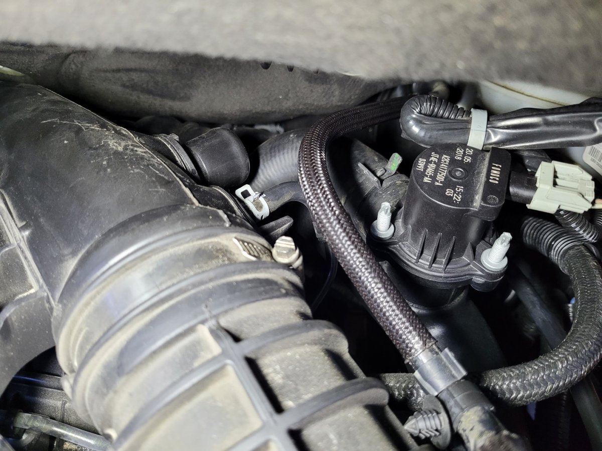

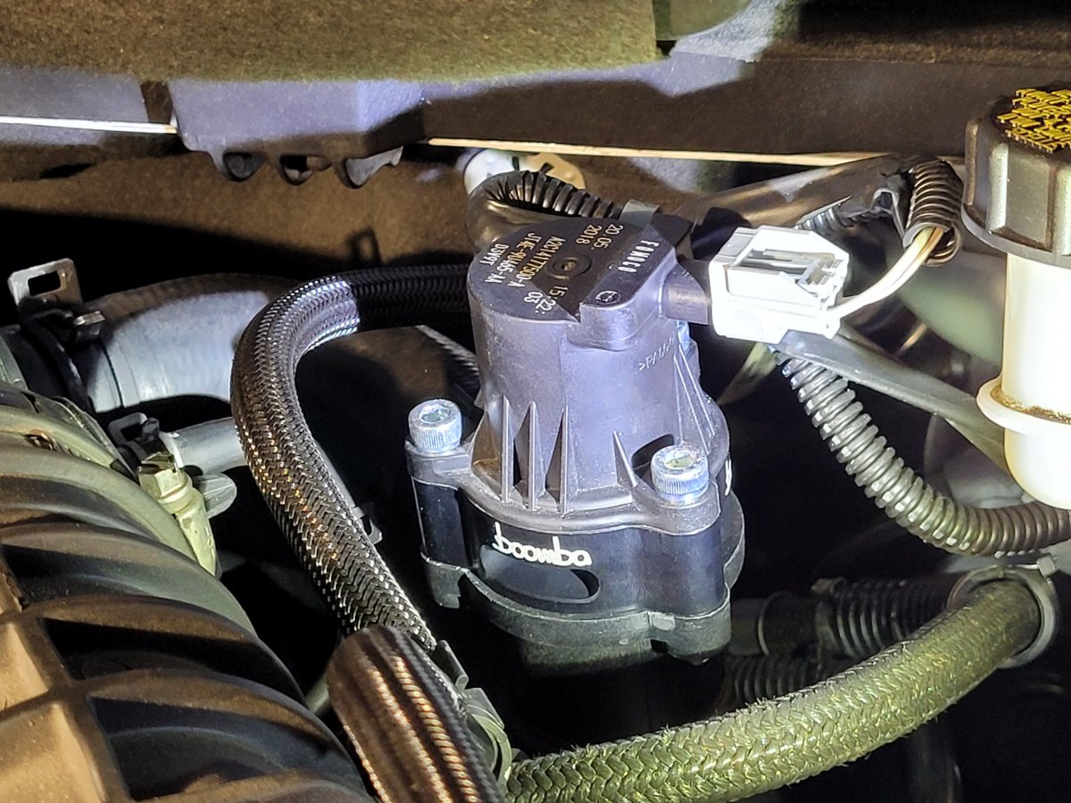

itsnotdustin Posted August 31, 2021 Author Report Share Posted August 31, 2021 (edited) I got the Boomba BOV adapter installed. Before pulling it out of the package I thought that the design of the adapter would allow for a pathway for unfiltered air to go into the intake. So before installing it I just set up a DIY vent to atmosphere that didn't require the adapter but served the same purpose. All I did was disconnect the bypass valve hose from the intake side, clock it downward a few degrees, and capped the intake. Taking off the bypass valve made it easy to get to the hose clamps. It accomplished what the adapter did with stock parts just by leaving the hose open. Once I took the Boomba BOV adapter out of the package I realized it did NOT leave any pathway for unfiltered air and the install was easier than the DIY setup and it looks cleaner. Edited August 31, 2021 by itsnotdustin 1 Quote Link to comment Share on other sites More sharing options...

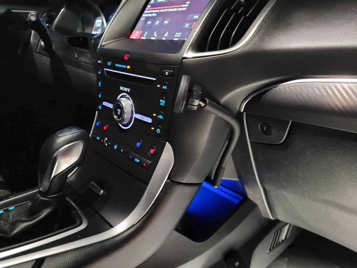

itsnotdustin Posted August 31, 2021 Author Report Share Posted August 31, 2021 I also installed the Cravenspeed phone mount while I was at it. The car just doesn't have enough general storage to put a phone in while driving. 2 Quote Link to comment Share on other sites More sharing options...

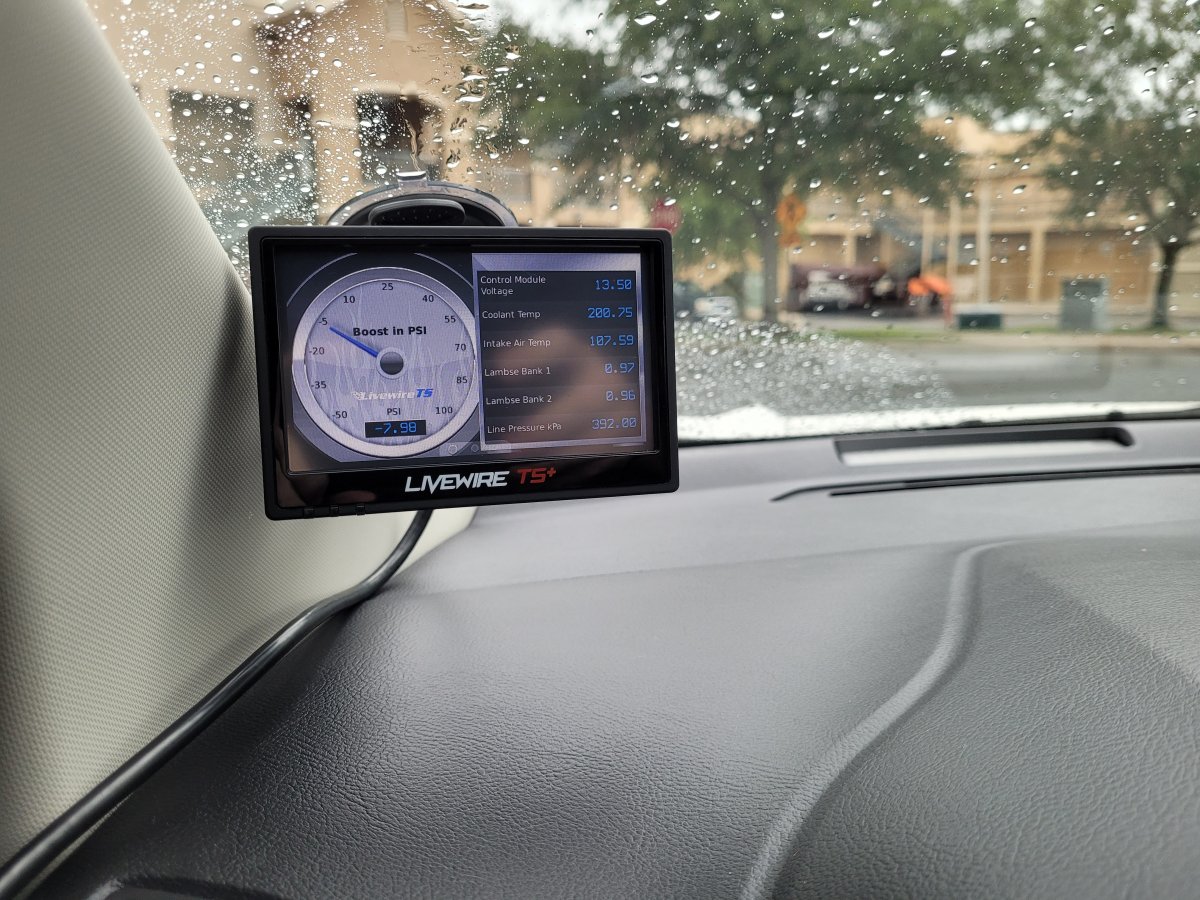

itsnotdustin Posted September 1, 2021 Author Report Share Posted September 1, 2021 (edited) I got the tuner delivered and installed. The Livewire TS+ is better than I remember it but the touchscreen feedback is still pretty bad since it uses old resistive touch screen tech. It's nice having the gauge readouts so I can see just how bad the factory intercooler is. Coolant temps stay around 200 no matter the driving so I know the radiator works better than the intercooler. Otherwise, everything else seems in check. I went with Unleashed Tuning and the experience has been pretty seamless. A few short and sweet emails to Torrie and I had my tunes loaded and ready to go. Initial impression wasn't very remarkable. I definitely get pushed into the seat more in the lower gears, but the higher gears feel only moderately better. With that said the vehicle is completely stock and I know mods and some datalogging will go a long way. Once the intake, exhaust, and thermostat are install I will be datalogging and fine tuning to get the most of it. In the meantime, does anyone know any easy path to route the obd2 wire for the tuner? I may just leave it unplugged most of the time since I don't want the wire hanging around. Update - I noticed there was an access panel to the left of the steering wheel. On previous years it was a small storage drawer. Either way I knew it would be a great place to run the wire and mount the tuner without having to drill holes or pop big panels off and risk breaking anything. The mounting position turned out great and the wire stays bundled behind the panel and run through the hole where your hand goes. All I had to do was stick on a suction cup mount disk. Edited September 6, 2021 by itsnotdustin 1 Quote Link to comment Share on other sites More sharing options...
itsnotdustin Posted September 1, 2021 Author Report Share Posted September 1, 2021 (edited) 24 minutes ago, sdpupillo said: Welcome aboard! Car looks great and like the direction you headed. I wanted to acquire stock 21" wheels for my sport, but the stock 20" are growing on me. Especially with the wider variety of tires available. Congrats on the new car! Thanks! Edited September 1, 2021 by itsnotdustin Quote Link to comment Share on other sites More sharing options...

onyxbfly Posted September 2, 2021 Report Share Posted September 2, 2021 On 8/30/2021 at 9:15 PM, itsnotdustin said: I also installed the Cravenspeed phone mount while I was at it. The car just doesn't have enough general storage to put a phone in while driving. You have a great eye for photos! If you're not a photographer you may have missed your calling. 2 Quote Link to comment Share on other sites More sharing options...

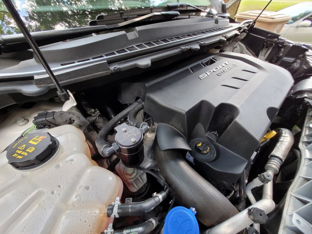

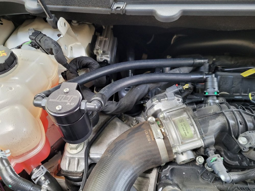

itsnotdustin Posted September 3, 2021 Author Report Share Posted September 3, 2021 (edited) JLT catch can came in today. The fit and finish on it was perfect. Install was so easy. Edited September 3, 2021 by itsnotdustin 2 Quote Link to comment Share on other sites More sharing options...

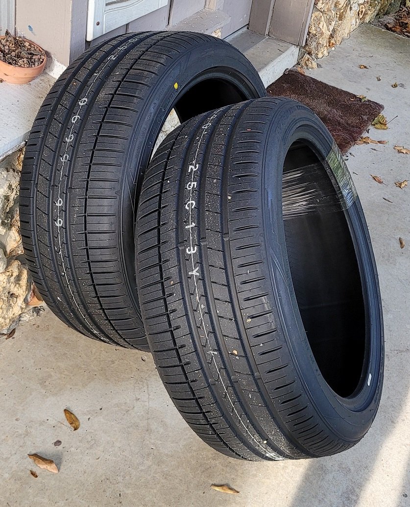

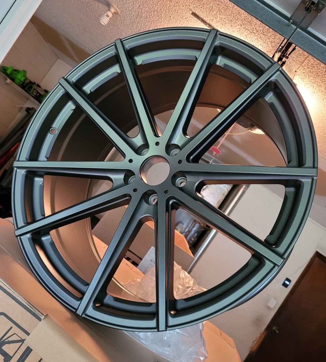

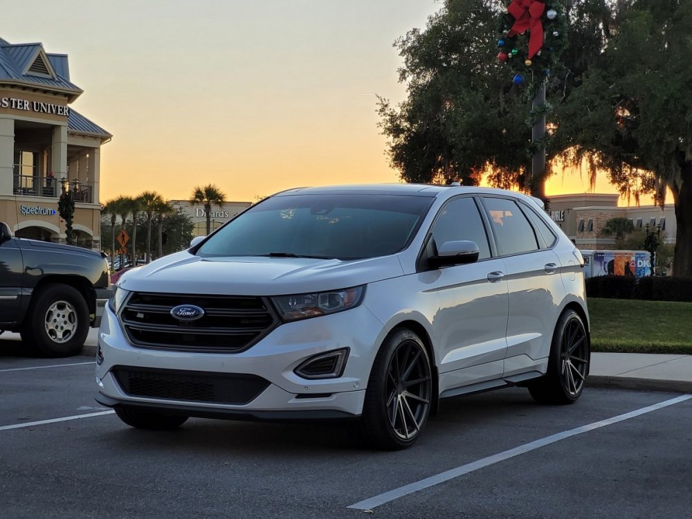

itsnotdustin Posted September 8, 2021 Author Report Share Posted September 8, 2021 (edited) The wheels and tires got delivered. I'm going to test fit for wheels for backspacing clearance first then will go get them mounted up by this weekend. I will get some better pictures loaded eventually. Edited September 8, 2021 by itsnotdustin 1 Quote Link to comment Share on other sites More sharing options...
onyxbfly Posted September 9, 2021 Report Share Posted September 9, 2021 My Precious........ Seriously tho.. those wheels look sharp!! Quote Link to comment Share on other sites More sharing options...

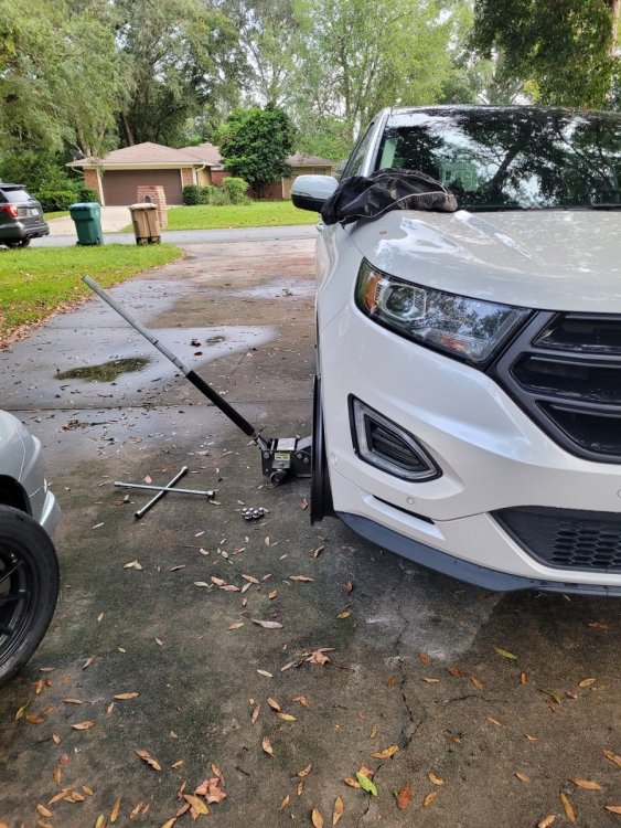

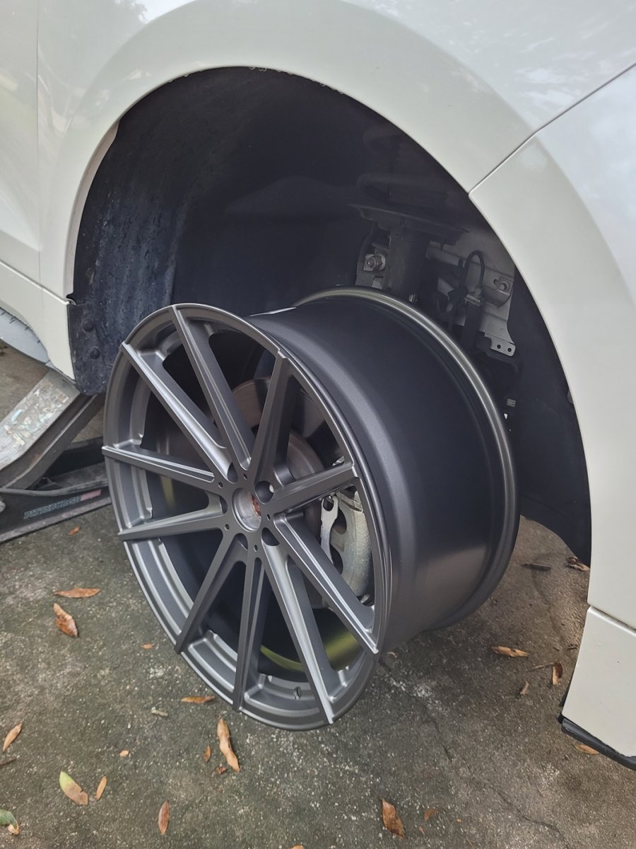

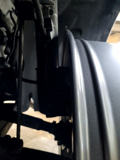

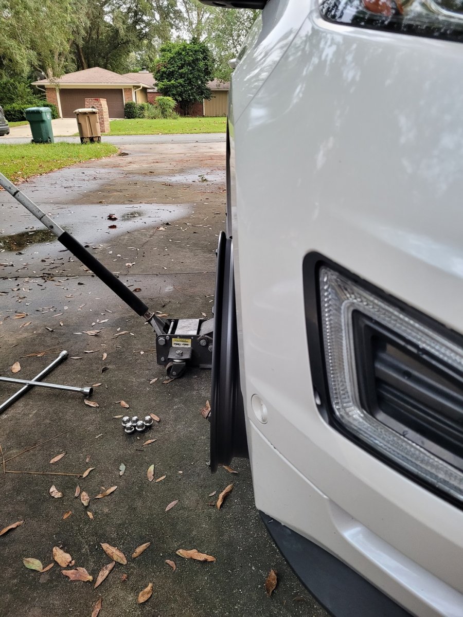

itsnotdustin Posted September 9, 2021 Author Report Share Posted September 9, 2021 (edited) Educational post: The test fit didn't go as expected. While the backspacing seems to be close but perfectly fine, the wheel might be sticking out of the fender by a small amount. I will do another test fit with the suspension loaded to get an idea of where the fitment will be with the car on the ground. It's hard to tell how it will look with a tire mounted. Wheel Size - 21x10.5 Offset - +45mm Backspacing - 7.5" I tried to find other examples of what the wheels will look like and this is the closest I could find which looks good in my opinion.....but I dont want to mount my tires and not like the look considering they arent returnable at that point - Edited September 9, 2021 by itsnotdustin 1 Quote Link to comment Share on other sites More sharing options...
Special_K Posted September 9, 2021 Report Share Posted September 9, 2021 1 hour ago, itsnotdustin said: Educational post: The test fit didn't go as expected. While the backspacing seems to be close but perfectly fine, the wheel might be sticking out of the fender by a small amount. I will do another test fit with the suspension loaded to get an idea of where the fitment will be with the car on the ground. It's hard to tell how it will look with a tire mounted. Wheel Size - 21x10.5 Offset - +45mm Backspacing - 7.5" I tried to find other examples of what the wheels will look like and this is the closest I could find which looks good in my opinion.....but I dont want to mount my tires and not like the look considering they arent returnable at that point - Damn, looks like a +35 would have been perfect! Quote Link to comment Share on other sites More sharing options...
itsnotdustin Posted September 9, 2021 Author Report Share Posted September 9, 2021 2 hours ago, Special_K said: Damn, looks like a +35 would have been perfect! After looking at the other Edge with 22x10.5 wheels, I'm going to give these another test fit. The other Edge's fitment looked good and while the offset wasn't listed....it has to be close or the same as what I have. If it doesn't work out, I'll have to swap to the 21x9. It'll be a guaranteed fit but its out of stock for a couple months. Quote Link to comment Share on other sites More sharing options...

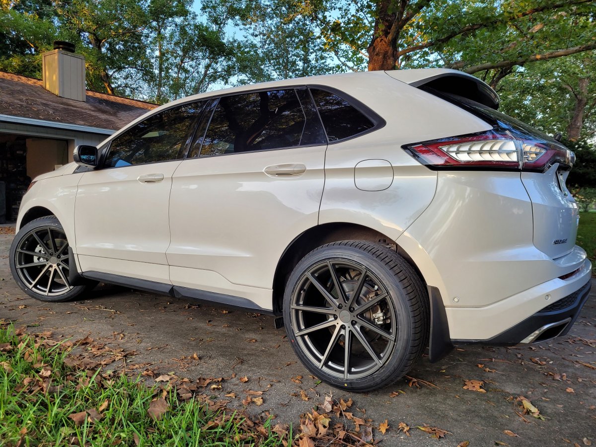

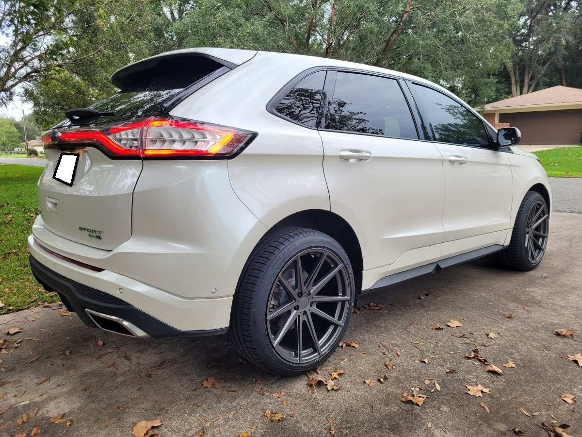

itsnotdustin Posted September 12, 2021 Author Report Share Posted September 12, 2021 (edited) I decided to stick with the wheels and had the tires mounted. The wheels are pretty flush with the fender and overall the stance is aggressive but not overdone. The 10.5" width wheels makes the car look planted. the 265/40's have a slight stretch but looks great on the car. Overall completely stoked on appearance. The backspacing is tight but has 0 interference. I felt no discernable difference in ride quality. Edited October 4, 2021 by itsnotdustin 3 Quote Link to comment Share on other sites More sharing options...

onyxbfly Posted September 14, 2021 Report Share Posted September 14, 2021 I see what you did there. No pun intended! Stance is on point! You're in Florida! Its easy to understand and appreciate your view on ride-ability and comfort with stretched tires etc.. I'm in Philly where the highways are slightly better than most streets and that's subjective to what part of Philly you're in. Two benefits of having abysmal street conditions is: one rarely rushes through Philly because the streets can eat your wheels and tires alive and you actually save gas. Great pics! Quote Link to comment Share on other sites More sharing options...
itsnotdustin Posted September 14, 2021 Author Report Share Posted September 14, 2021 1 hour ago, onyxbfly said: I see what you did there. No pun intended! Stance is on point! You're in Florida! Its easy to understand and appreciate your view on ride-ability and comfort with stretched tires etc.. I'm in Philly where the highways are slightly better than most streets and that's subjective to what part of Philly you're in. Two benefits of having abysmal street conditions is: one rarely rushes through Philly because the streets can eat your wheels and tires alive and you actually save gas. Great pics! Thanks! Yeah I'm pretty lucky with the roads around my area. There are potholes but most are avoidable. I forgot to mention that this set up is noticeably lighter than the stock 20's. Pretty impressive considering these are 1" taller and 2.5" wider. 1 Quote Link to comment Share on other sites More sharing options...

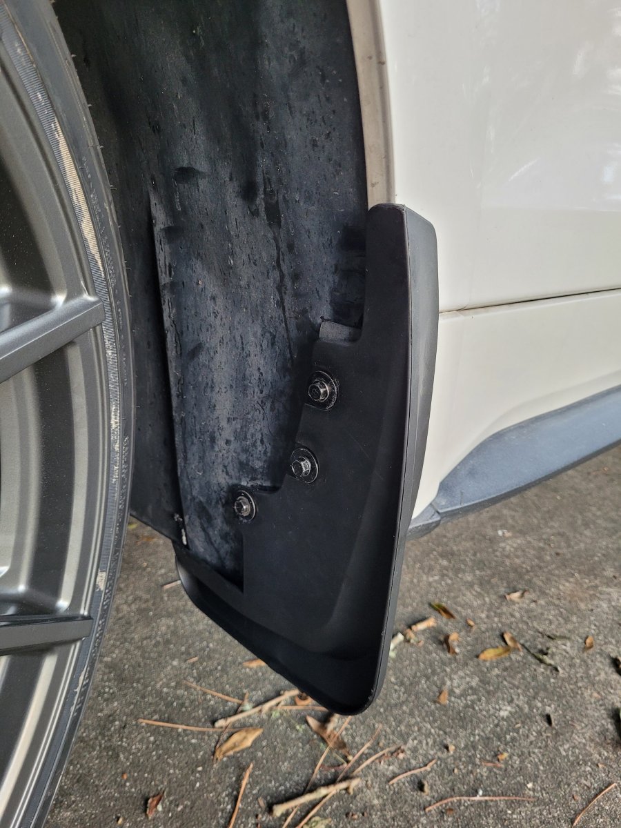

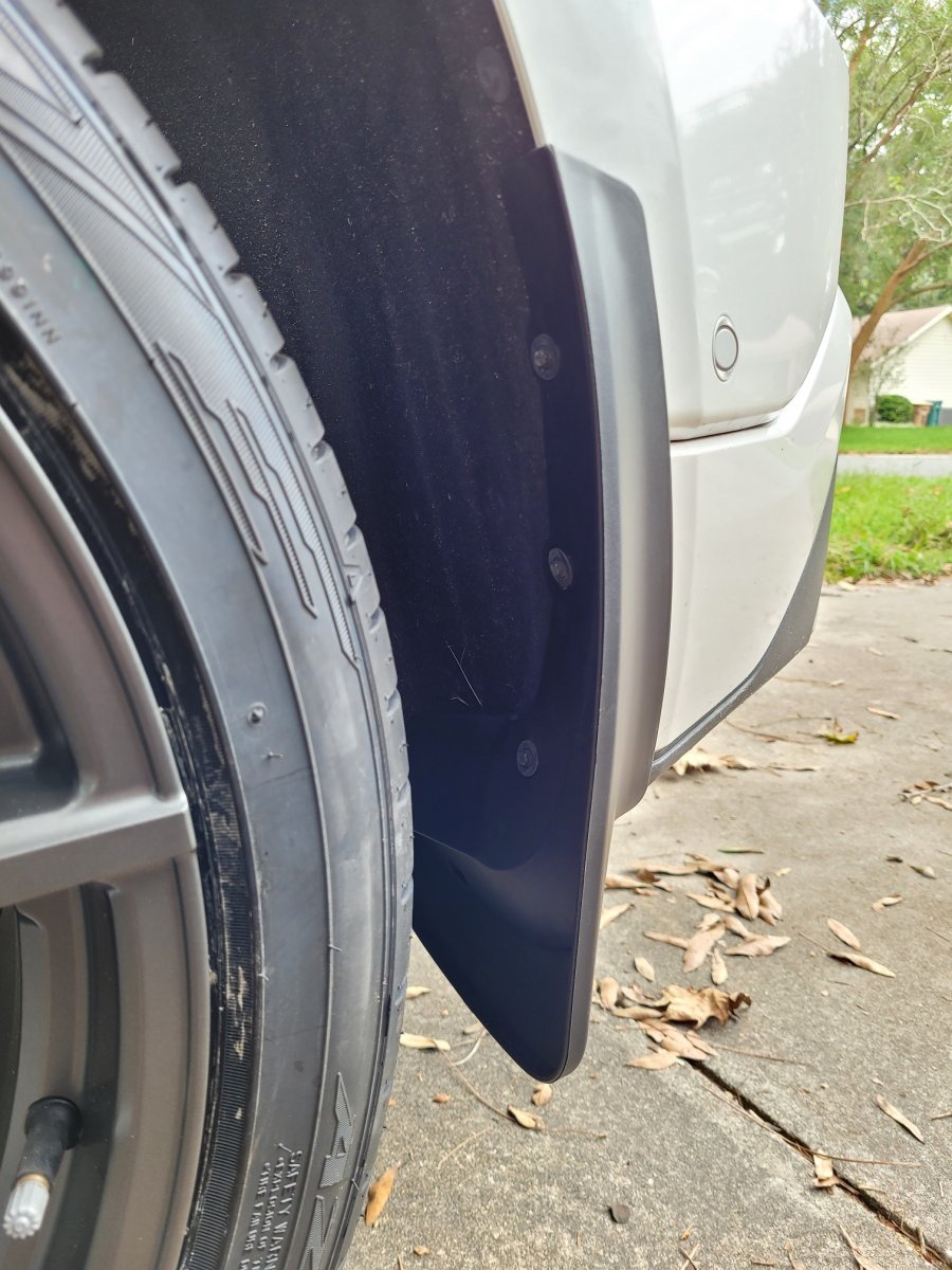

itsnotdustin Posted September 14, 2021 Author Report Share Posted September 14, 2021 (edited) Mudflaps installed. I'll say I copied @tsquale on this after I saw them post a picture in the gallery last week. These are amazon mudflaps but the fit is pretty solid. I had no idea how to use the included hardware on the front flaps considering there was nothing to screw into once the factory push pins were removed. I ended up having to order 6 u-clip fasteners and 2 christmas tree fasteners to get the front installed. The u-clips and bolts went into the wheel well while the christmas tree fastener went into the bottom. The rear flaps used factory hardware with no issue. After install they are rock solid. Edited September 14, 2021 by itsnotdustin 3 Quote Link to comment Share on other sites More sharing options...

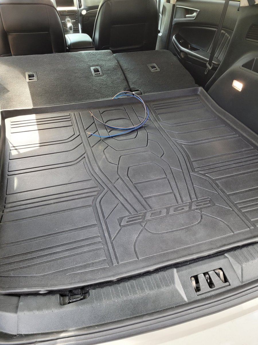

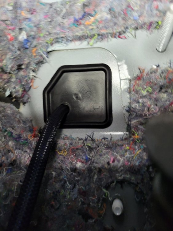

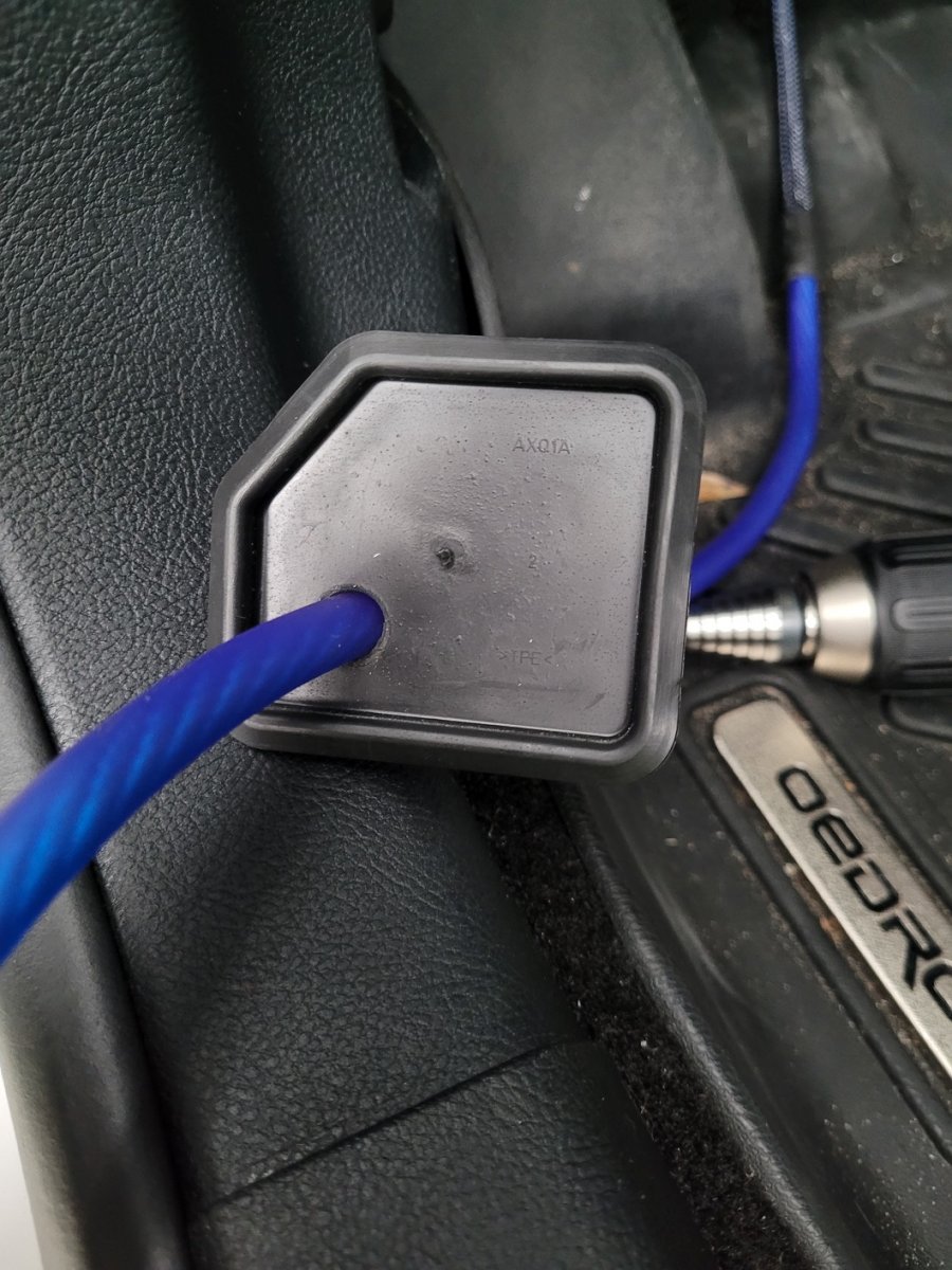

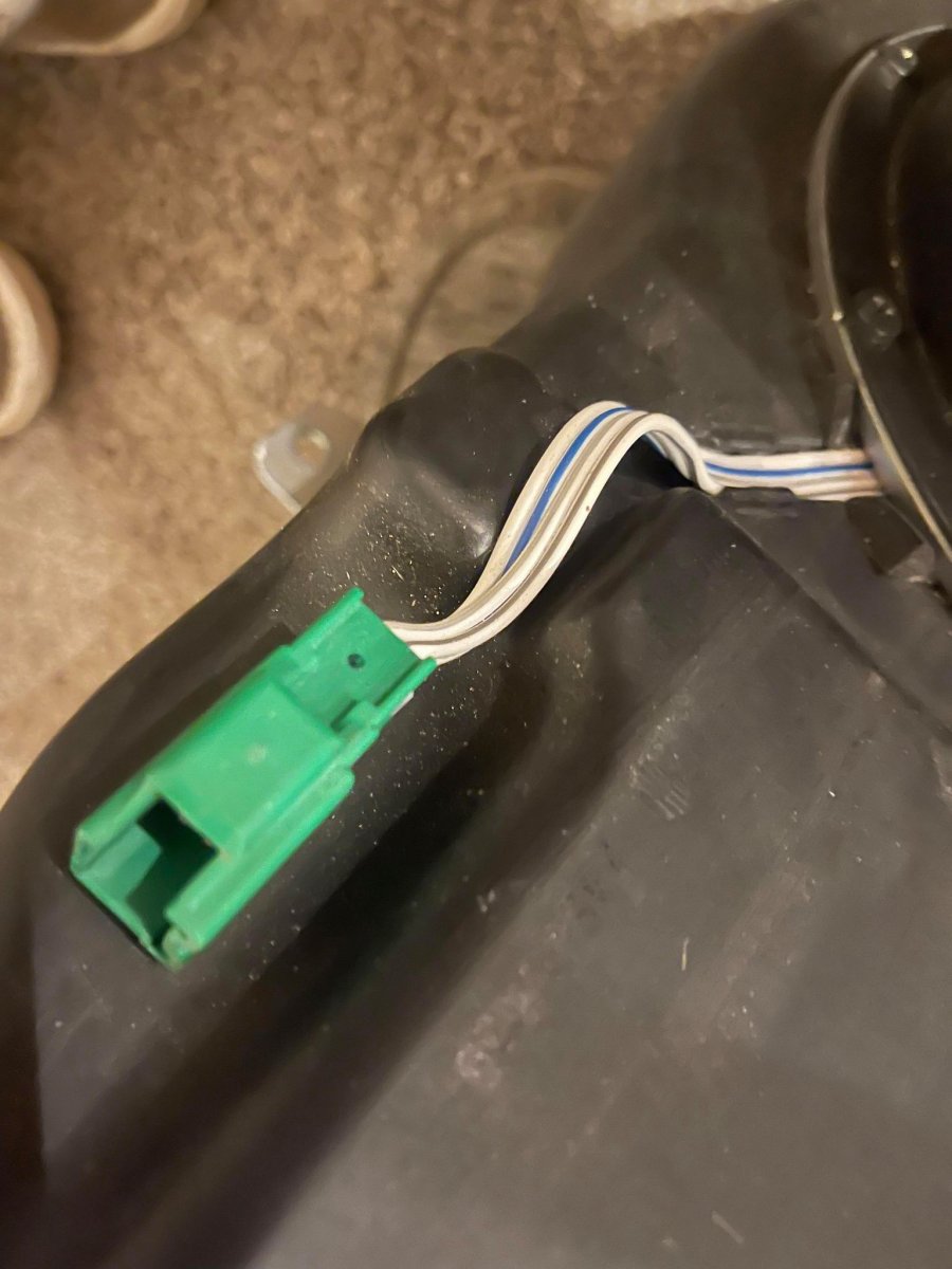

itsnotdustin Posted September 22, 2021 Author Report Share Posted September 22, 2021 (edited) Update: After install I had a nasty pulse/hum every time I started up the car but stopped shortly after. After some googling I decided to disable Active Noise Cancelling in the car. To do this with FORScan, go to the DACMC module to disable it. You can also disable Engine Noise Enhancement while you're in there. Started the amp install starting with the power wire, which is always the hardest part. I used this forum for help. A couple posts in particular. The first post pointed me in the direction of a large plug on the firewall that is unused. I used a uni-bit to drill a hole just large enough for the wire and ran it through. It's soft rubber so no grommet was required. This plug is accessible behind the battery. I was able to fish the the wire through using a magnetic pick-up which did not require me to unhook the battery, only slide it forward. The second post pointed me to a good ground location near the factory amp. I didn't want to pull any panels unless I had to so I'm glad I found this post because I wouldn't have found a solid ground otherwise. Since I'll be using an LOC for audio signal, I ordered a blown factory Ford sub and will be pulling the green harness of off that to plug into the factory harness. I try to avoid cutting or tapping into factory wires as much as possible, so instead I will unplug the factory sub in the car and wire up the LOC to the spare plug I ordered. The LOC I bought also acts as the fuse/remote wire and will trigger the amp when an audio signal is heard. A note for the picture above: The wire that I have grounded along with the amp wire was just hanging loose when I first looked behind the panel. I don't know if its supposed to be grounded or not. If anyone knows what that ground wire does, I'm curious to find out. Im not much for wire management as long as it is hidden and easily removeable. I drilled a few holes in the foam container. 1 for power, 1 for ground, and a notch for the speaker wires and loc wires. This is the speaker setup I had from my old suv. I will probably get rid of 2 subs and switch from a sealed to a vented box. Edited October 3, 2021 by itsnotdustin 3 Quote Link to comment Share on other sites More sharing options...
