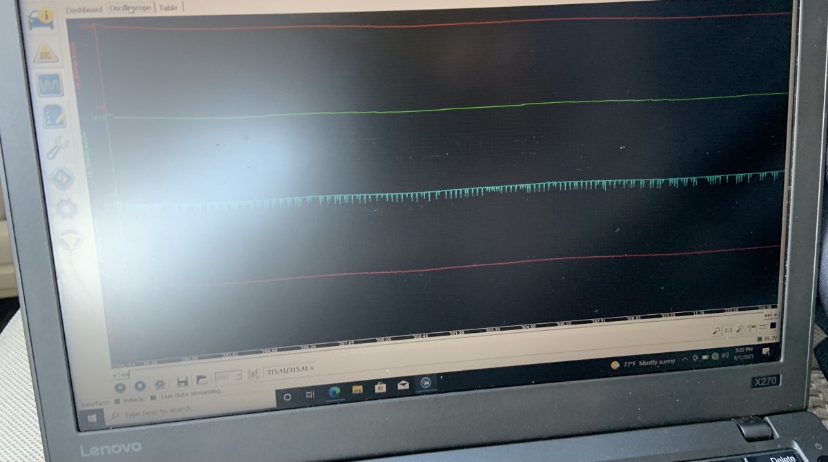

I have an 08 Ford Edge with ABS and Traction Control lights on without a wrench.  Using ForSCAN I have determined that the problem is from the passenger front wheel, it has a staccato movement rather than a smooth line when tracking speed. All other wheels are smooth up and down.
Replaced the rotor, caliper and pads, was pretty sure it was the rotor as I had to get that loose with a rubber mallet.  I’ve checked the tone ring and it isn’t loose, missing any teeth, or cracked in any way I can see or feel. My next item to replace is the sensor.

Using ForSCAN you can output a oscilloscope like record (Similar to a heartbeat monitor or an EKG) for any sensor that you have on the car in real time.  The lines for 3 wheels run smoothly up in unison and back down when decelerating. The offending wheel looks like a jagged mountain as it goes along. I attached a picture for illustration.
I’ve inspected the tone ring twice and not found any cracks, missing teeth, or anything other than rust really, that could be wrong with it.
