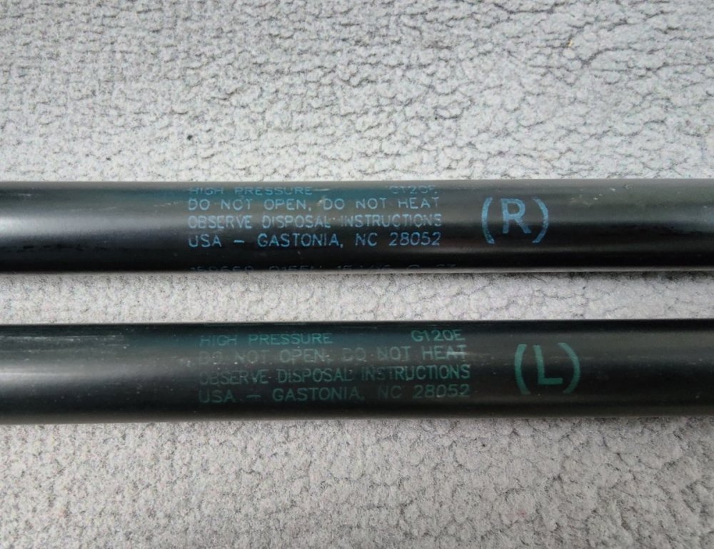

Update. I got a set for my 2016 Edge Sport from eBay (this listing). Even though the listing states 2019-2021, I found Ford's part number is the same so I got them and they work fine. Now the really lift the hood to the point that when closing the hood, I can't drop it shut. Have to kinda push it (throw it?) down the last foot or so to close it shut. One of the stock struts apparently started leaking.
  • Like 2
The originals have text "Left" and "Right" and Ford lists two part numbers - I couldn't see any physical difference.
Just to confirm, that link has them at $48 for the pair?
I'm going to get a set - I liked the way it lifted fully open when my Sport was new.
I suspect the gas has just about all leaked out on mine.
I also noticed the same. They are physically the same with the exception of the (R) & (L) printed on them (pics attached). They are even prices exactly the same. Found even Toyota does the same thing having two different part numbers for right & left. Maybe it a standard practice and maybe they are different for some vehicle models.
