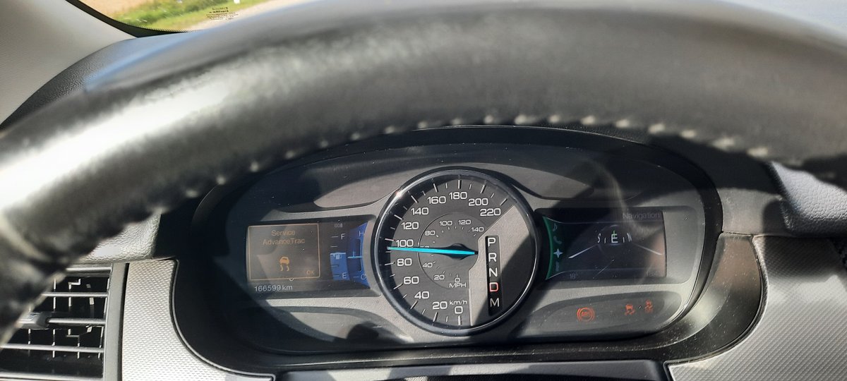

Audrazas Posted July 28, 2022 Report Share Posted July 28, 2022 Does anyone know what are the most common failures with this code? Where to look for the problem? It appears while driving and disappears after a few seconds. Could it be a bearing? Thanks Quote Link to comment Share on other sites More sharing options...
callatis Posted April 7, 2023 Report Share Posted April 7, 2023 Ford Edge 2013 Front-wheel drive, I am getting the same Service Control Trac when I am in Drive and I have my foot on the brake pedal. My mechanic could not identify the issue as there is no faulty code on the computer. Any suggestion? Quote Link to comment Share on other sites More sharing options...
dabangsta Posted April 7, 2023 Report Share Posted April 7, 2023 Did you/they have a code reader that can read ABS codes? I think that an ABS sensor type issue can cause this. I used a bluetooth OBD-II adapter and Torque app on my phone to watch wheel speeds and ABS signals to diagnose an issue with my 2012 Fusion. I assume that you also have the ABS light on? Quote Link to comment Share on other sites More sharing options...

callatis Posted April 8, 2023 Report Share Posted April 8, 2023 17 hours ago, dabangsta said: Did you/they have a code reader that can read ABS codes? I think that an ABS sensor type issue can cause this. I used a bluetooth OBD-II adapter and Torque app on my phone to watch wheel speeds and ABS signals to diagnose an issue with my 2012 Fusion. I assume that you also have the ABS light on? No, in my case no ABS light and the mechanic couldn't find anything. Quote Link to comment Share on other sites More sharing options...
