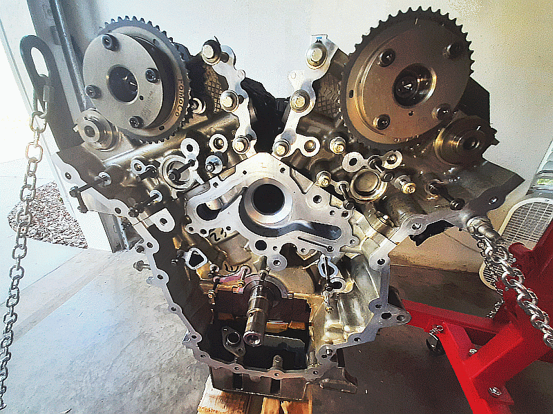

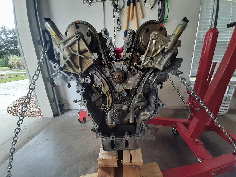

Have here a 2008 EdgeAWD V6~3.5L~DOHC; just finished rebuilding\renewing these items:

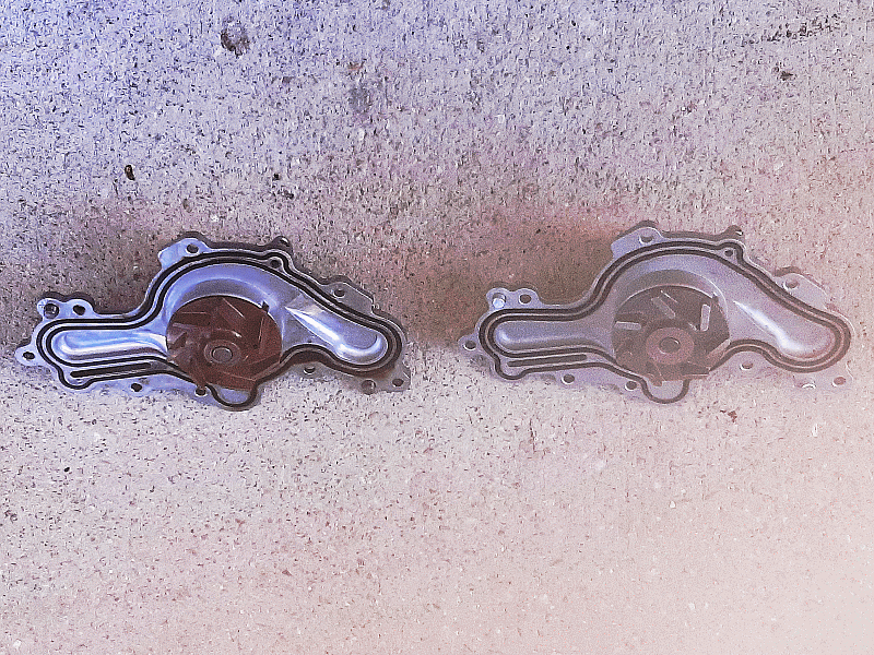

~ the notorious InternalChainDrivenWaterPump, upgraded from PlasticImpeller to MetalImpeller (see pic below)
~ all Timing components excepting the VVT Sprockets (see pic below)

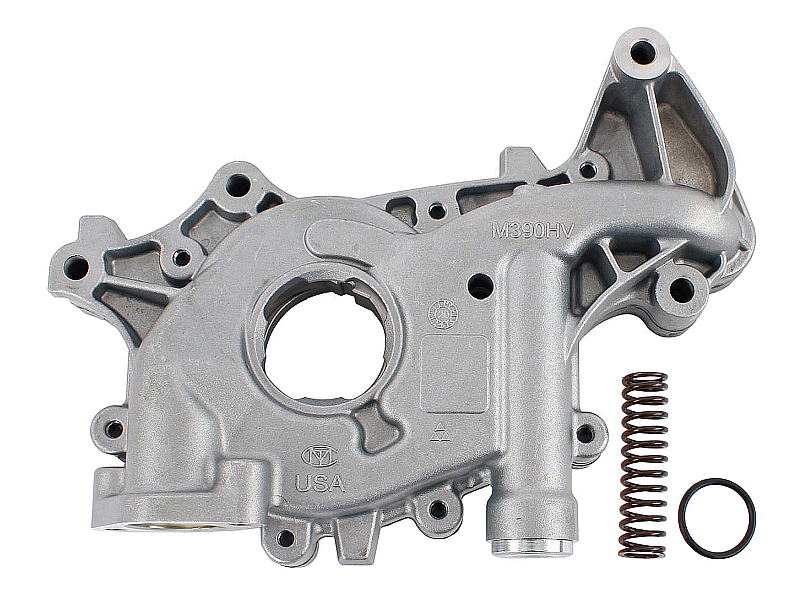

~ upgraded InternalChainDrivenOilPump to a Melling HiVolume unit while I was in there (see pic below)

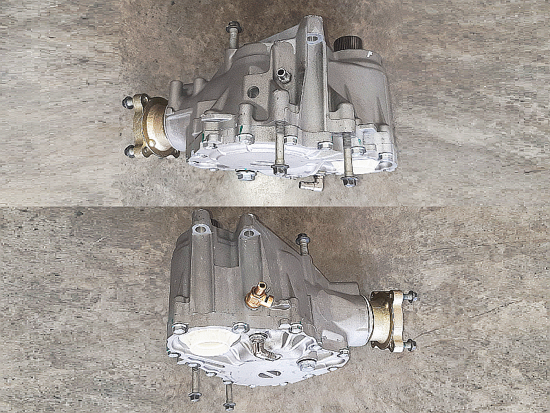

~ new PowerTransferUnit\PTU, bottom drilled+tapped with FumotoDrainValve, top Vent & side Fill removed & both hosed up to FillCan under Hood

All of this was initiated due to WaterPump InnerFlangeSeal failing & spewing Yellow\Gold coolant out upper+front weepholes.
WaterPump can fail 3 different ways:
~ the InnerFlangeSeal fails & spews coolant externally thru Front+Top WeepHoles without damaging Engin
~ both Outer+InnerFlangeSeals fail & spews coolant into the OilPan & damages Engin
~ the ImpellerBearing+Seal fails & spews coolant into the OilPan & damages Engin
so I figure i'm damned lucky it failed the way it did.

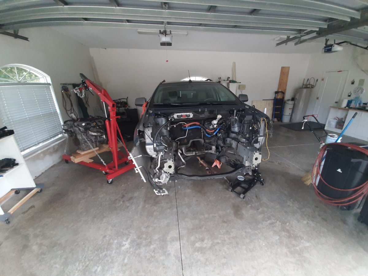

I pulled the Engine+Trans from the top;
this was a tedious rebuild, 3month+ mostly waiting for parts;
but she's now running good, hopefully for another 150kMiles.
