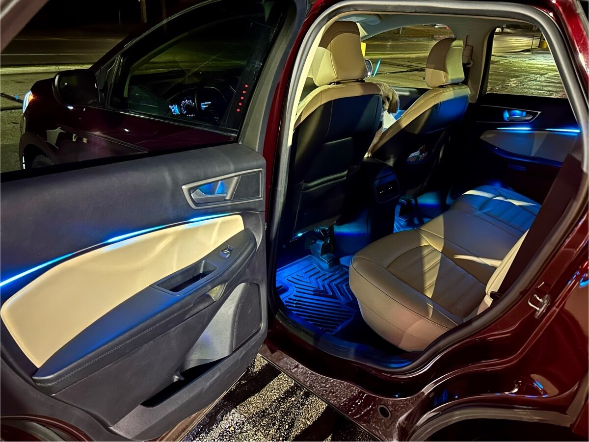

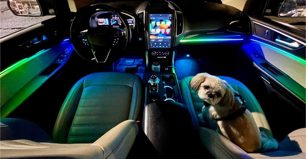

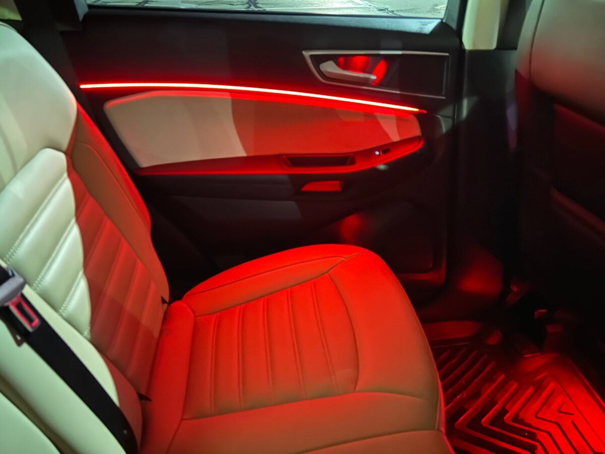

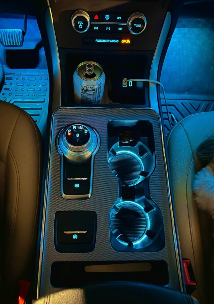

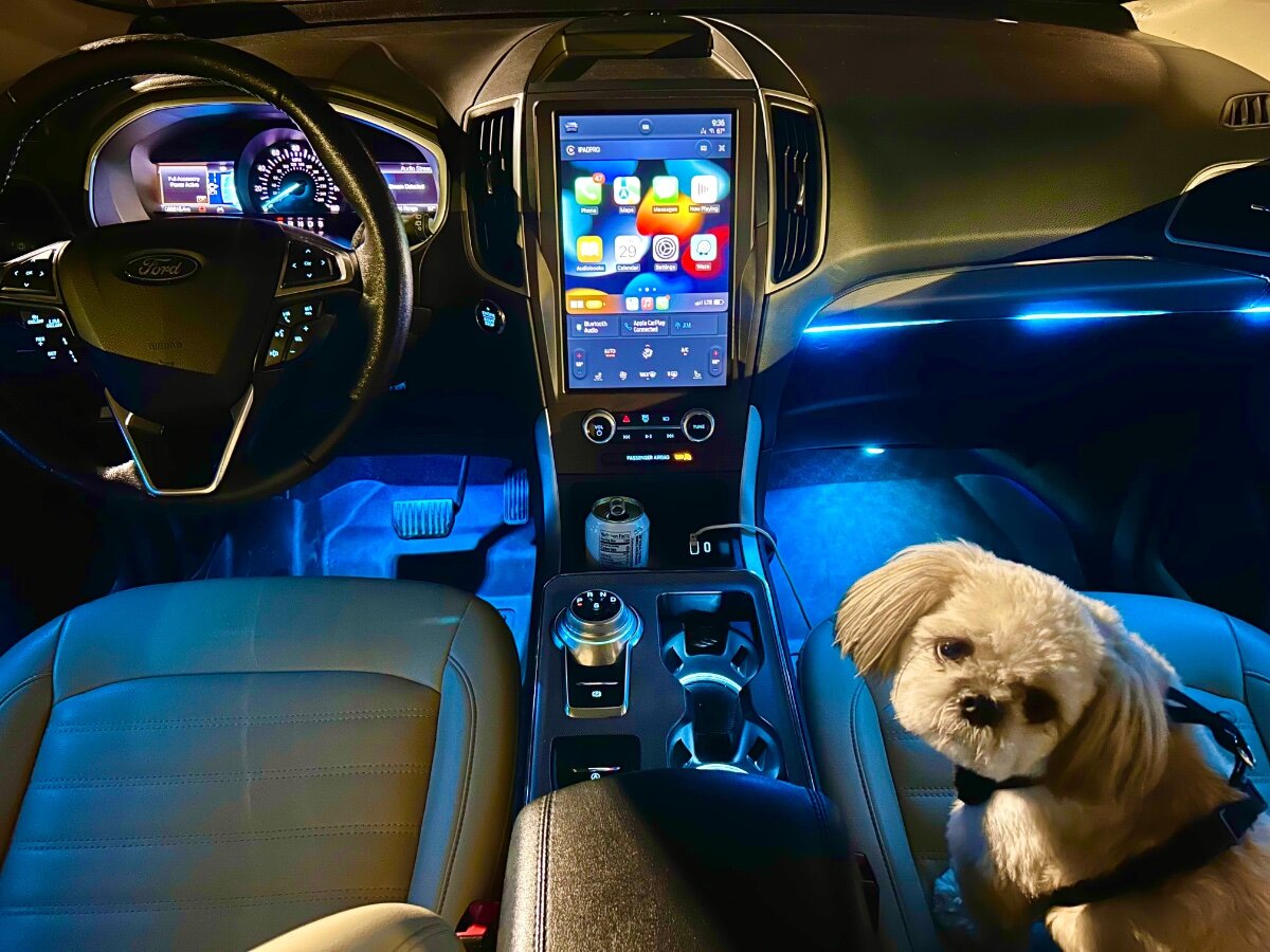

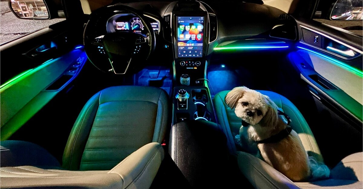

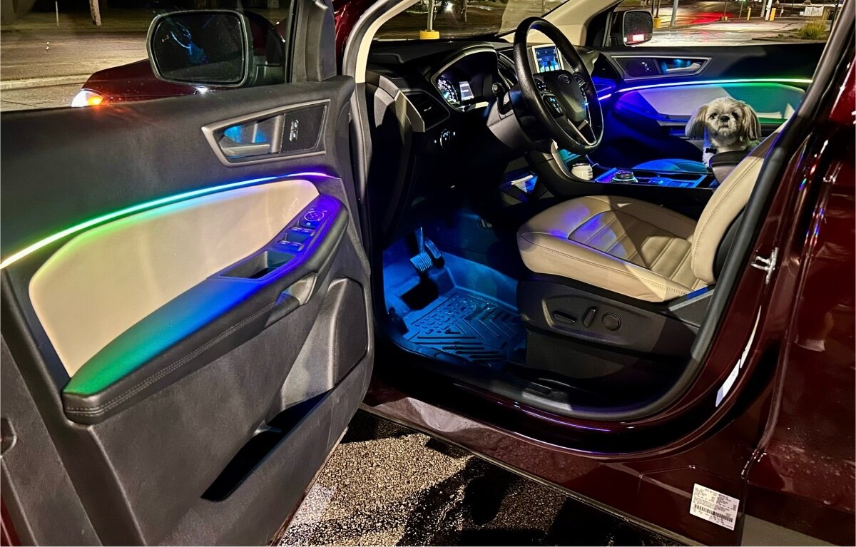

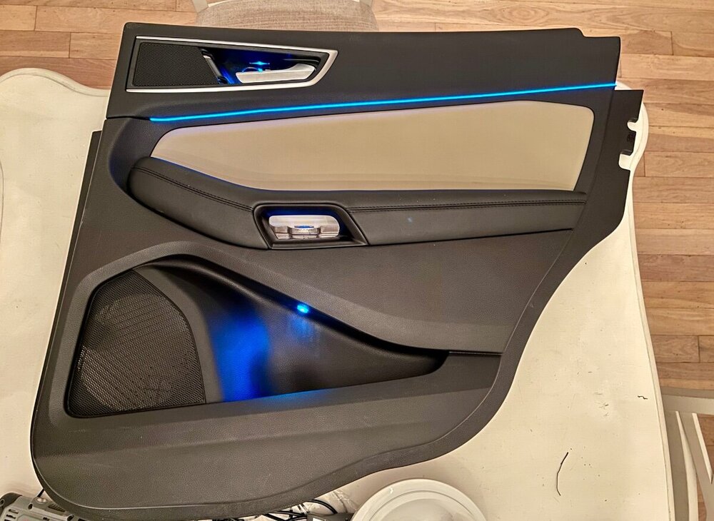

Wubster100 Posted October 1, 2024 Report Share Posted October 1, 2024 Finally finished installing ambient lighting in my 2021 Edge. The cup holders are OEM and everything else is aftermarket. The cup holders are only ice blue, and they are controlled by the SYNC screen. In each door, I installed a light in the door handle, door storage, and an LED strip along the door trim. I also installed 4 LED lights under the seats to light up the footwell areas. I also installed an LED strip above the glove box. All of the aftermarket lights are controlled by a hidden physical switch or with Bluetooth from my phone. I was able to get the cup holders for free by using Fordpass Points, and the aftermarket lights were only $34 USD (including shipping) for everything. Overall I am happy with the new ambiance. 5 1 Quote Link to comment Share on other sites More sharing options...

Haz Posted October 2, 2024 Report Share Posted October 2, 2024 (edited) Your canine appears to be asking "What color is it now?" Good luck! Edited October 2, 2024 by Haz 3 Quote Link to comment Share on other sites More sharing options...
jsenkski Posted November 6, 2024 Report Share Posted November 6, 2024 Was the factory illuminated cup holders plug and play. Is there a plug already there for the cup holders? I have a 2024 ST-Line that I would like to put the illuminated cup holders in. Thanks 1 Quote Link to comment Share on other sites More sharing options...
Wubster100 Posted November 7, 2024 Author Report Share Posted November 7, 2024 On 11/6/2024 at 9:48 AM, jsenkski said: Was the factory illuminated cup holders plug and play. Is there a plug already there for the cup holders? I have a 2024 ST-Line that I would like to put the illuminated cup holders in. Thanks The factory illuminated cup holders were not plug and play for my vehicle. I did not have any wiring for ambient lighting from the factory. The cup holders have 2 wires for power, and one wire for “data” or the LIN bus. I had to insert a new wire into the BCM, and run it up to the cup holders. I also had to make changes in FORScan to enable the ambient lighting controls on the touchscreen. 1 Quote Link to comment Share on other sites More sharing options...

ashleymcp17 Posted March 3 Report Share Posted March 3 can you post links for what you used I have been wanting to do this to my ford! 1 Quote Link to comment Share on other sites More sharing options...
Wubster100 Posted March 5 Author Report Share Posted March 5 Welcome to the forum @ashleymcp17, The ambient lights can be found by searching for something like: car symphony ambient lights. There are multiple options for different kits. I got a kit with one main controller, 4 sub controllers for the doors, footwell lights, door handle lights, and light strips for the doors and interior. The cheapest place I found the kit was AliExpress. The cup holders are OEM. I will try to find the cost that I paid. 1 Quote Link to comment Share on other sites More sharing options...

enigma-2 Posted March 12 Report Share Posted March 12 Hate to be a downer, looks a little too bright for me. Love the puppy however. What a cutie. 1 Quote Link to comment Share on other sites More sharing options...
Wubster100 Posted March 12 Author Report Share Posted March 12 You're not a downer. The brightness was set to 100%. The camera definitely makes the colors pop and the light look 2x brighter. Quote Link to comment Share on other sites More sharing options...
Ron Ron Posted May 7 Report Share Posted May 7 Hello, love the lighting . Once you get all the lights into position, is it as simple as plugging into a usb to turn them on ? Or is it way more intricate with going into the vehicles electronics 😬 1 Quote Link to comment Share on other sites More sharing options...
Wubster100 Posted May 7 Author Report Share Posted May 7 Welcome to the forum @Ron Ron! The lights were powered by connecting to different power sources around such as the door modules and rear windows. The lights use very little electricity. A standard USB port will not work because it only provides 5 volts, while the light modules need 12v. The cup holders are more intricate, connecting to the body control module and being controlled by the touch screen. Quote Link to comment Share on other sites More sharing options...

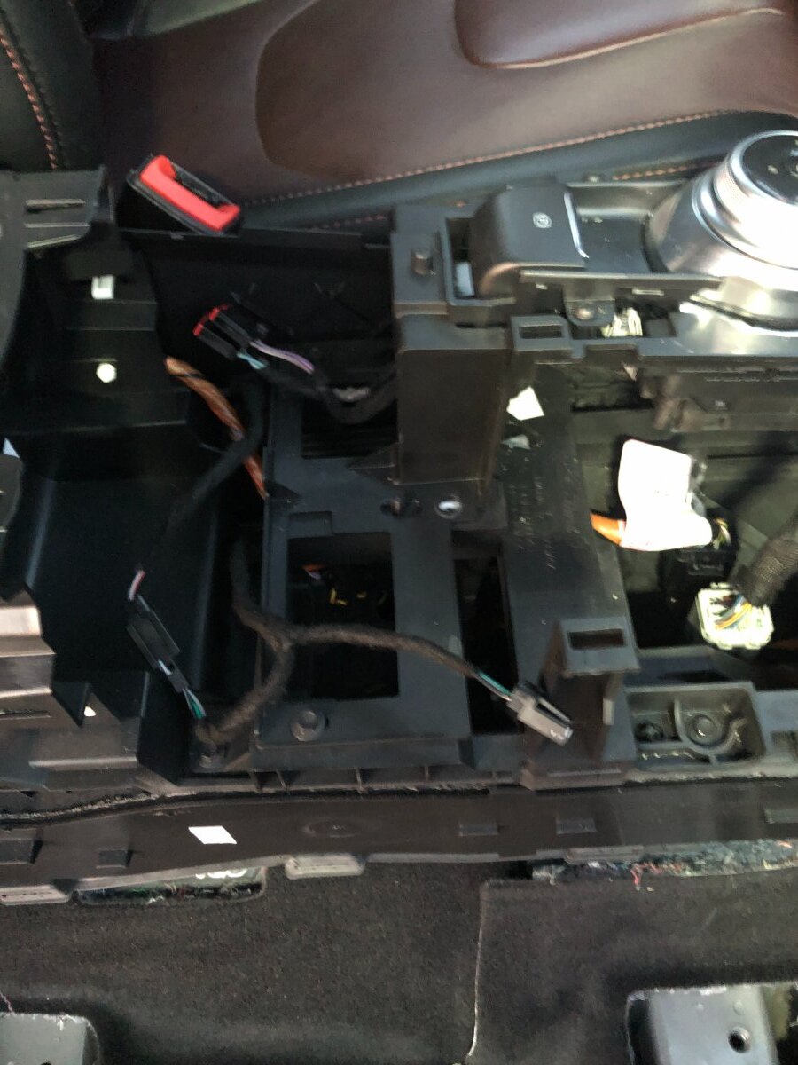

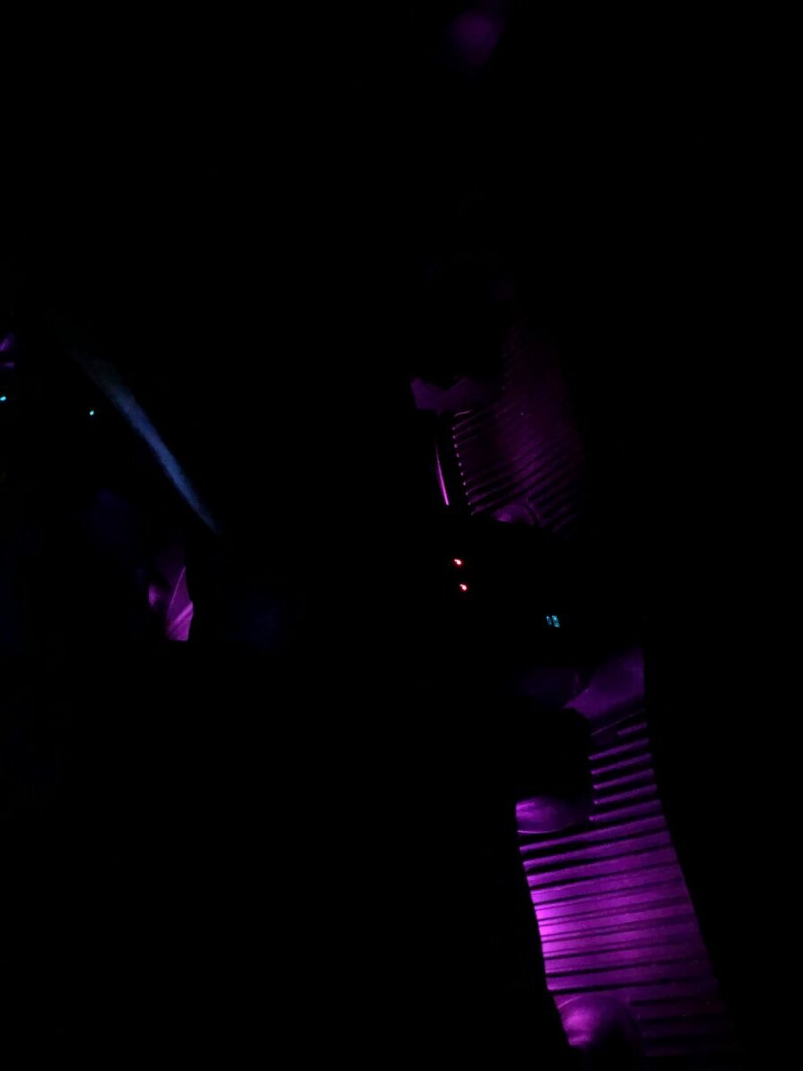

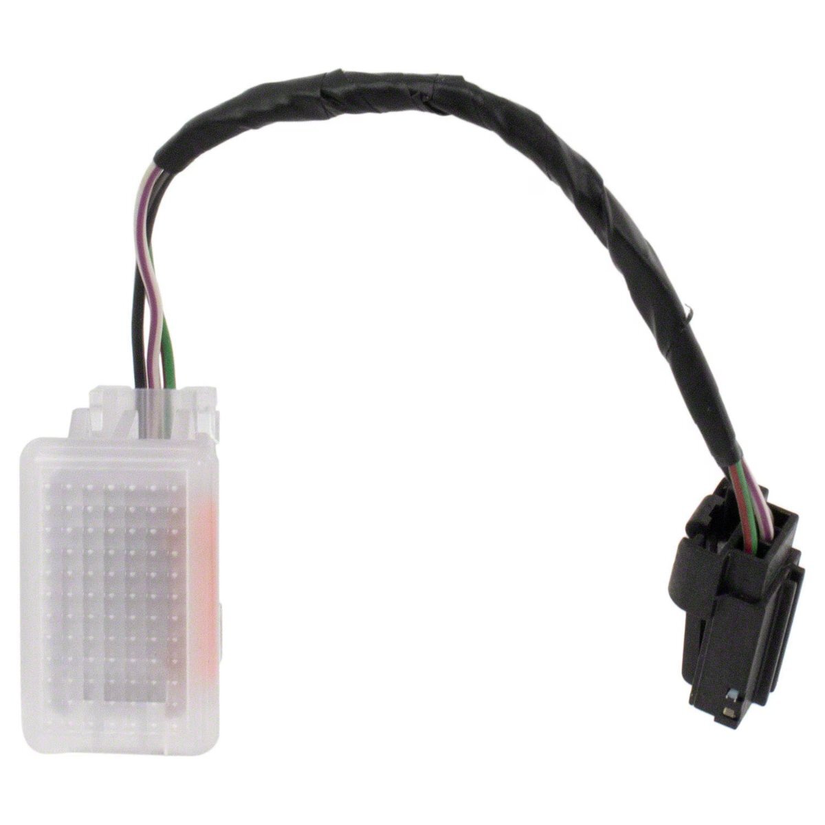

TXFRDOwner Posted July 21 Report Share Posted July 21 (edited) Thanks for the inspiration @Wubster100 My edge is a 2022 Titanium, it came with single color ambient lighting. Took a trip to the yard and was lucky enough to score all the OEM ambient lighting parts from a 2017 Edge Titanium. The cup holder LED harness came from a 16 F150. APIM asbuilt change 7D0-01-02 xxxx-xxxx-2xxx - from single color to pantone (aka RGB) Edited July 21 by TXFRDOwner 1 Quote Link to comment Share on other sites More sharing options...

TXFRDOwner Posted July 21 Report Share Posted July 21 1 hour ago, Wubster100 said: Looks amazing! My screen doesn’t have the graphic of the vehicle. I only have a toggle and brightness control. Mine looked exactly like yours 2 days ago 😁 You can change it with Forscan. 7D0-01-02 xxxx-xxxx-Xxxx The original value at that position should be a “3”, change it to a “2”, cycle the ignition on/off et voila. 1 Quote Link to comment Share on other sites More sharing options...
TXFRDOwner Posted August 3 Report Share Posted August 3 (edited) Made a T-Harness to tap into the cupholder ambient lighting, ran each side of the harness under the carpet, under the front seats and install the under seat (aka rear footwell) "RGB" OEM ambient lighting. Edited August 3 by TXFRDOwner 1 Quote Link to comment Share on other sites More sharing options...
