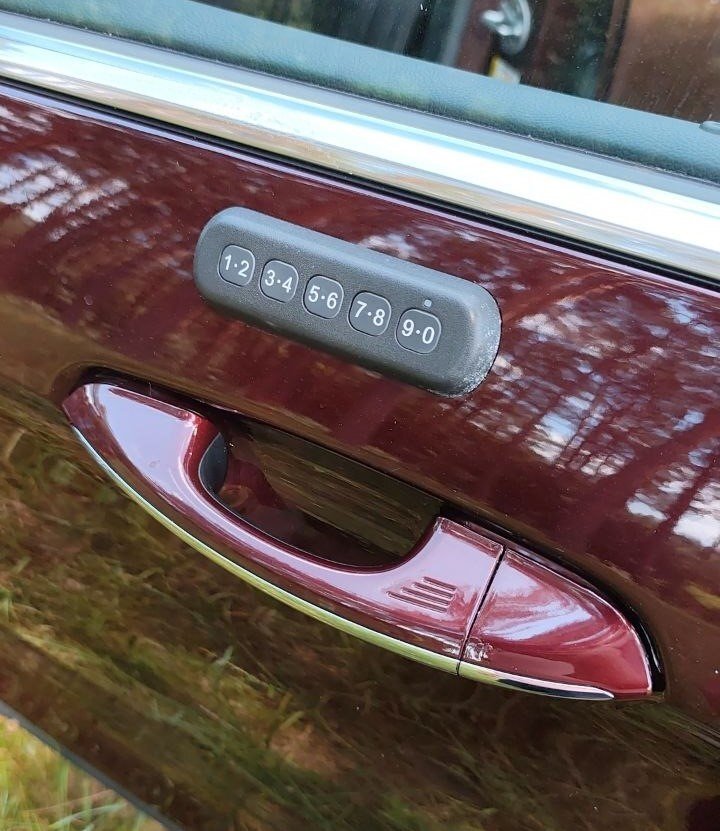

Iroga Posted Friday at 04:17 AM Report Share Posted Friday at 04:17 AM Good day to all. There's only one key. For some reason, Forscan can't see the door code. As far as I understand, this is not the reason. 2FMPK4K96RBA03469. Can someone help me? Can I see it programmatically or do I have to physically look at it? 1 Quote Link to comment Share on other sites More sharing options...
omar302 Posted Friday at 09:10 AM Report Share Posted Friday at 09:10 AM This is not a factory keyless entry keypad. It is an official Ford accessory add-on. So the entry code probably cannot be found using the normal procedures. As per the I installation manual, a Ford Dealer can get you the code. So maybe if you reach out to the ForScan support team they might help. 2 Quote Link to comment Share on other sites More sharing options...

1004ron Posted Friday at 04:14 PM Report Share Posted Friday at 04:14 PM (edited) 12 hours ago, Iroga said: Good day to all. There's only one key. For some reason, Forscan can't see the door code. As far as I understand, this is not the reason. 2FMPK4K96RBA03469. Can someone help me? Can I see it programmatically or do I have to physically look at it? Is that VIN for the vehicle in your signature? 2024 Ford Edge VIN 2FMPK4K96RBA03469 from USA | Auction Dec 25, 2025 Got to wonder who would put that ugly keypad on a 2019 or 2024 model that came with the LED type seen in the below YouTube video. Edited Friday at 04:23 PM by 1004ron Quote Link to comment Share on other sites More sharing options...
Iroga Posted Friday at 06:45 PM Report Share Posted Friday at 06:45 PM (edited) That's how he got to Belarus. Yes, the car's VIN number. Edited Friday at 06:48 PM by Iroga Quote Link to comment Share on other sites More sharing options...
omar302 Posted Friday at 08:11 PM Report Share Posted Friday at 08:11 PM 3 hours ago, 1004ron said: Got to wonder who would put that ugly keypad on a 2019 or 2024 model that came with the LED type seen in the below YouTube video. In 2023 Ford removed the factory keyless keypad from the Ford Edge. Hence the post-factory accessory stick on for those who still want it. This is also true for several other Ford models, but some, like 2024+ Escapes/Bronco Sport and 2025-2026 Explorer, can get the hidden B-pillar pad style as an available accessory like this. 2023 Edge Order Guide.pdf 2 Quote Link to comment Share on other sites More sharing options...

1004ron Posted Sunday at 02:21 PM Report Share Posted Sunday at 02:21 PM On 7/17/2026 at 5:10 AM, omar302 said: This is not a factory keyless entry keypad. It is an official Ford accessory add-on. So the entry code probably cannot be found using the normal procedures. As per the I installation manual, a Ford Dealer can get you the code. So maybe if you reach out to the ForScan support team they might help. On 7/17/2026 at 5:34 AM, Iroga said: Thank you, I understand. 30 minutes ago, Iroga said: Thank you, that all makes sense. How to find the door code is what I don't understand. See @omar302 response - BTW when I was looking for the door code my local dealership informed me that it was a lengthy process for them to contact Ford Corp with my proof of ownership. Quote Link to comment Share on other sites More sharing options...
Iroga Posted Sunday at 03:15 PM Report Share Posted Sunday at 03:15 PM I wonder if there are two keys, will the code be displayed on the dashboard or not? Quote Link to comment Share on other sites More sharing options...
omar302 Posted Sunday at 05:59 PM Report Share Posted Sunday at 05:59 PM 2 hours ago, Iroga said: I wonder if there are two keys, will the code be displayed on the dashboard or not? The procedure with 2 keys is for the factory installed keypad. Not the add-on accessory like yours. 3 hours ago, 1004ron said: BTW when I was looking for the door code my local dealership informed me that it was a lengthy process for them to contact Ford Corp with my proof of ownership. That is strange. I think they didn't know how to or just wanted to make a big fuss to charge you more. With ForScan or Ford's equipment it is very easy to get it. Or if you have 2 working keyfobs, you can retrieve the code without any diagnostic equipment. 1 Quote Link to comment Share on other sites More sharing options...
