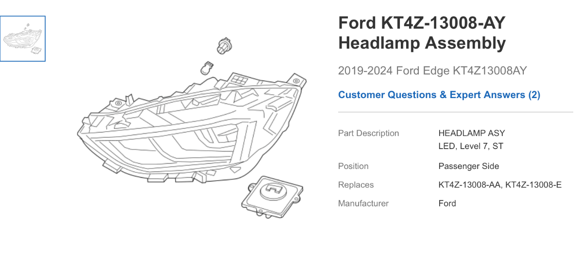

Samurai Edge Posted August 30 Report Share Posted August 30 14 hours ago, Revv said: The dealership told me this over the phone. This is an Edge ST 2022. Your video is not my car. I have an Edge ST 2022 with a completely different headlight assembly than the one you provided in your video. I’ve seen your video before and that’s not it Sherlock. Well, you don't have to be so mean about it 😭 😭 😭 The problem is, if you even bothered to look, which you obviously did not, that OEM ST headlamp assembly can be had for under $800. https://www.fordpartsgiant.com/parts/ford-headlamp-asy_kt4z-13008-ay.html?vin=&make=Ford&model=Edge&year=2020&submodel=&extra1=&extra2=&filter=(r=446;e=414) The remaining $2200 would be the dealership labor charge to remove two ( 2 ) bolts, unplug a couple of wires and then reverse the process to install the new one. 1 Quote Link to comment Share on other sites More sharing options...
1004ron Posted August 30 Report Share Posted August 30 1 hour ago, Samurai Edge said: The problem is, if you even bothered to look, which you obviously did not, that OEM ST headlamp assembly can be had for under $800. https://www.fordpartsgiant.com/parts/ford-headlamp-asy_kt4z-13008-ay.html?vin=&make=Ford&model=Edge&year=2020&submodel=&extra1=&extra2=&filter=(r=446;e=414) The remaining $2200 would be the dealership labor charge to remove two ( 2 ) bolts, unplug a couple of wires and then reverse the process to install the new one. Are you sure that's the correct headlamp assembly for the OP's specific model and option package? https://www.fordpartsgiant.com/parts/ford-housing-headlamp_kt4z-13100-c.html?vin=&make=Ford&model=Edge&year=2020&submodel=&extra1=&extra2=&filter=(r=446;e=414) @Revv my suggestion is to have an autoelec shop check it out in case its a bad connector etc. - as @omar302 its unusual for an LED to fail especially this early. Quote Link to comment Share on other sites More sharing options...

omar302 Posted August 31 Report Share Posted August 31 3 hours ago, Samurai Edge said: It is confusing, they are using the same photo and diagram for both types of headlights, but they are different and the higher level (more expensive, ~$1700 vs ~$800). You can see photo of used one on eBay like the below. The higher level does not have a socket for the turn signal. Higher level: Lower level: Quote Link to comment Share on other sites More sharing options...
Samurai Edge Posted August 31 Report Share Posted August 31 (edited) Parts shopping can always be confusing. Whoever creates the on-line shopping page does not always use correct pictures / diagrams. I see it all the time on all kinds of websites. For the part question, see where the part states, and above that it states 2019 - 2024 Ford EDGE Those are the key points Edited September 1 by Samurai Edge 1 Quote Link to comment Share on other sites More sharing options...
