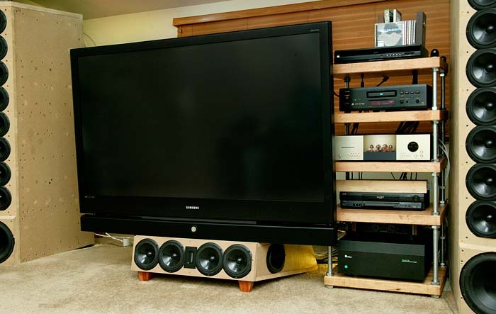

take a guess from this:
http://www.fordedgeforum.com/index.php?sho...entry7159
Tell me for what reason these were inserted in that thread?
LOL
If you don't know why, you didn't read the note. I was dsicussing the drivers I just installed in the front doors of my Edge and the pics showed how I've used these 6-1/2" drivers in my home systems.
