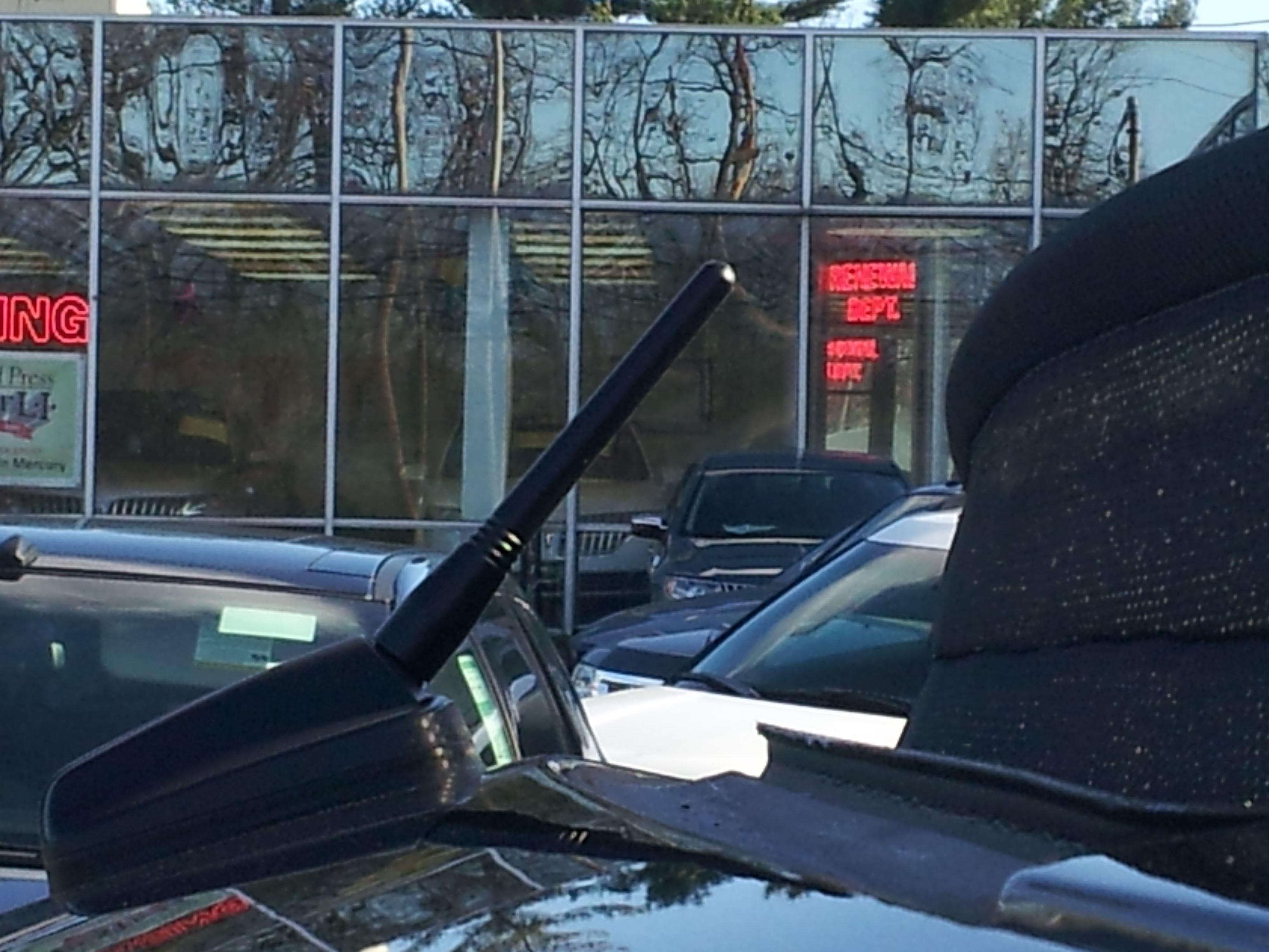

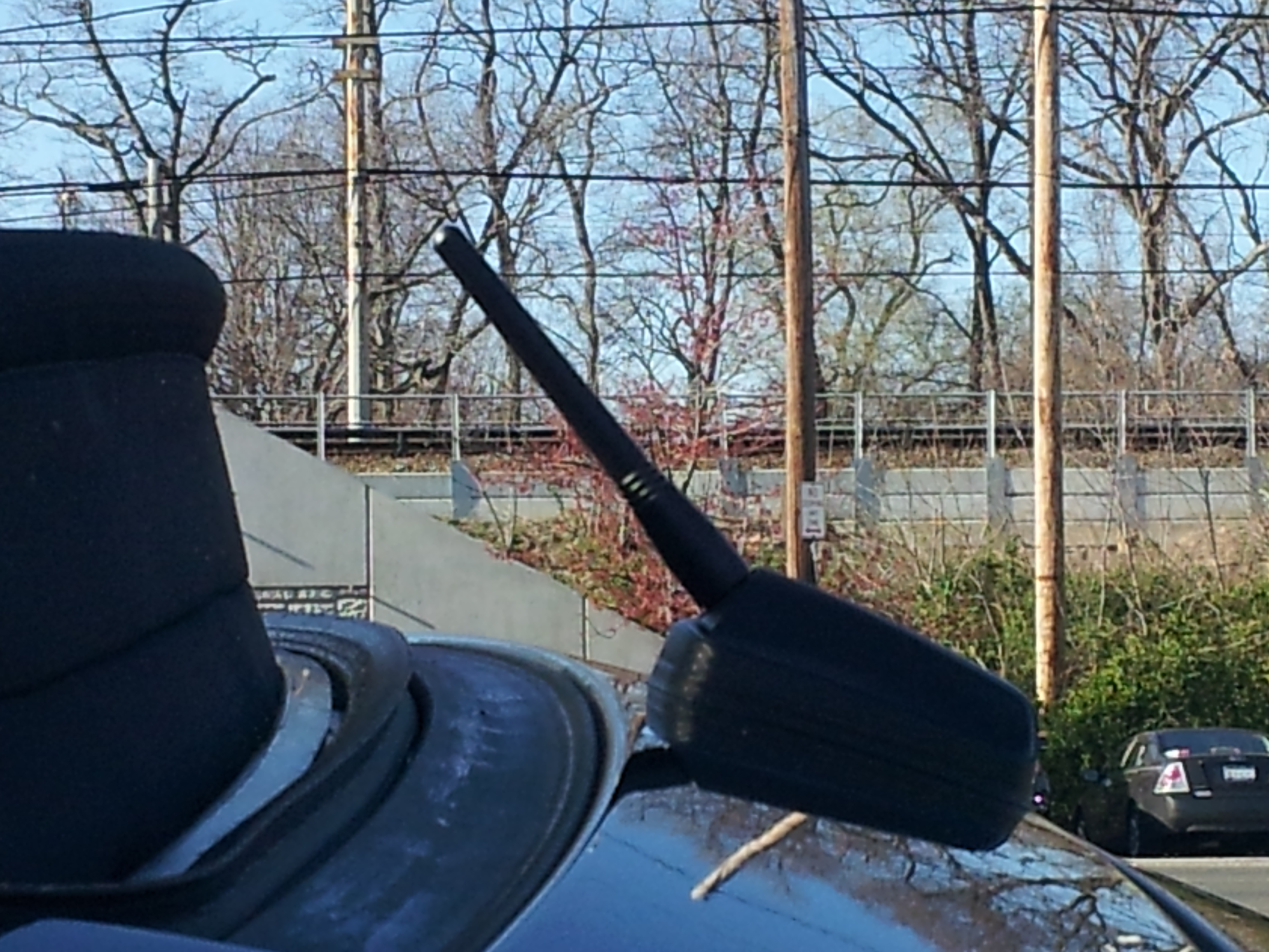

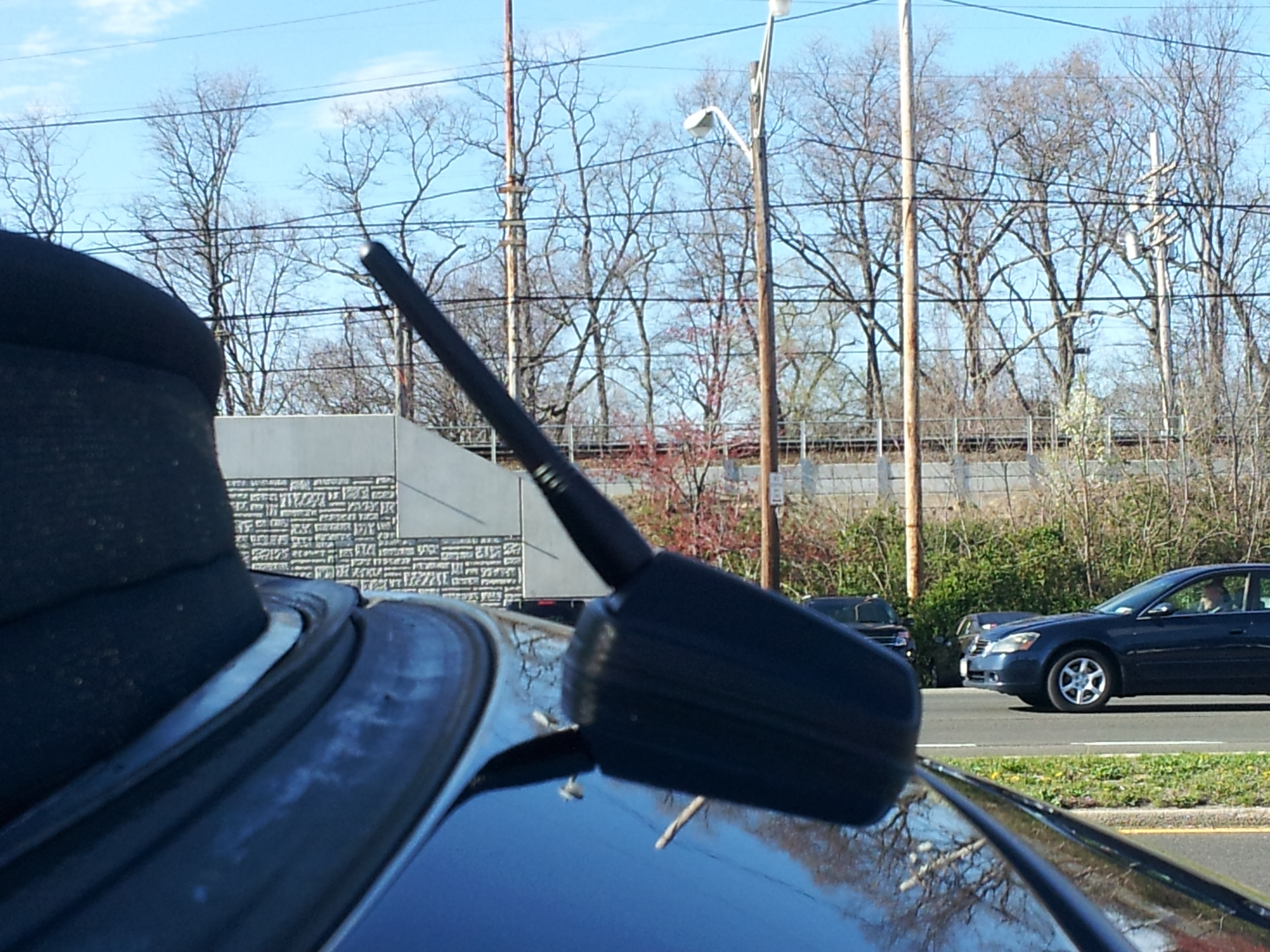

I purchased this antenna it's a great little antenna. I think I actually have better reception with this little one then my original. Here are some pics with it.

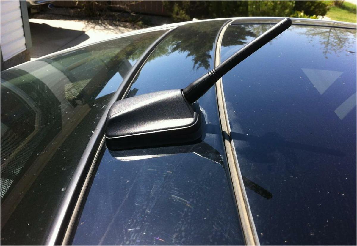

I purchased this antenna and it's a great looking antenna. I also believe that the reception is actually better then the factory no problems with it. Here are some pics
