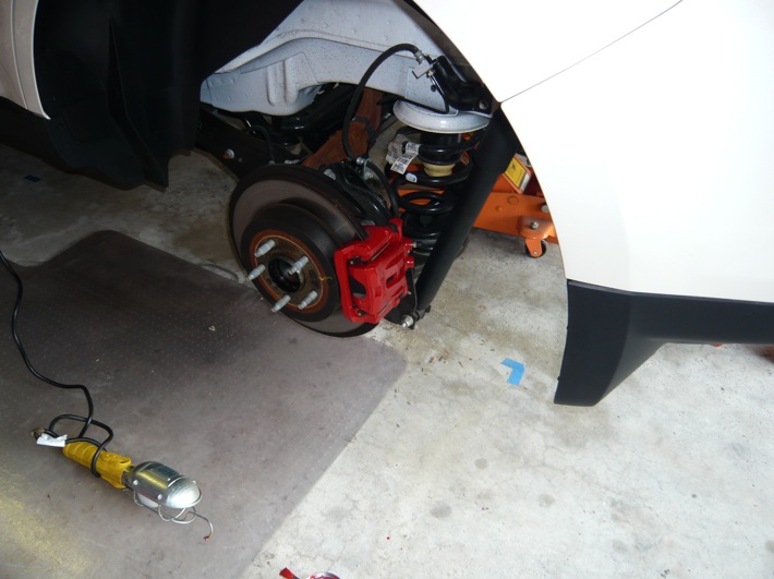

I have watched a few vids and read the G2 propaganda and I think it will be a very easy mod. As usual, I will post up photos (B/A) of the mod. I already ordered the paint today, decided on red. Stuff is so cheap, but so universally praised as one of the top/best choices for this mod, I could always go to black if I really hated it, but I saw enough in photos I am convinced - against white car - it will be great.
As it turns out G2 talks about the fact that calipers do not have to be removed to paint. Yes you could and yes you could even spray versus brush, but I will stick to their protocol and leave them on, clean like crazy, tape it all up real well and brush paint away. I believe, without removing the calipers, I can do a solid job. They claim 1 coat is ideal if you can do it and is thick enough to be perfect, and there is enough in the can to do 2 for sure. And for sure, in talking with them, since you mix the catalyst and the paint, you MUST jack it up and do all 4 wheels at once as the paint sets up and cures so fast, you simply do not have time - they claim - to lift front, clean, prep, mask, paint and put wheels on and set down and move to the rears. I already have 4 stands arranged so I am set.

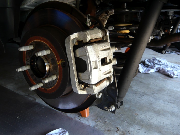

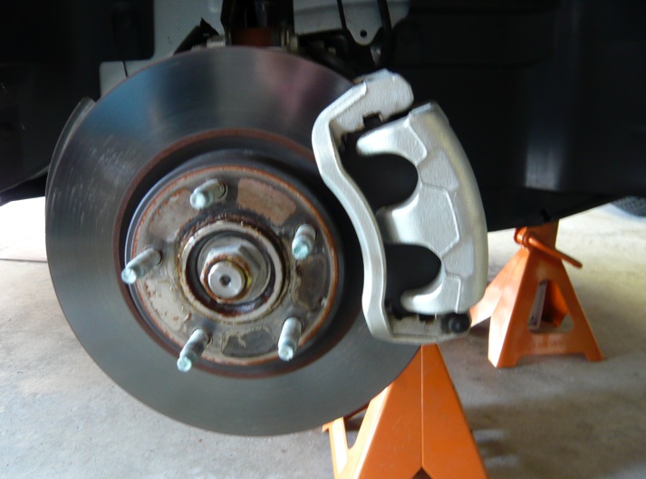

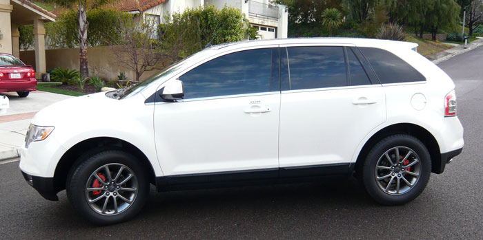

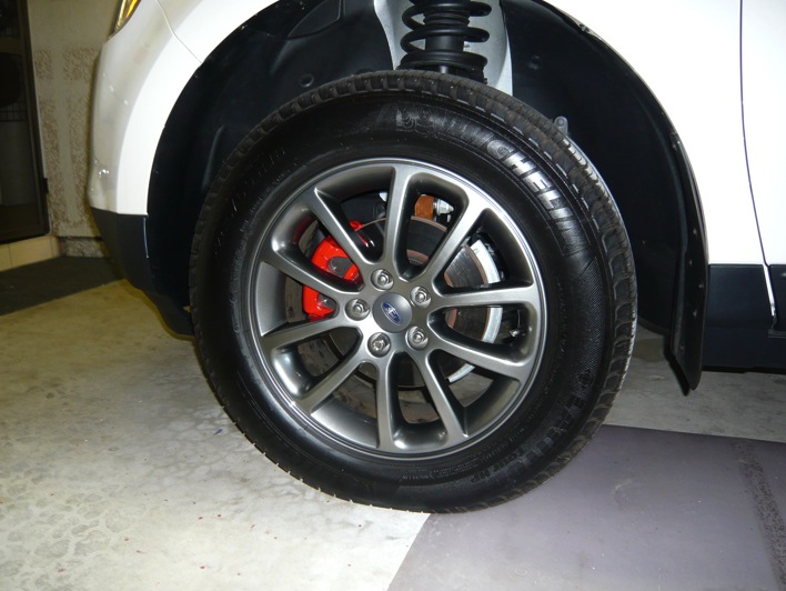

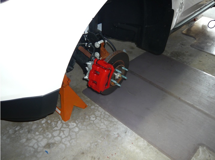

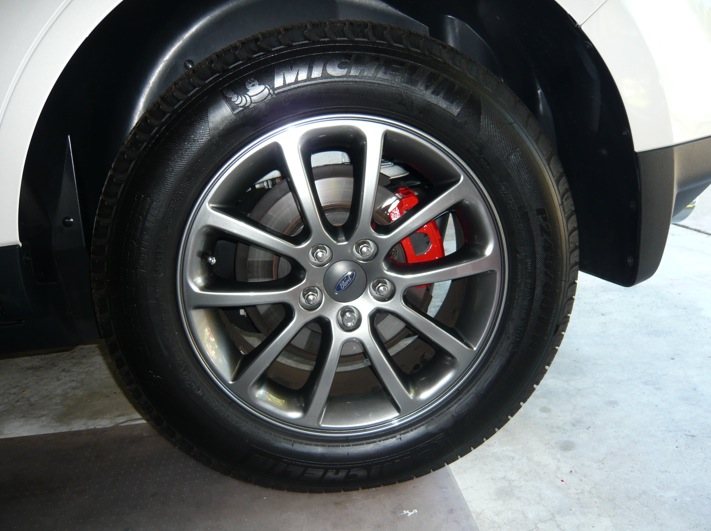

It worked out perfect and looks pretty darn good. Worth the $37 spent. I would say it took about 3-4 hours to jack up (so have floor jack and 4 jack stands), remove wheels, clean - clean - clean calipers, paint, and then come back for a touch up paint, let dry, put wheels back on.
The G2 paint system is nice and hella affordable. A cleaner and enough paint to easily do 3 or so coats - but they say 1 coat should be good and I agree. Thick enamel so coats well. The only bad thing about this kit is that the brush SUCKS! As you proceed, the brush just brakes down - looses shape, loses hairs. I wish I had at least 2 brushes. So, the job gets a bit sloppy as you go along not so much because of you, but because you loose precision as the brush deteriorates.
Here are photos of before, after, front, rear, wheels on/off...

thanks. I really think with these open Premium Painted rims they really work well. The ones I have seen on the chrome clads, not so much as they cover the calipers much more.
thanks! this one was cheap, yet looks like more than it is and not yet cheezy
