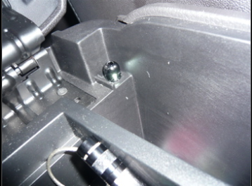

Here you go.. my latest project - another first of it's kind. It has irked me for some time that when I open the center console, anything below the top inch is invisible in pitch black. Similar with the glove box, impossible to see into at night. So, I solved it by wiring up cool LED lights into my center console AND the glove box. Pretty sweet mod that worked out exactly as I planned. Should have been stock in my opinion. But hey, solved the Vista roof light issue, so solved this one as well.

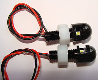

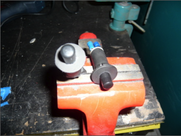

In searching for little LED lights, I found some awesome ones - in black - for motorcycles on ebay. Very affordable. came as a pair. I also got some plunger pin style courtesy dome/door light activation switches off ebay. They came as white, I primed and painted those black. I also dremmeled down the one for the center console as the lip was too round and I just cut off extra material for a better ft. In total, this is about $34 in parts and 1-1.5 hour of time. Results seem to be well worth it.

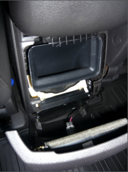

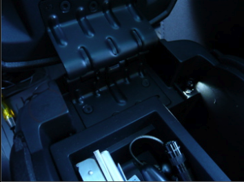

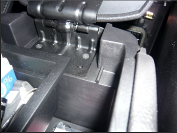

I mounted the light in the drivers side corner of the center console so it aims into the console. could do it either side, but this worked for me. means I can never put the little moveable change holder nearest me, but that is fine for me. I keep it on the pass side anyway so I can look into the center console. I drilled a hole for it and slid the wires down. I accessed the wires by pulling off the rear passenger vent panel and viola, right there is ground and power with the rear cig lighter port! perfect! I then drilled the hold for the plunger on the opposite side up at the lip of the console so the plunger is activated as the door closes. I had to dremmel this hole wider as the light in switch is wider than the bit I had an dremmel allowed for more precision. I then wired up ground to switch from ground at cig lighter, ground out of switch to LED light, power back to cig lighter. this way, the switch brakes the connection when console shuts.

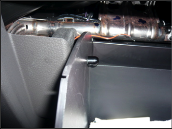

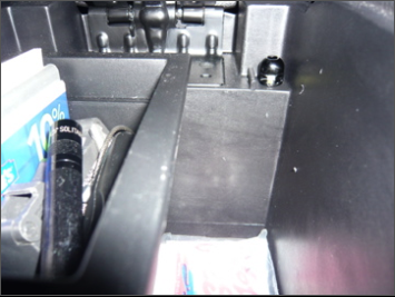

On this one, I mounted the LED light in the upper left corner aiming down. it moves in and out with the door open/close as it is mounted to door. I put the plunger switch on the opposite side (pass) and placed it right in line with the rubber foot so the rubber foot would reach the plunger and push it closed. as above, used dremmel to get perfect tight fit. I ran ground from switch to the frame rail you can see right inside the glove box where the glove box wire spool is attached that allows the box to open slow and smooth. as a matter of fact, perfect hole right there to bolt wire into to get ground. then ran ground out from switch to the LED and I tapped power into the cig lighter near the front cubby hole. to access it, I pulled the center NAV/climate control panel away and wired right into the cig lighter power wire.
Enjoy the photos....
post-2453-1232053757_thumb.png post-2453-1232053766_thumb.png post-2453-1232053772_thumb.png post-2453-1232053779_thumb.png
post-2453-1232053787_thumb.png post-2453-1232053793_thumb.png post-2453-1232053800_thumb.png post-2453-1232053807_thumb.png
post-2453-1232053813_thumb.png post-2453-1232053821_thumb.png post-2453-1232053827_thumb.png post-2453-1232053835_thumb.jpg post-2453-1232053843_thumb.jpg

If anyone is looking to do this exact modification, the lights that Lex used are in fact for motorcycles like Lex posted. More specifically they are license plate mounting bolts with the LED's built in. That should make it easier to find online. They are used to replace the ugly light and mounting brackets on motorcycles (especially sport bikes).
