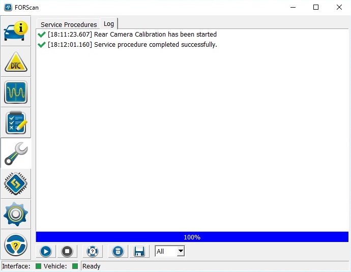

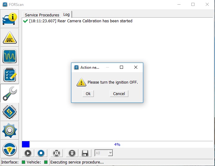

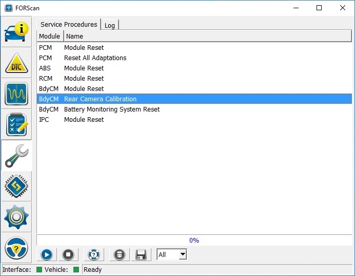

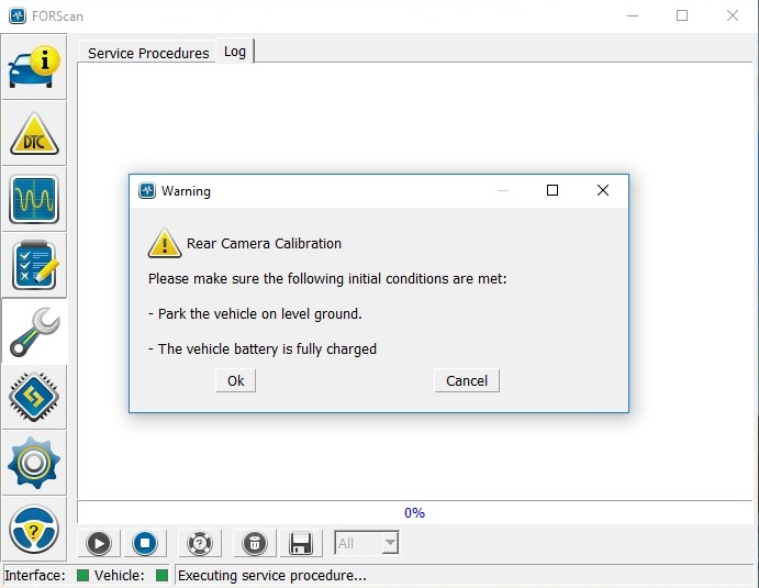

Wow these guys rule. Took me longer to get the screen caps of the process than to actually do it. Have the grid lines and colored blocks back overlaying the rear cam image. So nice to have this back, but even nicer that they went out of their way to do this. I highly recommend FORScan. Thanks again to omar302 for pointing me in the right direction. Attached are screen caps of the process, couldn't be easier.
