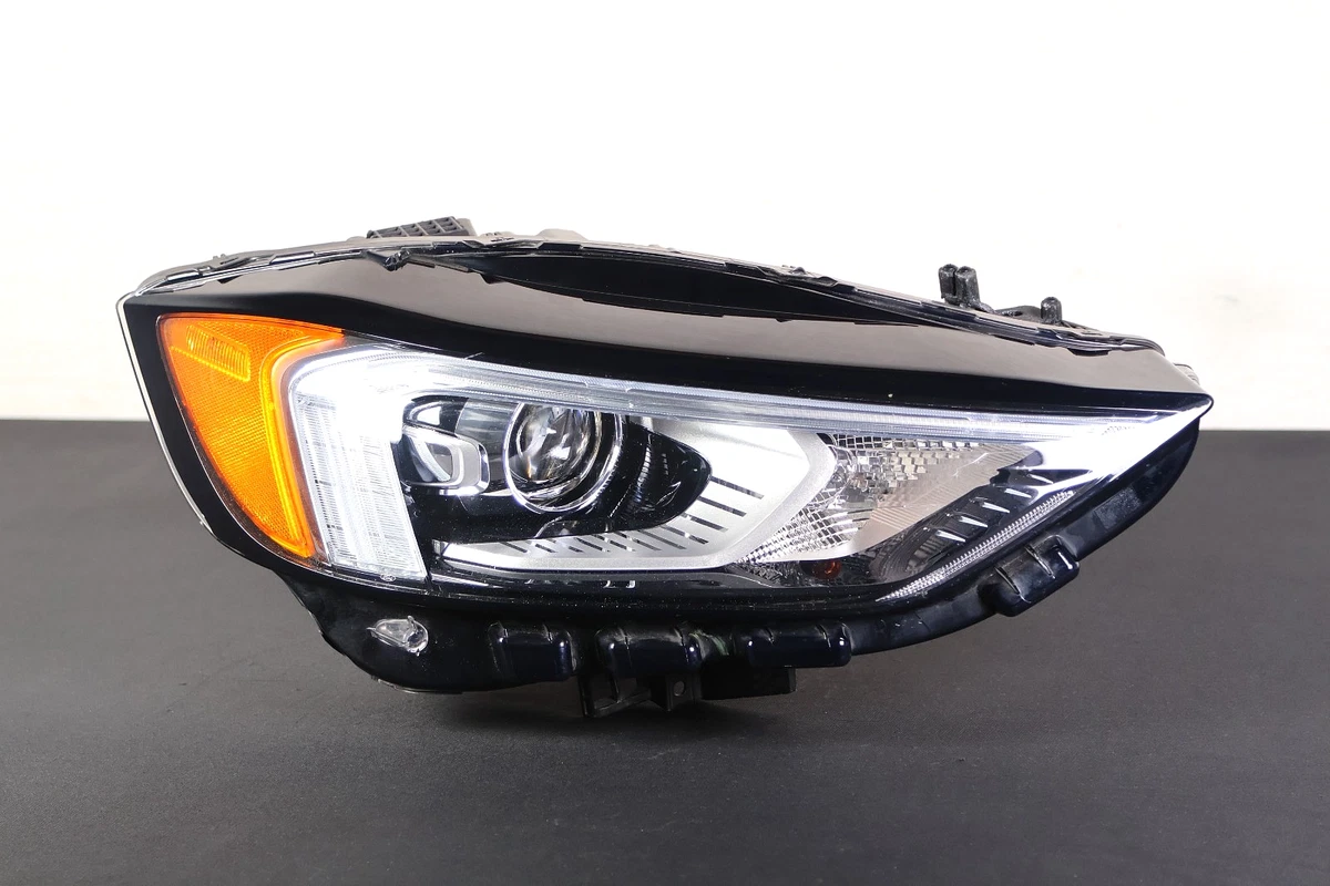

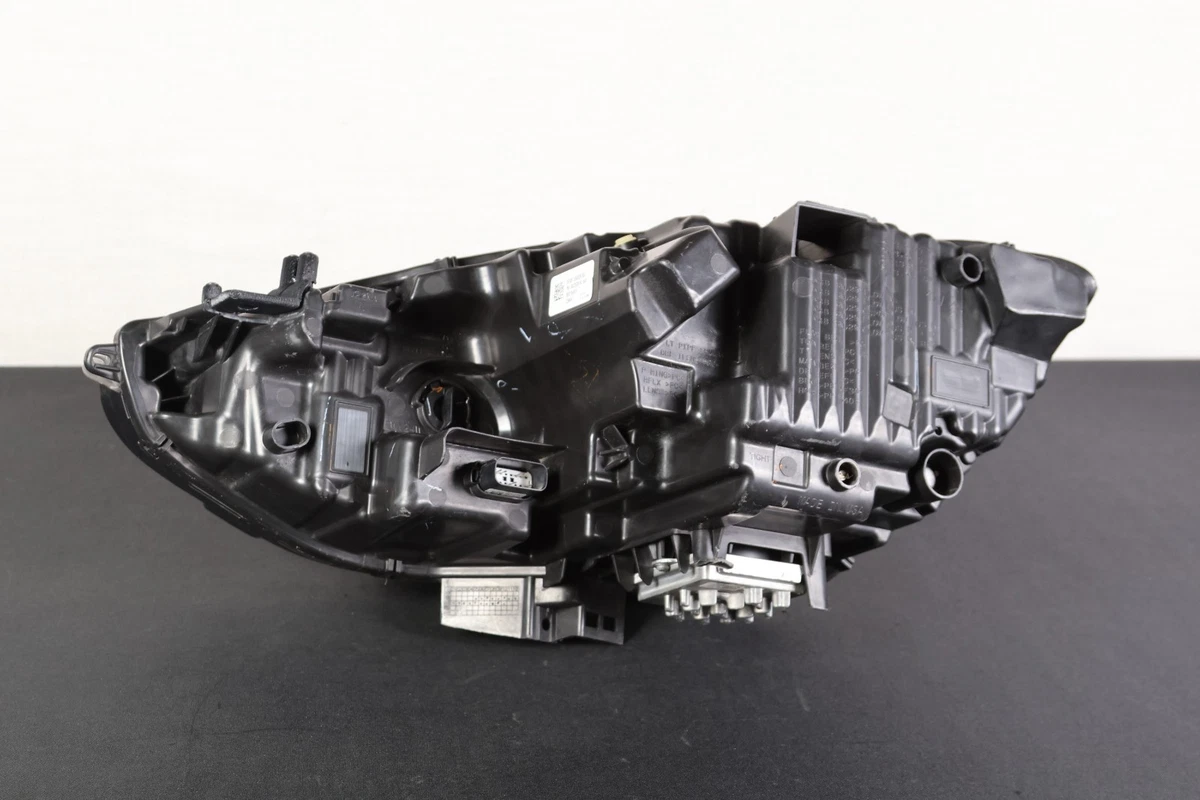

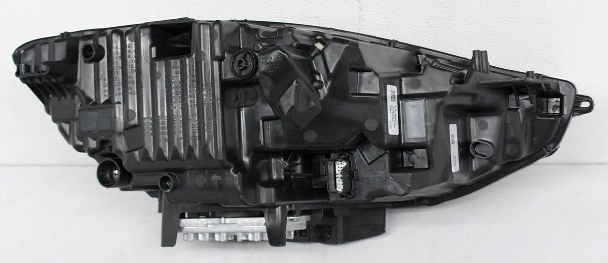

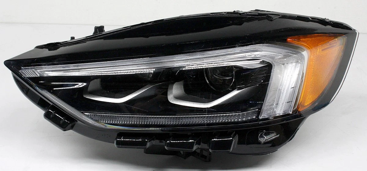

It is confusing, they are using the same photo and diagram for both types of headlights, but they are different and the higher level (more expensive, ~$1700 vs ~$800). You can see photo of used one on eBay like the below. The higher level does not have a socket for the turn signal. Higher level: Lower level:
That's exaggerated. The full headlamp (high level) can be found for around $1725. Yes, still expensive. Link to a sample. However, I am surprised that the turn signal is not working. These LEDs normally last for a very long time. LEDs are not usually replaceable separately and the high level headlamps also include adaptive headlights, so they are expected to expensive.
The guy would probably have been confused with the "upper level" headlights that come with the 401 package on the ST. They are dubbed as "Adaptive LED Headlamps with LED Amber Light Blade Turn Signals" in the order guide.
