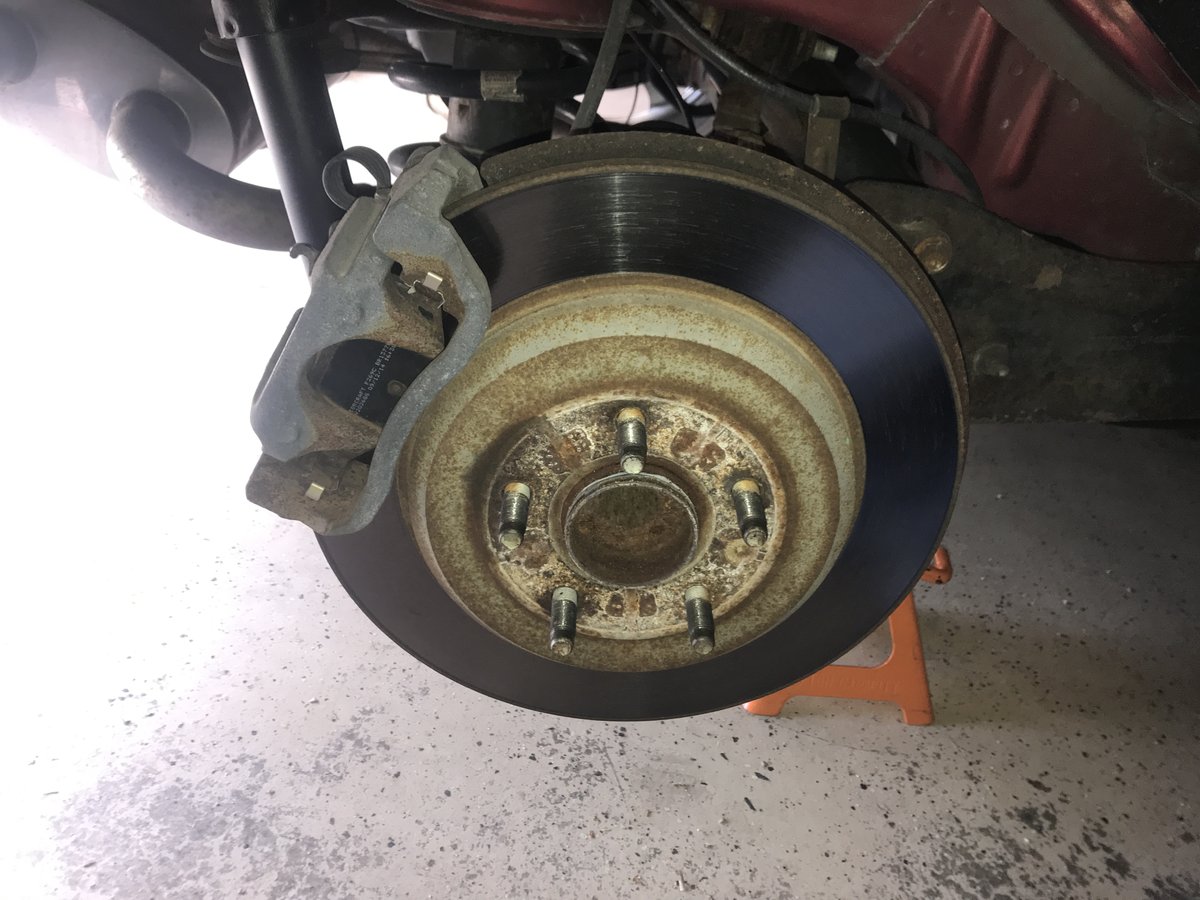

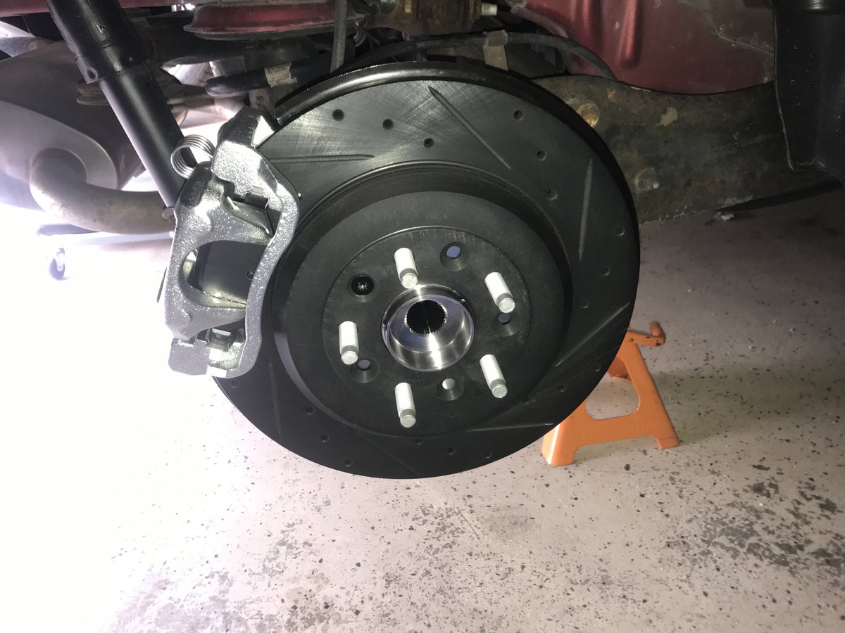

Finally got around to replacing all four rotors, pads, and calipers along with new rear wheel hub assemblies. While I was at it, I put on some new backing plates as well. Turned out really well and aesthetics are tremendously improved. I went with Hart rotors and ceramic pads, which I have used on numerous other vehicles with absolutely no issues. The calipers were Raybestos coated versions, which turned out to be rebuilt Motorcraft versions, so no complaint there. Everything turned out great and I have some other suspension items ready to go on soon as well, which might happen today.
