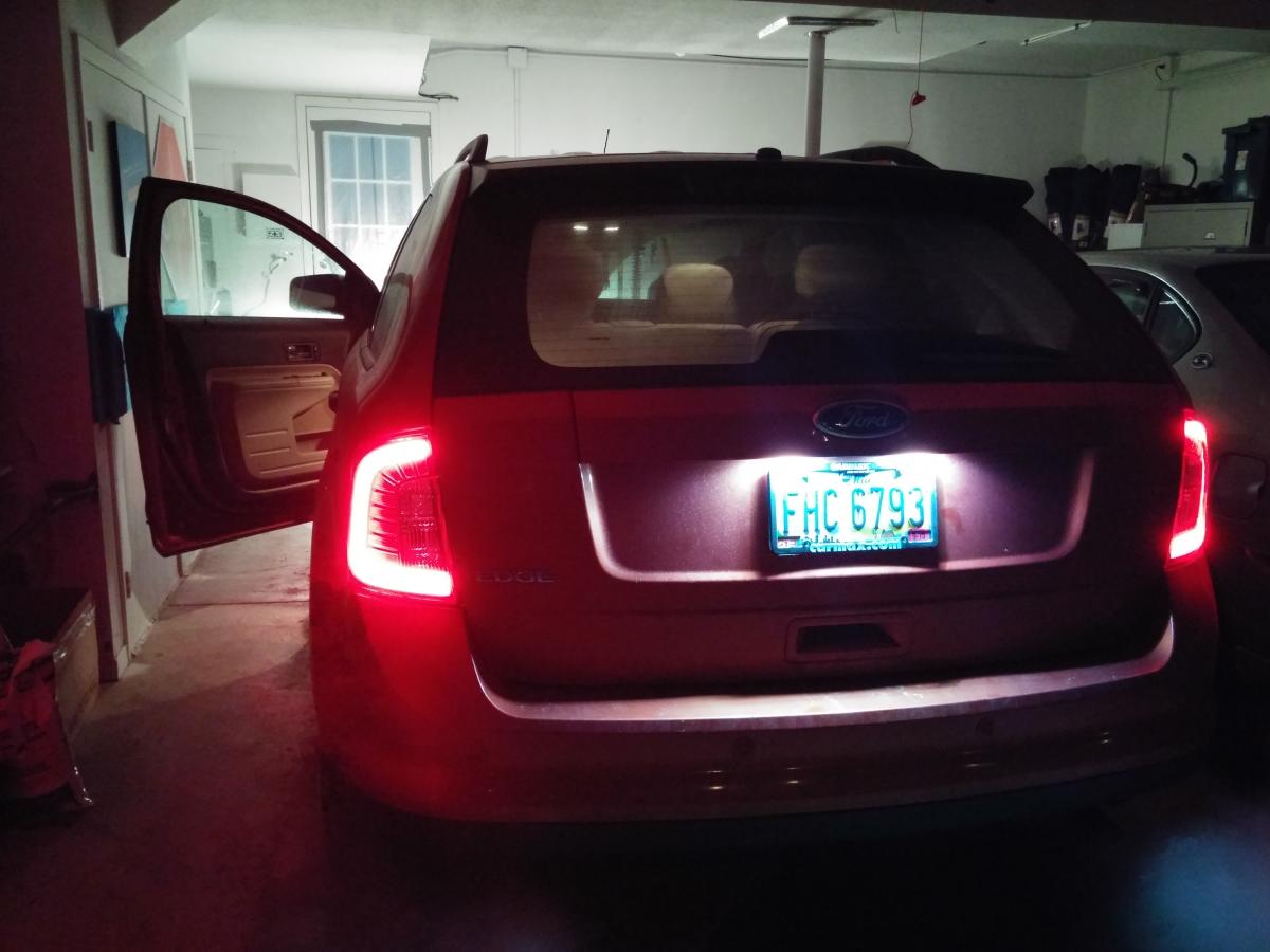

I received my set. Got them installed in the '08 pretty easily. They look amazing. I'll get pictures and video when I can.

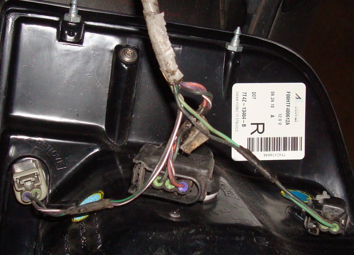

For those of you who got a set as part of the preorder the instructions differ for our vehicles.
The "six wire" that connects the entire tail light is actually only three, the "four wire" that you're supposed to leave unplugged is only two (also there is no space to put the empty socket back into the tail light so it's hanging free right now), the reverse bulb socket has only two wires but the size of the bulb is bigger for the reverse lamps (although that should be general knowledge).
You will definitely have to unhook the harness from the bulb socket for the brake light bulb wire connection (you'll know it when you see it) because the connector makes it so you can't insert the empty socket with the harness attached. It's pretty easy with a flat head screwdriver, though. Make sure when you're connecting the "six wire that's actually three" you follow the black wire to black wire concept, again, common knowledge.
Glad to see your new LED tails went in well and you are enjoying them. We have made a revised set of installation instructions specific to the new 07-10 Edge LED taillights. It is still totally plug and play, like the 11-14 taillights. No wire cutting, splicing or tapping and no need to wire in resistors.

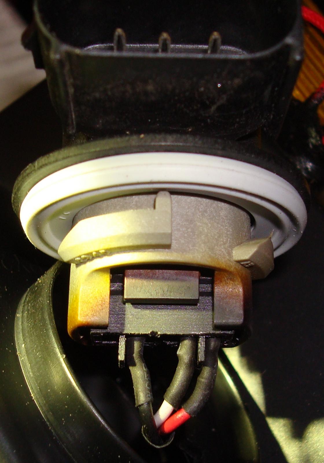

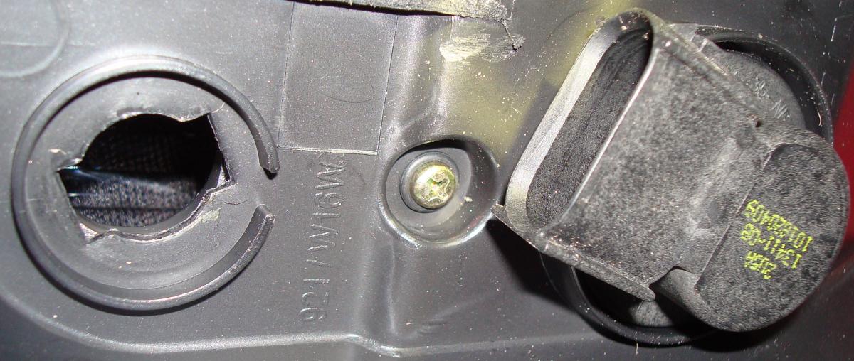

Installed the DTBL taillights on my '07 today. Definitely break the socket/wiring for the LED connection apart in 2 as instructed, Very difficult if not impossible to seat socket in taillight otherwise. Install the reverse bulb socket first, THEN the 3757 socket, at least for the RH taillight IME. Do wish I had a place to secure the unused socket, wrapped it around the remaining wiring to keep it from rolling around/rattling. I also did not like the styrofoam packaging, as there were bits of styrofoam everywhere that I had to vacuum up before installing.
A 5/16" socket is needed to remove the bolts that hold the taillights in place. I'd also tape up the frame around where the taillight seats to prevent paint damage as you remove/install these units. And yes, suffering from the infamous burnt 3757 socket syndrome :)
