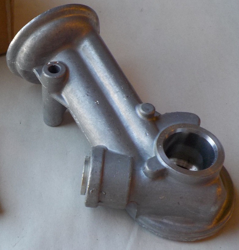

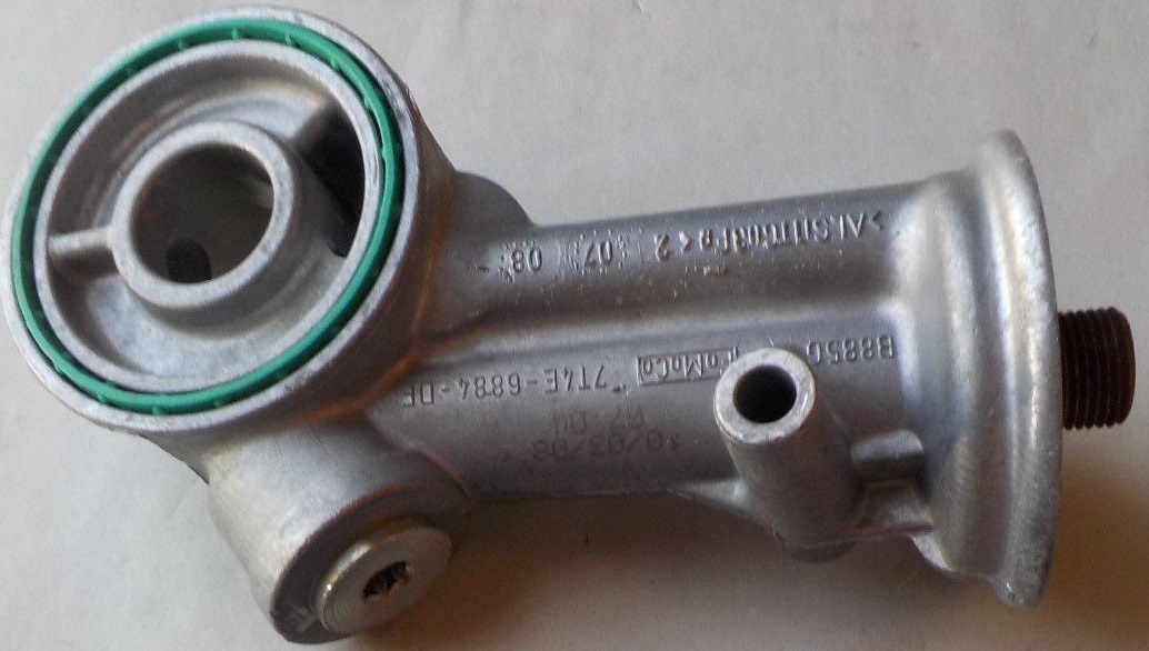

WWWPerfA_ZN0W Report post Posted February 24, 2017 (edited) I THINK there is an oil filter adapter, if so, this might be it (nontow, tow ends in F) http://www.ebay.com/itm/NEW-OEM-OIL-COOLER-FILTER-ADAPTER-FORD-LINCOLN-MERCURY-3-5L-3-7L-7T4Z-6881-E-/222257553685 No chance of a leak at the Engine Oil Pressure Switch? Edited February 24, 2017 by WWWPerfA_ZN0W 1 Share this post Link to post Share on other sites
macbwt Report post Posted February 25, 2017 Oil pressure switch leak(s) have been showing up on the older Edge's. Seems there is a new repair as the Edge ages. Pretty simple repair and from what I see not all that difficult to reach and replace. Plus it is near the oil filter area. 1 Share this post Link to post Share on other sites
