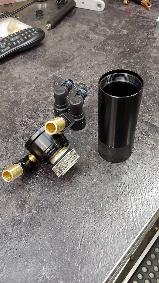

Here is a UPR 4 stage catch can like the plug and play version on my other car and soon to become a plug and play unit for my Nautilus once I get done making the mounting bracket.

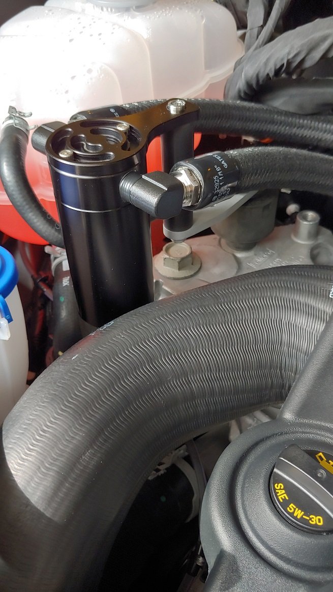

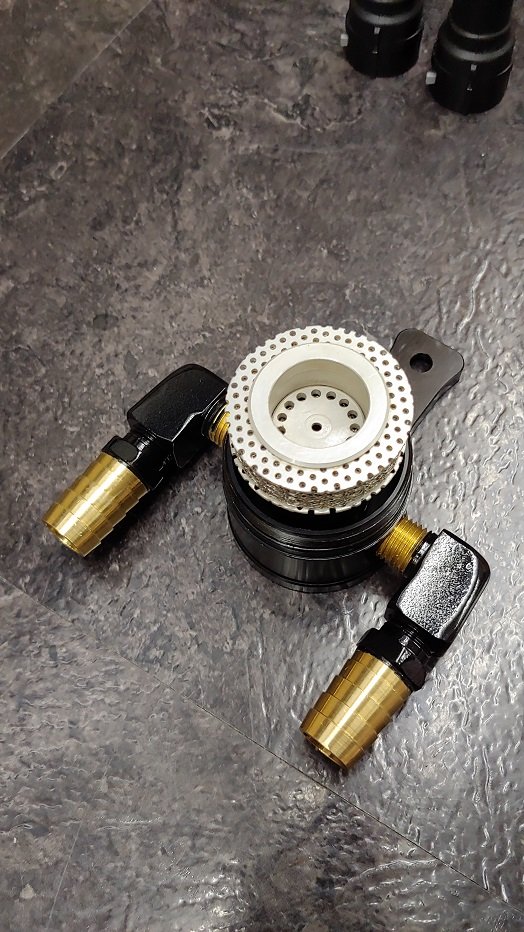

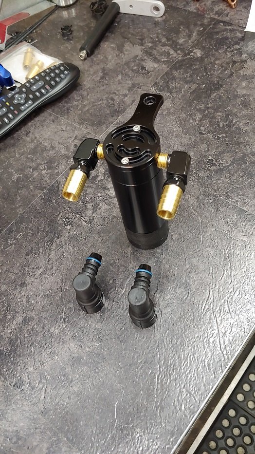

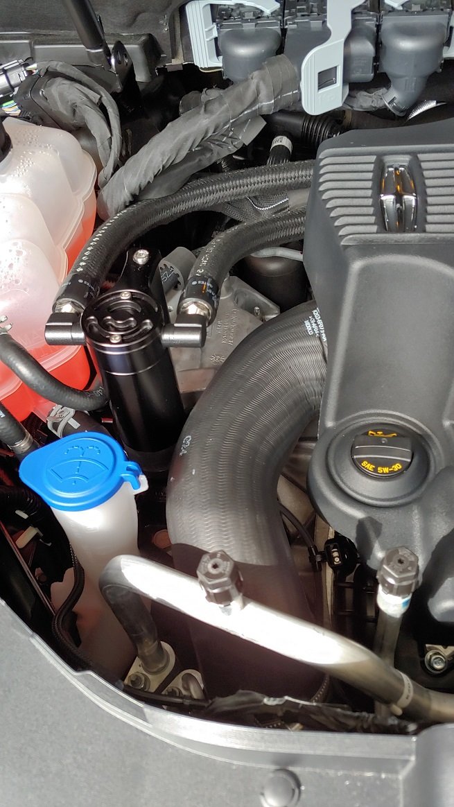

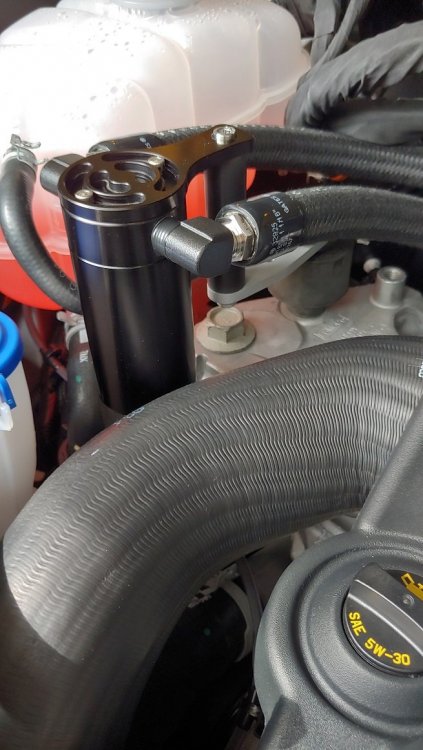

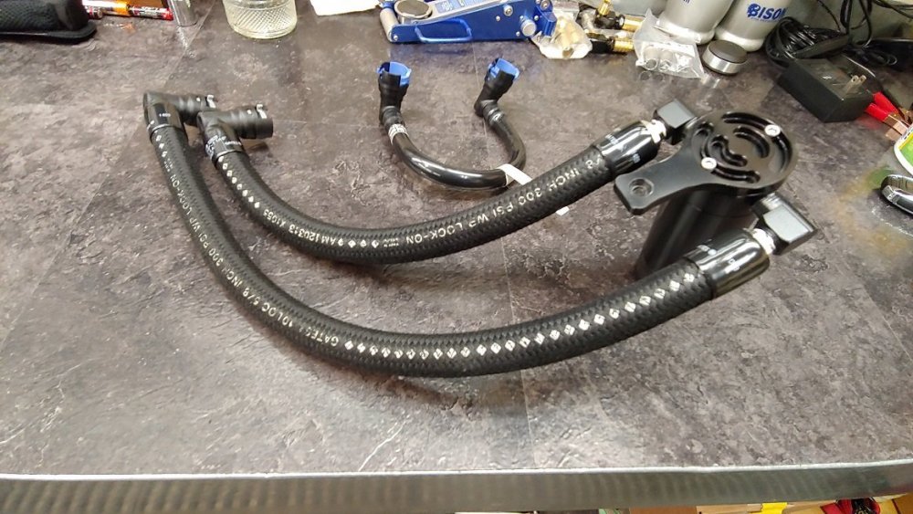

I finally got around to installing a spare UPR 4 stage catch can on my Nautilus.
The mounting bracket is made from 6061-T6 1/4'' plate and 3/4'' Delrin round stock.
Stainless steel 1/4'' NPT street elbows and 1/4'' NPT to 5/8" barbed fittings are used on the catch can.
The Ford 90* fittings are leftovers from a supercharger install.

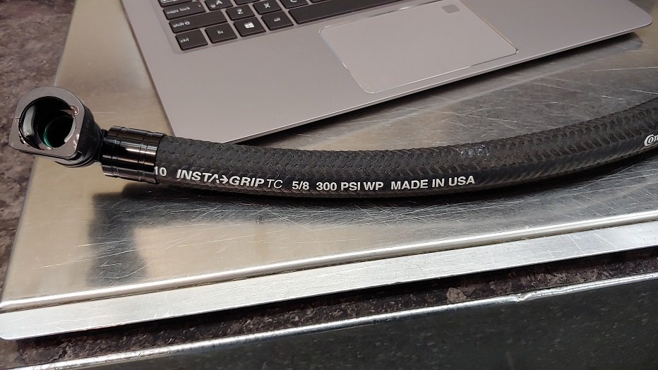

I went with grip lock fuel/oil hose, same as what UPR use for their plug & play systems.
I gave Gates shrink clamps a try for this project and highly recommend them. They give the hose assemblies a factory made look.
This can is  smaller in diameter and longer in length than a JLT can and that's why I located it where it is. An upside to that is unobstructed access to the oil filter. I'm into it for just under $ 40 not including the catch can cost.
Output side is nice and dry after 1,200 km.
