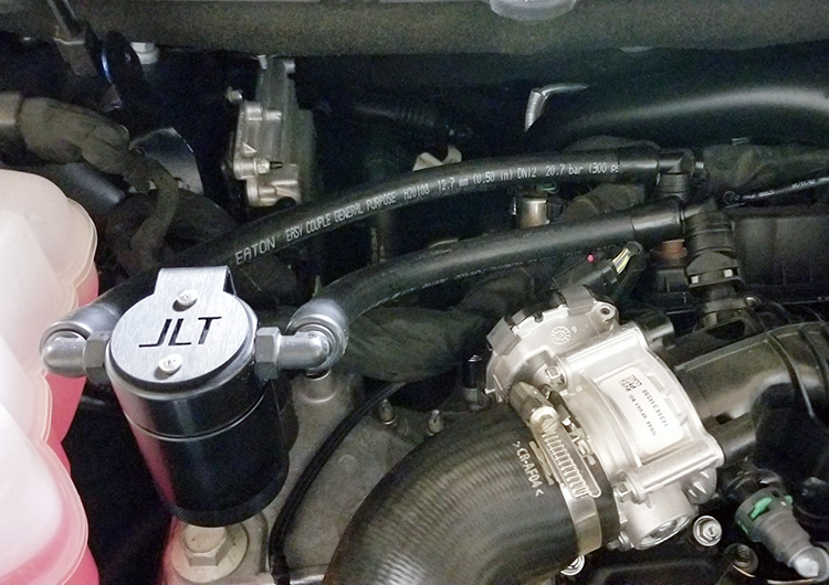

Hi to snmjim and to enigma-2. The can size that JLT now offers is the 3 oz as opposed to the older 1 oz they used to do. It is substantially larger even though it doesn't sound like much. I too was going to ask him about a CAI, however with me putting the vehicle away for quite awhile I just don't have the need at this time. Hell by the time I get back from traveling it may be time to trade in for a new Alfa Stelvio Quadrifoglio. I wanted one this time around however it wasn't available yet. If that happens I'll be posting my 2018 with less than 2000 miles on the clock. I'll keep everyone informed in the event that happens.
In answer to enigma-2's questions- the oil catch can is not a permanent or invasive addition to the engine, and in fact will not hamper in any way how the engine performs. It will not alter the ECU and will not throw any codes. Even if it were an issue it can be removed and the OEM hose installed in less than 20 minutes. I've had my Boss and GT350 at the dealership when both cans were installed and I never had any issues.
This is not however a California CARB approved device, so not sure how they would treat it. Either way it will not change any of the engine characteristics. It is just catching oil as it passes through it's normal route via the PCV system. Again I divert questions to the main man Vinny.

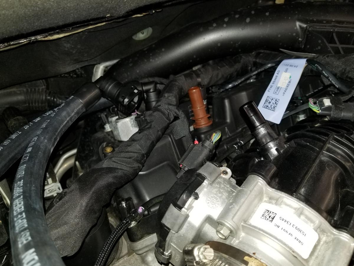

I hope the images I uploaded earlier allowed everyone to see just how simple this is to install. Good luck to all and enjoy.

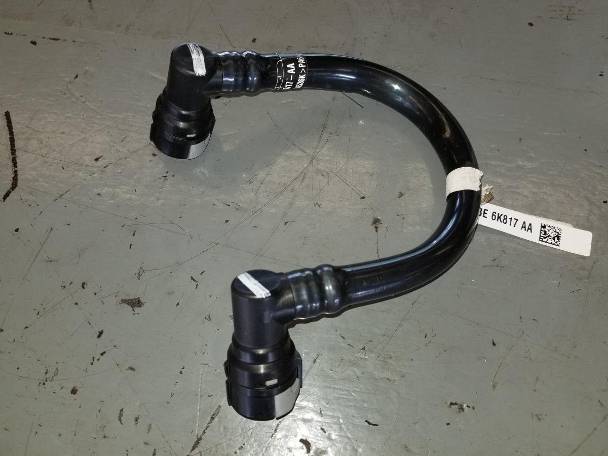

Other issues for the 2015+ trucks is they have a crankcase pressure sensor in this line, changing the volume of air in this line (such as adding a catch can) can put this sensor out of range and cause a Check engine light.

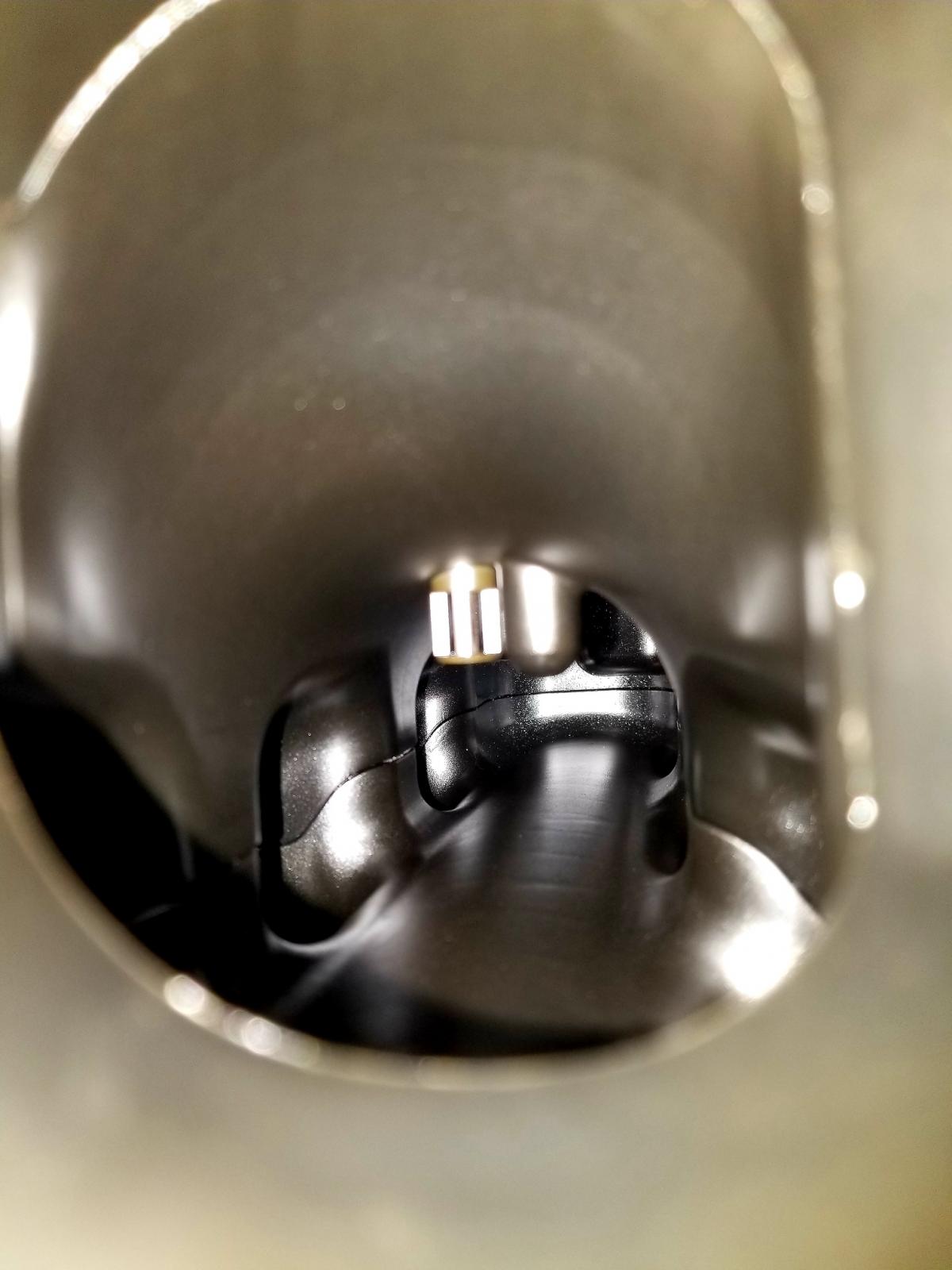

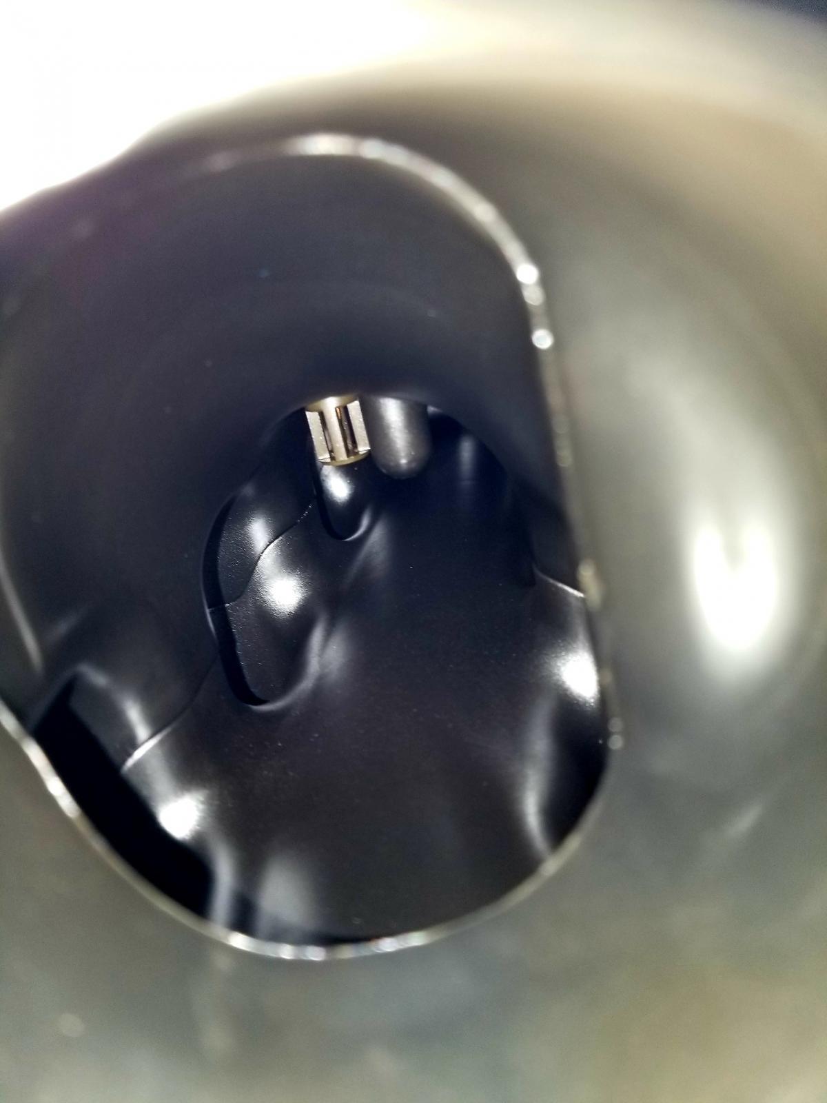

I'd also recommend that once you install whichever catch can U choose U should also consider having your intake manifold pulled 2 have your intake ports & valves blast cleaned due 2 the lack of having a catch can, not a hard job but well worth it now that U have significantly mitigated the cause.
Ref the clear before & after Pics of an S4 Audi direct injected Supercharged V6 at 50k-60k miles.
There has been deliberation that since the clear Pics are not of a 2015-2018 Edge Sport they do not substantiate the point however they do but just to put the disbelievers to rest we pulled the throttle body off our 2016 Edge Sport with 56k miles and took Pics of the intake, ports and valves using a bore scope.
We mostly use 93 octane, drive suburbs but mostly highway, aggressive driver, change oil 3500 mi and live in MD.
You can now make your own decision based on facts... :hat_tip:
Note: you will have to be familiar with looking at scope Pics to see what your looking for so we adjusted the Pics the best we could to help those out who aren't familiar with this type of Pic:

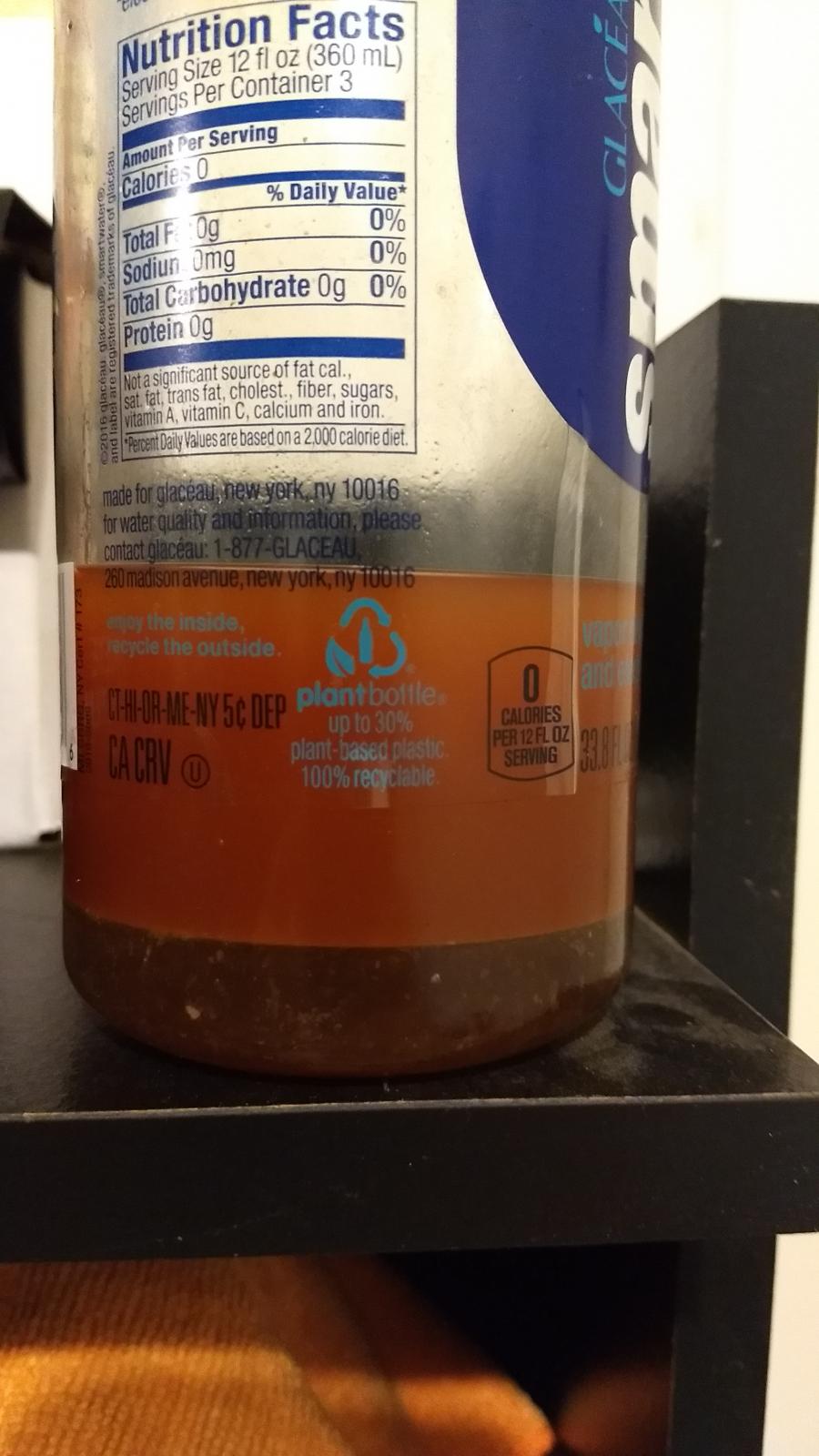

Fyi, this was my Team RXP catch can on my 2.0 Ecoboost with just around 2,000 miles on it after an oil changed, in January/February with temps at or below freezing. I had nearly the same amount after another 2,000ish miles. Basically had to drain the catch can twice within 4,000ish miles with nearly identical results.

I saw Lildisco's post about his 2.0 Ecoboost and yes that looks different from anything I have even gotten out of a catch can on any vehicle. He is in a colder climate and even though I have been in temps of around the 20's where I live, I have never had anything like this. There could be many reasons for that, and I would ask Vinny about that because he is even more knowledgeable than myself in this area.
He did say that because the RXP catch can is so remotely isolated from the PCV system the differences in temperature can cause exactly what you are seeing here. With the JLT can being so close I have never seen anything like this. Temperatures from the engine to the can are very close so this is not a normal issue. Again speak with the Vinny guy.

The install was easy, quick and clean.
Basically, remove an easily accessible hose, add a bracket to an existing bolt and route two short hoses to the same points you removed the one hose from.

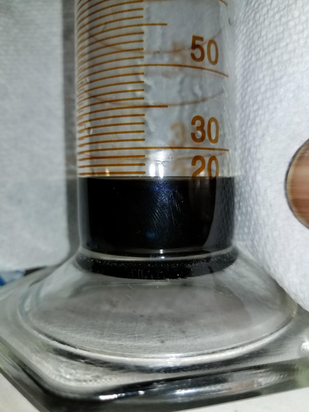

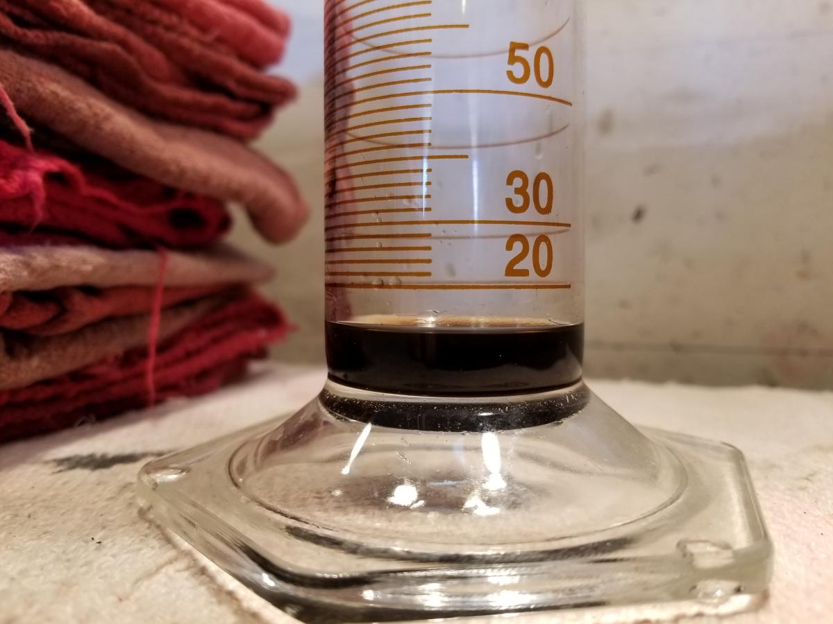

Data points completed:
Installed at 54k miles
- 1200-1500 mi (Ref Pic)
- 2000-2500 mi (Ref Pic)
- 3500-4000 (Ref Pics)
Notes:
2500 mi check performed - 23 July 2018
Vehicle miles - 57625
Avg Temp for past 30 days - 85-95 degrees with 80% humidity
Driving Conditions - 75% Hwy / 25% Suburbs
3500 mi check performed - 07 Dec 2018
Vehicle miles - 63,874
Avg Temp for past 30 days - 35-45 degrees with 65% humidity
Note: higher Qty & lighter color as weather gets colder...quiz time: why?...Clue: its normal...?
Last & final measurement performed - 3500 miles
