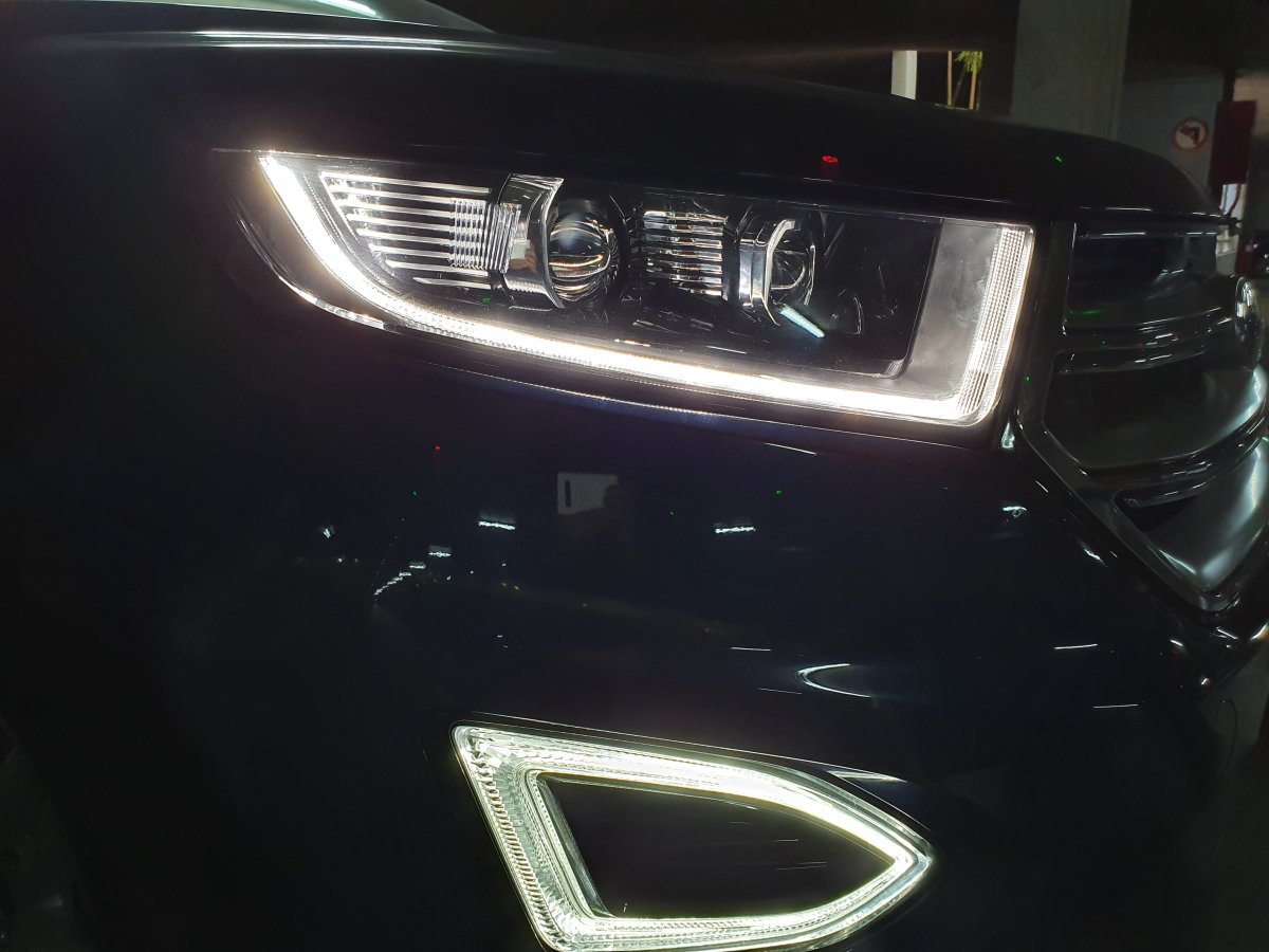

Thank you Omar. Finally I set off the parking lights. Tha result was to DRL led strip at night too. Pretty good I believe. Here a pic of the results in night conditions. Thank again for your help and to all the members.
