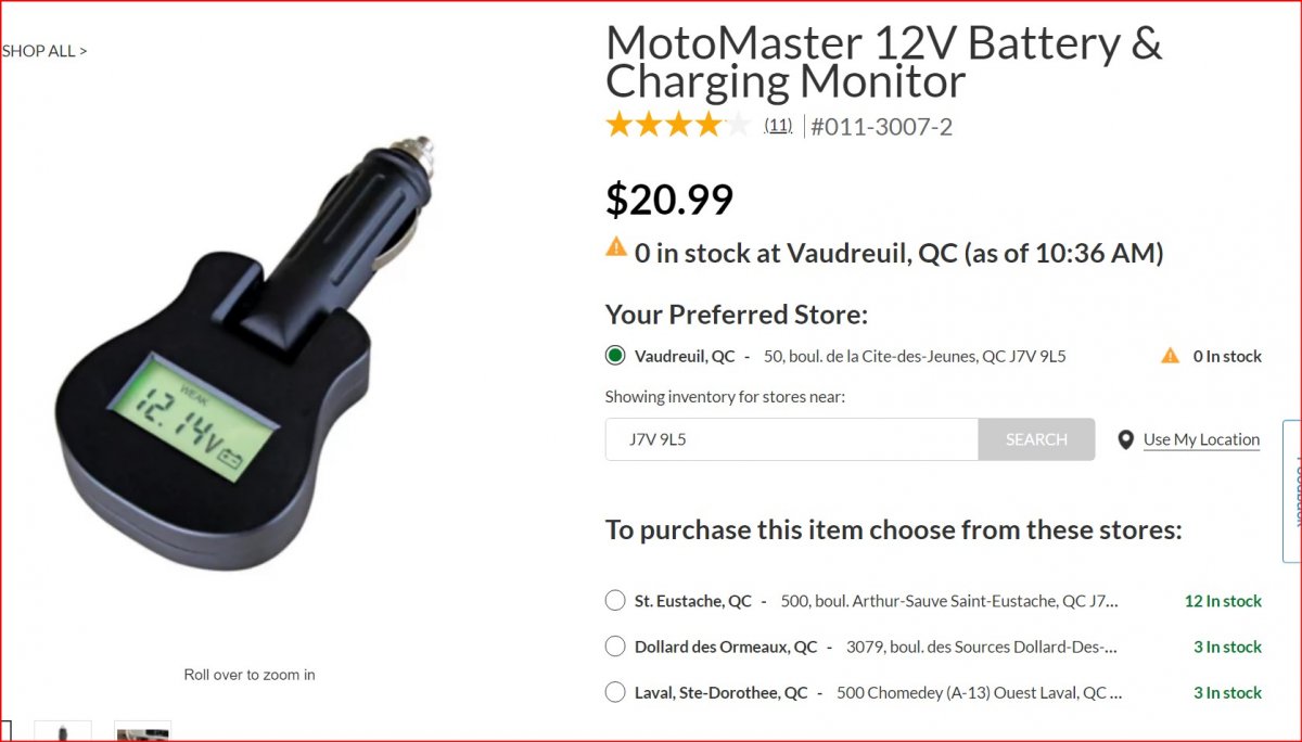

oskar27 Report post Posted January 5 Thanks for the education enigma-2, good to know. Regarding the car cleaning I’m retired now and have lots of free time for my hobbies and one is keeping my car clean. When I was working my car didn’t get too much attention…. Got another gismo today to check my battery because I dint like the 50% my charger was showing. Tomorrow I will use it and I will post the results. Share this post Link to post Share on other sites
oskar27 Report post Posted January 6 The new gismo looks like a pretty good one, just plug it to a cigarettes lighter socket and with the engine OFF it tells you a volts range for good, weak or bad battery and with the engine ON it tells you the volts the alternator pumps out and it tells you good, weak, overcharging, undercharging. Mine got it all just right. Share this post Link to post Share on other sites
